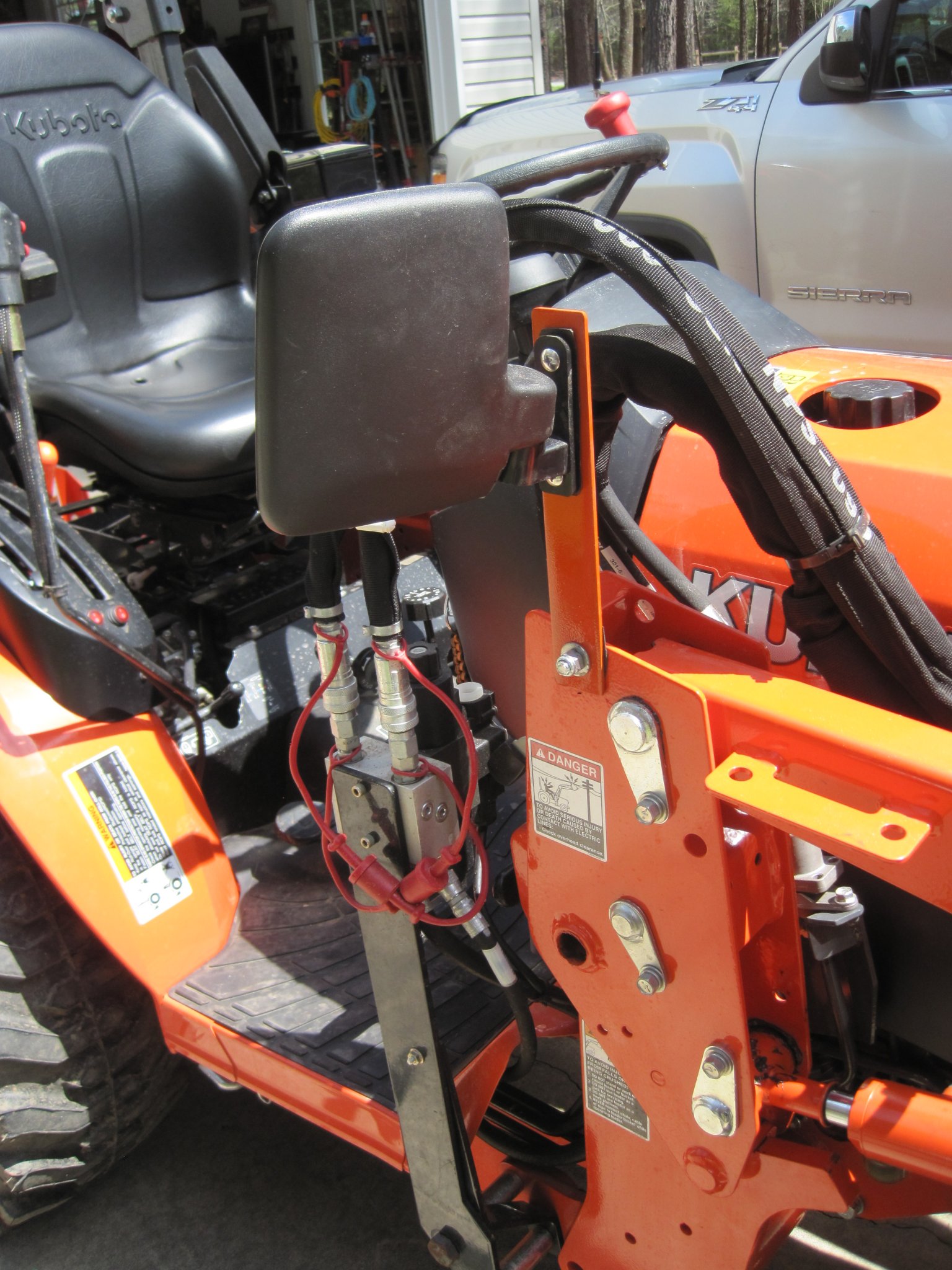

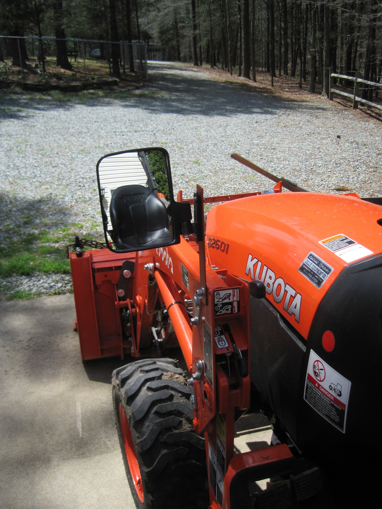

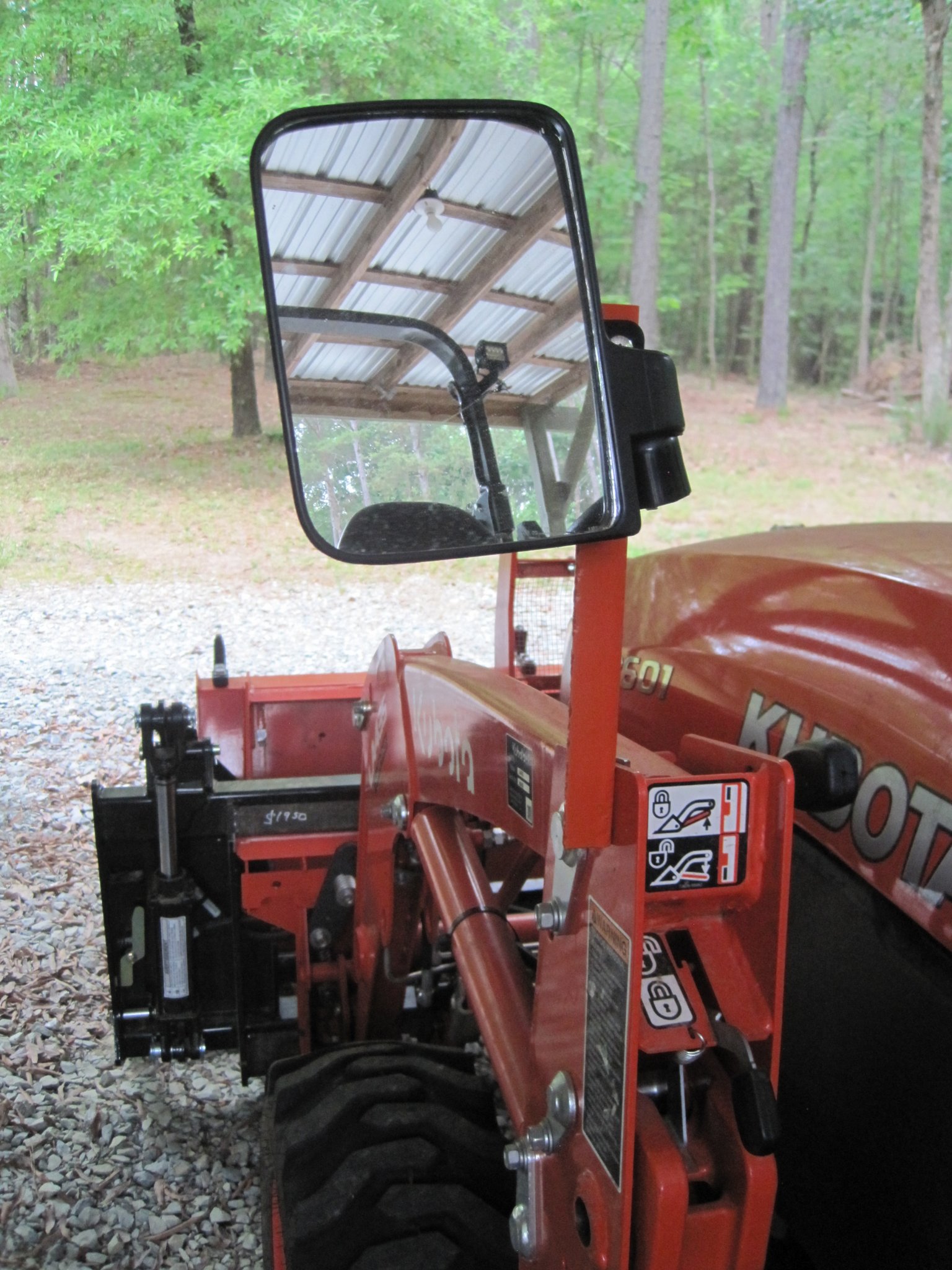

I got real tired of trying to turn around in my seat to see if anyone was trying to pass me on my road as I was traveling back and forth to my neighbor’s house half mile up the road as well as working around the trees on my land, so I decided I needed to install mirrors on my B2601.
It was a great little project, and fun to do.
I bought two Golf Cart side mount mirrors from Amazon for just under $12. Flat stock stock 1/16 X 1 1/2 x 36” long from Lowes for under $8. The Kubota Orange paint and a couple 3/8” bolts with fender washers drilled out to 3/8” and Nyloc nuts and an old truck inner tube was on hand.
Mocked up the mirrors on tractor with the flat stock and a couple vise grips to see what I needed to do, and what size to cut. I used the existing holes on the towers so no drilling was done on tractor at all.
I marked and cut the flat stock at 9 1/2” each, and drilled the appropriate mounting holes. Traced and cut out the inner tube pieces to go between the mirror mounts and flat stock to minimize vibration. I installed inner tube between the flat stock and towers on tractor to keep the flat stock in place when I tightened everything down and to minimize vibration there as well.
Everything worked well so I took it all apart and sanded the flat stock, washed with mineral spirits and primed and painted with the Kubota paint. Let it all dry over night and mounted everything once again for the final install.
Project was easy and very inexpensive. Mirrors are adjustable in and out as well as up and down. I kept the mirrors in tight and inside the line of front to back tires in case I was to rub a tree on my property I would not rip off the mirrors. I can fold the mirrors all the way in if needed as well. I now have full view of the rear while sitting in my seat!
I have a bunch of before and after pics of what I did and used, but did not think you wanted to be bored with it all so here are the final pics of completion.

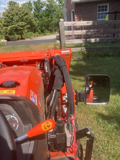

Nice Job! Mirrors are handy to have. On a different forum, I learned that Jeep Wrangler mirrors also work well (they have a flat mounting surface), and are pretty cheap on Ebay. I bolted a board on my loader tower and used threaded inserts in that to mount the Wrangler mirror. It works great,

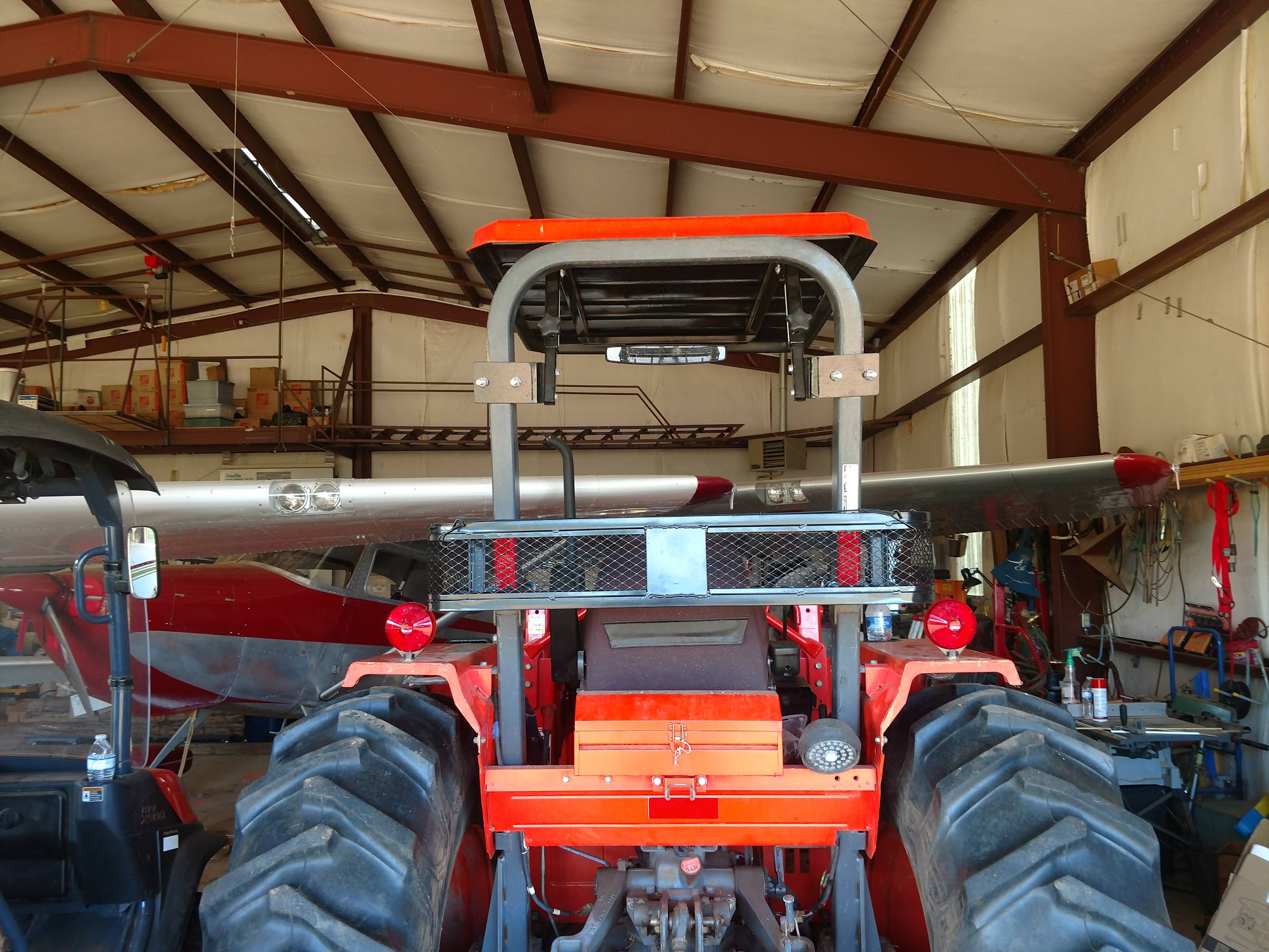

This is a curved (wide-angle) rearview Golf-Cart mirror I found on Amazon for about $20. Works great and sits beneath the canopy so doesn’t get hit by bushes. (Look under the canopy/Zoom - in)

This is a curved (wide-angle) rearview Golf-Cart mirror.... (Look under the canopy/Zoom - in)
Was having a really hard time finding that cool mirror... kept being distracted by the fact that you have TWO airplanes in your barn!! :geek:
5,686
3,012
I tried zooming/cropping that pic but the forum software then claimed the file was too large to upload.
The red one is my ‘53 Cessna 170B I’ve had for over 20 years since it won the Restoration award at Oshkosh. I’m retired from instructing professionally but the other is a ‘62 Cessna 172C bought for the purpose of teaching my adult son toward his private pilots license. (He’s an engineer and tired of dealing with the airlines for short meeting-trips. I wasn’t about to let the 170 be abused as a primary trainer.). He just passed his written exam and completed his solo-cross-country training.... we’ll be getting him ready for his check ride/practical exam now. The plan is to let him get a little time in it and then likely sell the 172 (make him pay for his own ride.) :LOL:
Seriously, it’s possible to buy a good-condition 172 to train in until obtaining the license, then selling it, usually for more than one paid for it.... than it is to rent one for the same purpose. He has to pay for the fuel and insurance and I’m donating my instructor services is the deal I offered him.... and I’ll get my money back on the 172 (and probably more) when finished with his training.
Here’s a pic of it on a trip to visit friends who live in a fly-in community down in the Houston area.

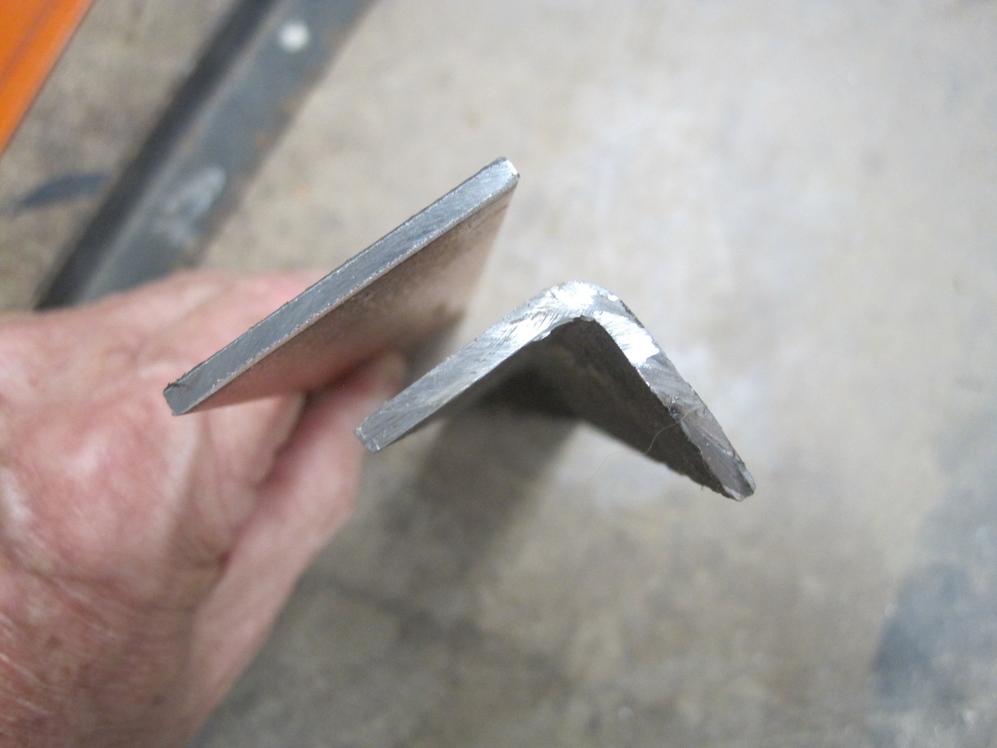

Frank, this is so helpful. I'd LOVE mirrors on my new B2601 and am not very handy. I think I could do this, however. But is there any chance you have the link for the exact mirrors you bought?
$12.99.

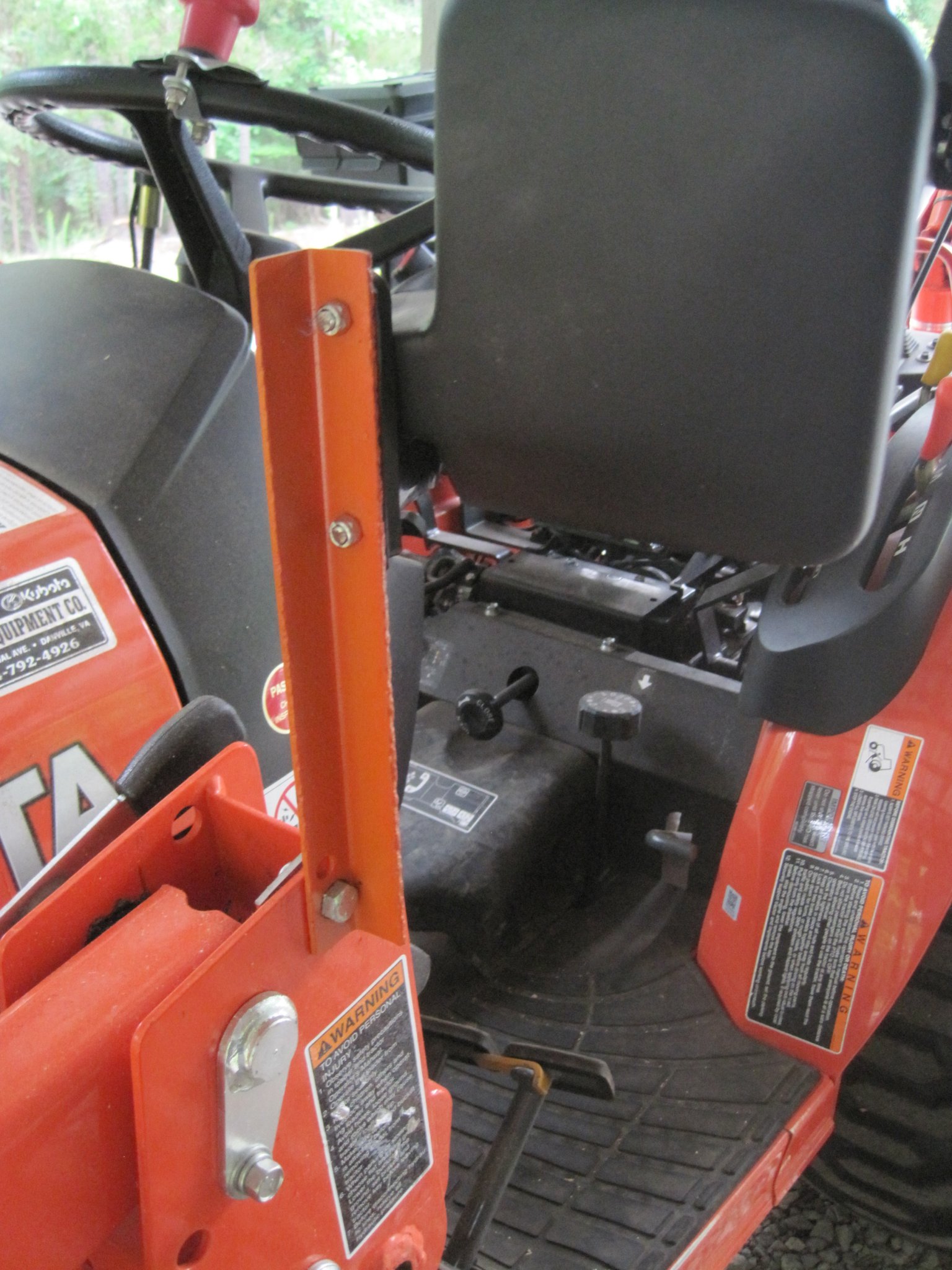

So far they are holding up very well. I did change one thing since making the mounts. I had a couple pieces of bed angle iron laying around so I drilled and mounted them to replace the flat stock. I think this set up eliminated any vibration from operating in the woods.
The angle is 1"X1". The angle does give it a lot more stability. Something to think about if you have the angle.

Thanks so much, Frank! So those are some stout pieces of steel if they are 1" thick! Do you think doubling or quadrupling the regular flat stock would achieve the same effect?
No, not one inch thick. They are 1" X1" wide. Bed rails are I think 1/8" thick.
I just found that the angle stiffens it up quite a bit. The flat stock worked very well also. I was happy with both mounts.

Thanks again, Frank. I can't picture this angle iron mount though! If and when you get a chance, please post another picture!?
I thought I took a couple more pics of the new mounts, but can't seem to find them. I will try to remember to take a couple tomorrow and post for you.

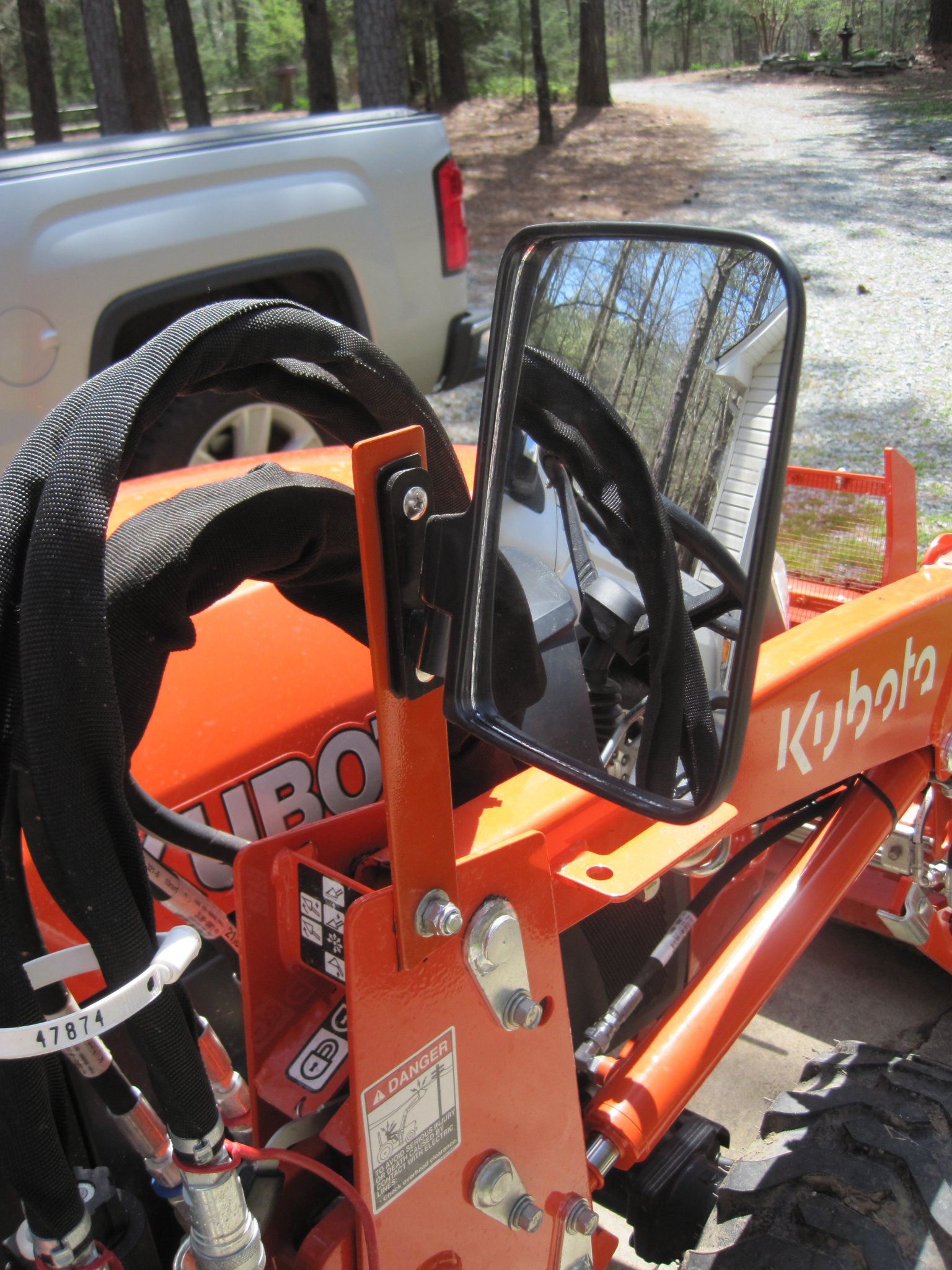

OK, got some pics this morning for you Dell.
I show the pics on tractor how the new angle iron looks.
I also show some pics on the bench of the flat stock on left and the angle on right. I think the flat stock is 1 1/2" wide and angle is 1X1 wide. I believe I made the angle iron 9 1/2" long, but you need to decide how high or low you want your mirrors to sit while you are on tractor.
I am 5' 11" and felt after clamping the angle to the FEL tower at various heights I found the total length to be 9.5" best for me. I tried using washers on the inside of the tower but found they collapse inward to the hole when I tried to tighten the bolt so I took a small square of the flat bar and made my own thick washer that would not bend.
Hope this helps. Let me know if you need any more info. Glad to help in any way I can.

Very cool, Frank! It is clear. I can see where the angle iron would be stronger. Glad that helps with the vibration. I wonder if a strip of adhesive rubber would help too. In any case, this is a great blueprint. It seems there is a market for a mirror kit, but I bet the issue is that there are so many models of tractors and loaders, and they are constantly changing.
I tried using a cut of truck inner tube between the bar and tower. Did not like that so removed it. I did keep the piece of inner tube between the mirror mount and angle iron because there are two bolts holding and not one like in the tower's existing hole. I did use nylock nuts so nothing would vibrate loose between angle and tower. So far, so good.
