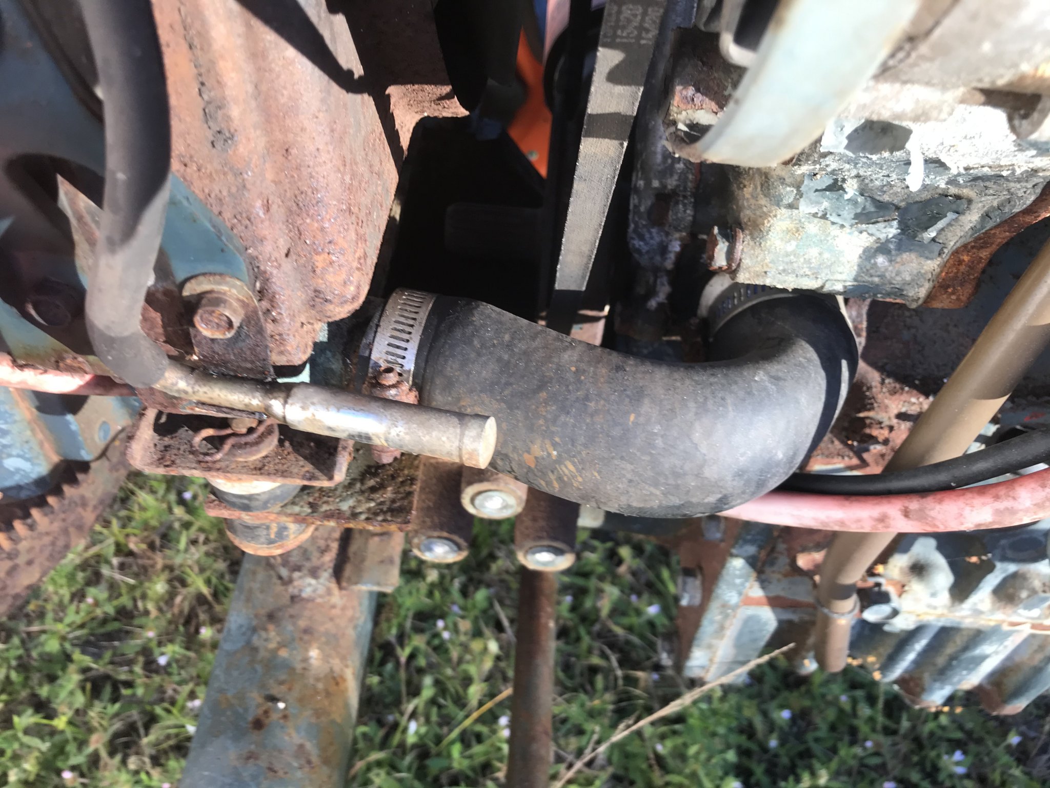

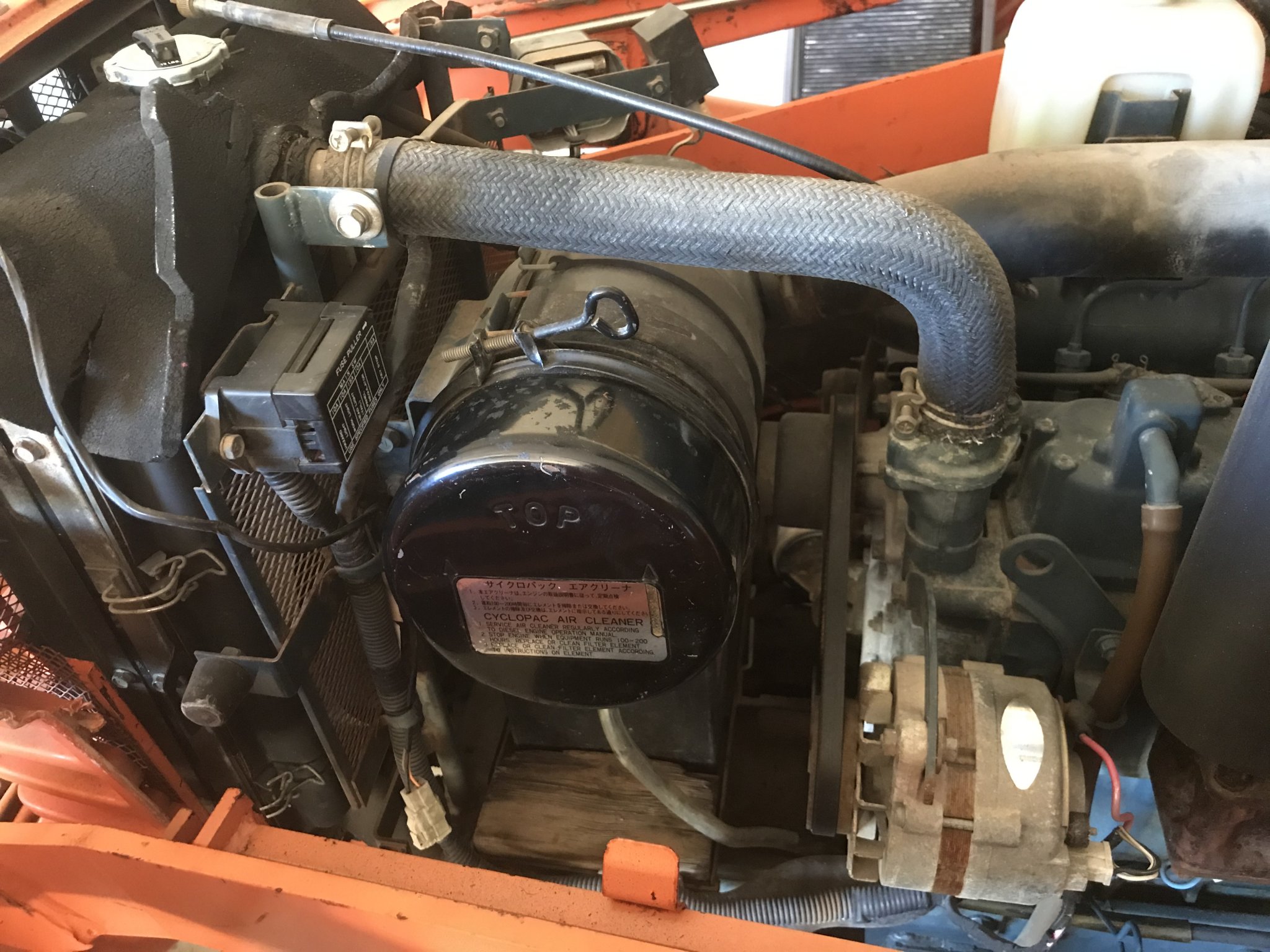

Inline Temp gauge in top by t-stat or in the lower hose?

temp could be easily installed in lower rad hose, seems to be a T there ?

I've heard some say the top radiator hose is a better location near the t stat for an inline sensor although the lower radiator does have a drain line (T) fitting in the L2850 so it could be convenient.

hmm, any chance there's a 'port' on the head for a temp sensor ?

On some of the older tractors there is a plug in the head for a temp sensor. It's located to the back of the engine (near the firewall) on the passenger side.

There will be ports in both heads to do temp sensor...
You can NOT put a temp sensor in the lower radiator hose as that would measure water coming out of the radiator and not the engine temp.
