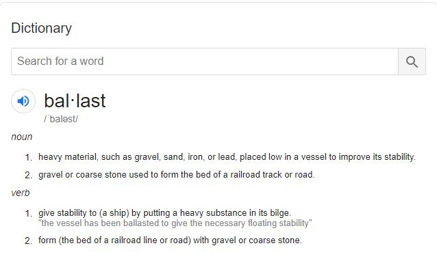

Geo, the 3-pt ballast takes stress off of the front axle when using a loader. That is the main purpose of a ballast. It can also lower the center of gravity that may be useful in some hillside applications.
I always thought 'ballast' was the gravel under the railroad ties on a train track.....:eek:
