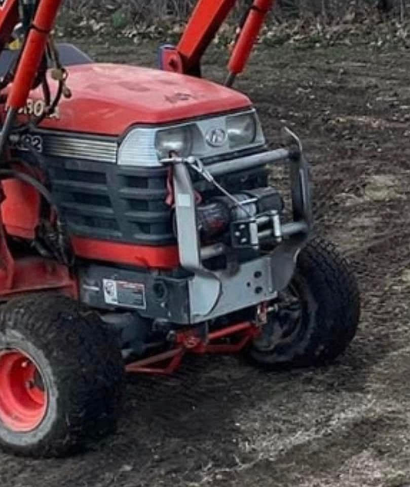

This is the rig I have on my BX. 175 Amp Andersons and #4 Fine copper welders cable.

That looks great!

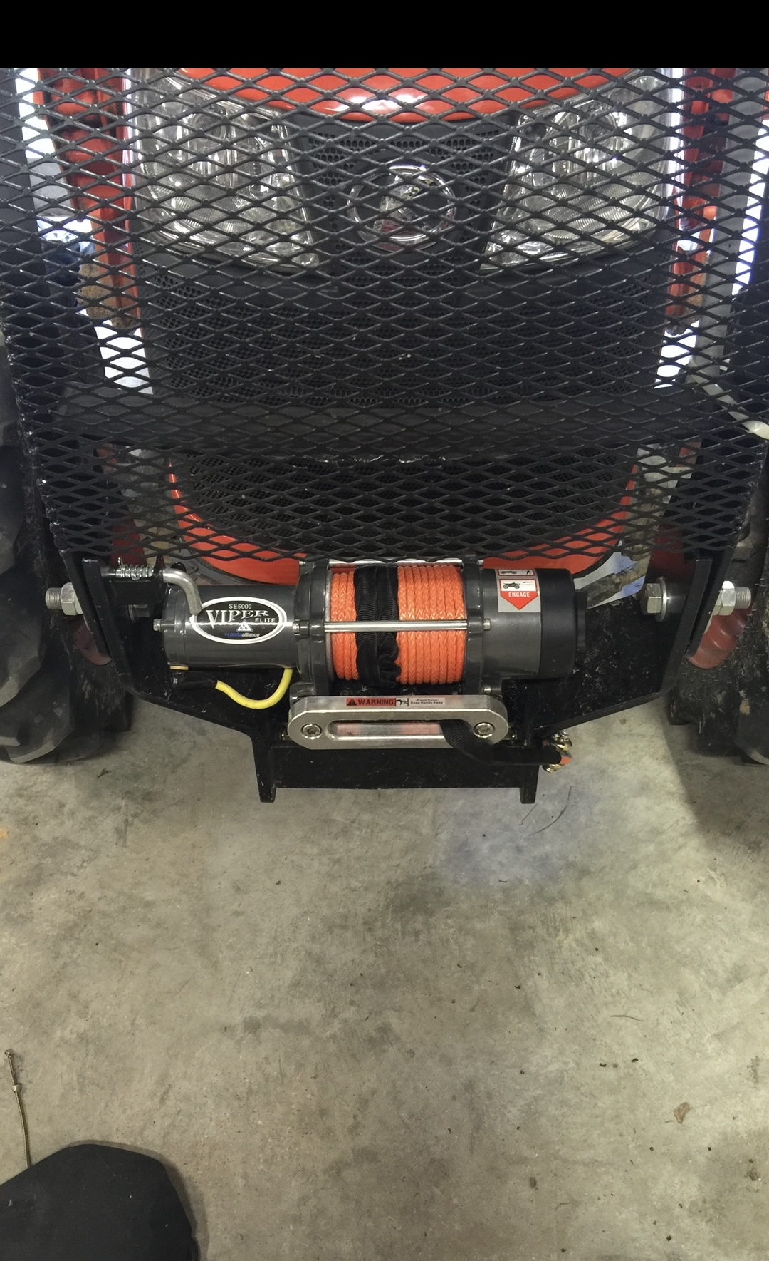

I’ve posted this picture before of mine. It has 65ft of rope. If you need more length use winch rope extensions.
You don’t want to make a full length pull with any electric winch. Refer to the manual on the duty cycle, based on load and time.
Depending if you have a FEL for clearance reasons, use a full size 8k-12k electric winch. Or setup a hydraulic winch.

Thanks! I think I have just decided to go ahead with a 3500# winch with 50 feet of rope. That will hopefully get me close enough with maybe an extension occasionally...
