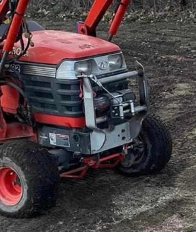

I have a winch on my little BX. Keep the engine running. Do not use the winch to pull a giant log 100', just enough to free it and then slowly move the tractor pull the log some, then back up, run the winch to pull the cable back in and repeat. I did this for an entire day. Not a problem. Amperage load is directly related to how much heavy pulling you are doing. The tractor is much more capable most of the time.

Anyway, with all due respect: I think a 4 or 5,000 lb winch on a L2502 will be a better option than a huge 9,000 lb winch. Think about an ATV or side by side winch at about 4 to 5,000 lb capacity. Because, you don't want to risk twisting the frame of your tractor, and a smaller winch draws a lot less power from your battery. A 9.,000 lb winch will pull your tractor towards the logs before you realize that the log is just too big.

I’ve had a Viper brand 5,000lb Atv/utv winch on my L3800 for almost 10 years now. It was the largest at the time that would fit between the loader and opening the hood. It’s a “wide” model holding more cable/rope than the standard version. It’s mounted in the grill guard.
