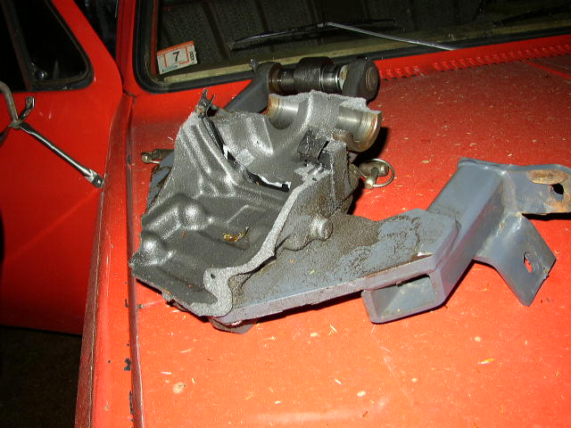

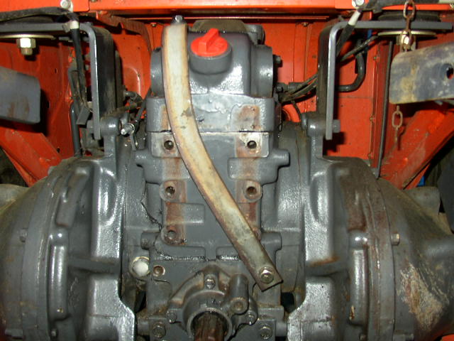

Here some pics of the broken L4610 posted on TBN back in 2004:
Brittle fracture of cast iron fits right back in place. We took out the rockshaft and sealed the rest of it up so the tractor was usable that way until the fix could be scheduled.
