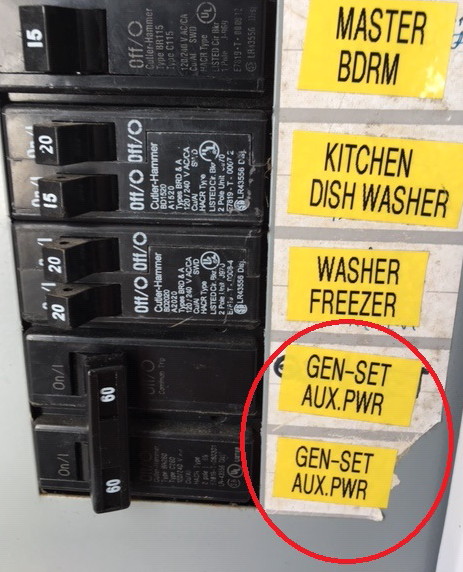

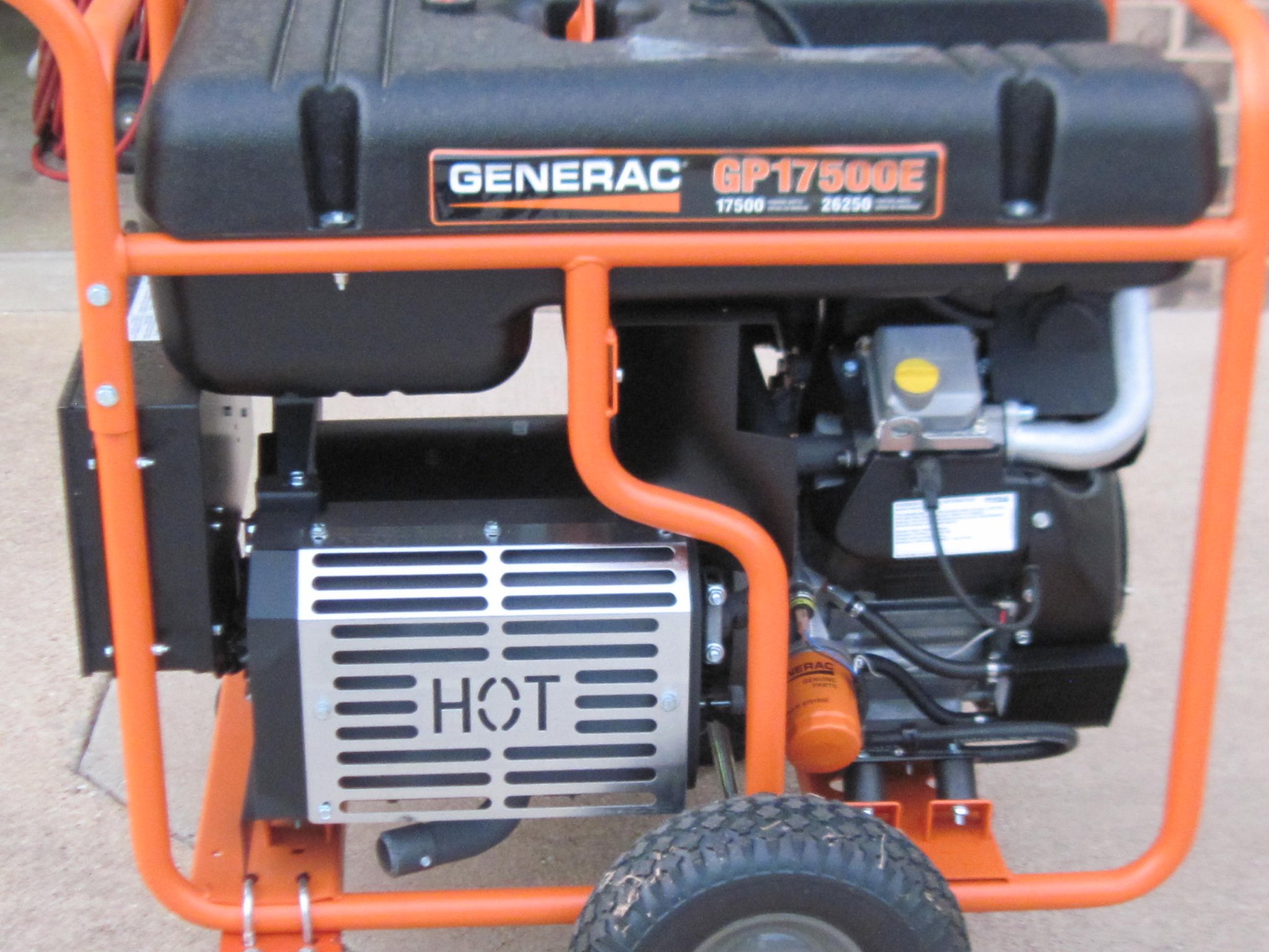

I purchased a 17,500 watt Generac portable last year and it has been used several times since the purchase...The generator, a large transfer switch and a 50 ft cord, electrician labor ...total cost was $6,879.11. I had my plug in installed inside a small work area that is inside the house because I didn't want to stand in the rain or snow and plug that thing in. It will run everything in the house. I only use non-ethanol gas in my generator and so far have had great results....and always remember to turn the gas off at the line and run all the gas out of the carburetor before you put it back up in storage..You will have less carburetor troubles.

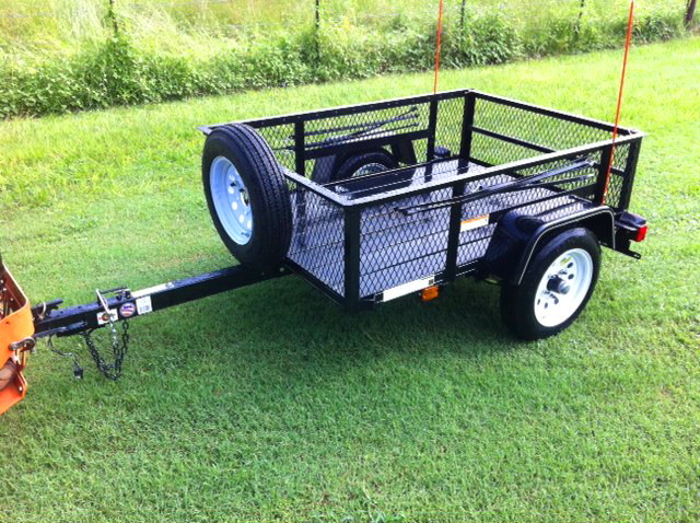

I do pretty much the same thing. Keep a portable in a storage building on my property. When needed for power outages....I simply roll it into a small trailer that I have. Drive that up by the house and park it. I have a 50'....6 gauge shoreline that I plug into the genset. On the house I simply mounted a 50amp reliance receptacle.
It is wired to my breaker box/panel inside the house and has a dual 60 amp breaker. So I will switch off the 'Main' at the house panel, also the main at the service entering the house, so everything is isolated (serves the same purpose as a transfer switch) and will not backfeed power down the utility lines.
Works well for us....BUT as 'Mark' alluded to....if i were not available to set it all up, my Wife would certainly not be able to do so. So a permanently installed (auto-on) genset could be just the ticket for some (if not most) folks.
