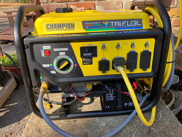

My Tri-Fuel genny is set up on Natural Gas using the Grey hose on the left.

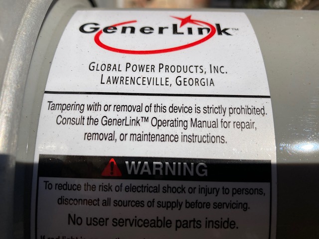

And connected to the electrical service through this.
I bought the GenerLink and my Power Company installed it.

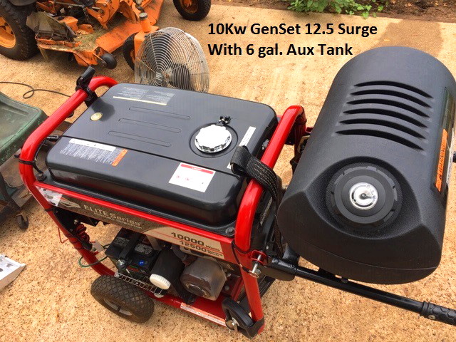

Our home is all electric....so we do the same thing. Can run anything we want and in good combination, just not everything at one time (central A/C along with washer/dryer and more) but we can pick what items we run and not be inconvenienced at all.
I added an Auxiliary fuel tank to my gen-set that gravity feeds the main tank....for extended run time.
And installed a U1 size battery hooked parallel to the smaller OEM starting battery....so I always have plenty of cranking power.

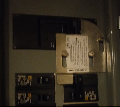

Really like the transfer pan Magicman posted. Never seen one. The tough part with any transfer switch is my house entrance and main panel are 65 feet away from my garage. Same structure - - opposite ends.

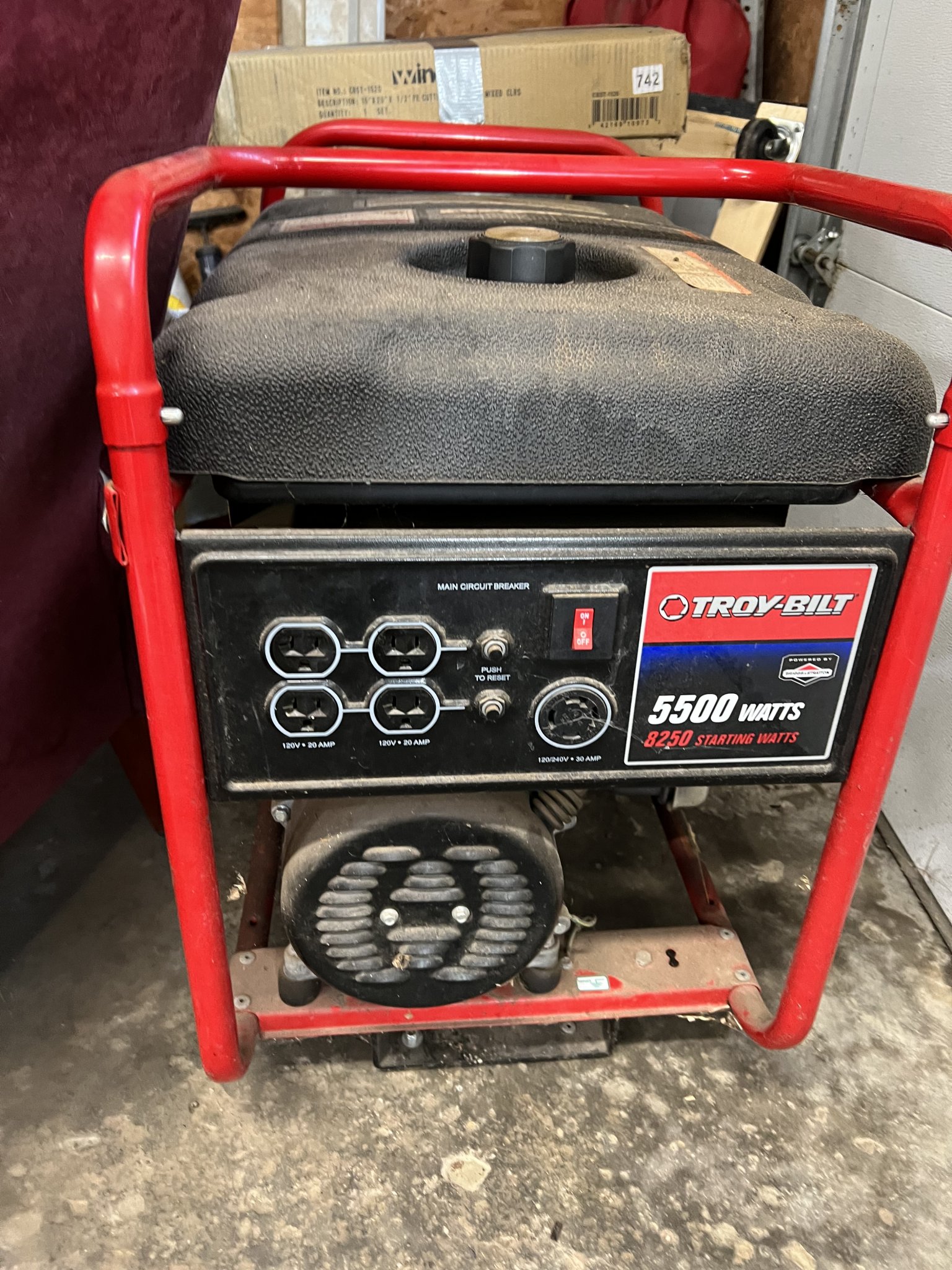

In the meantime, figured I'll look at the current generator, just to see if I can measure output in AC volts, etc.
Started by looking at part(s) availability, if needed. Started with brushes, AVR, etc.
Turns out many parts are NLA. Some important ones are, like the AVR. Brushes are NLA by the first look at it.
Haven’t measured output or pulled anything apart yet, so premature to say it’s seen it’s last hurrah..
I'll check voltage output first. Guessing there's no way to measure output capacity in amperes with just a DVOM?
A simple cleaning of the alternator and components might help. Can’t hurt. Been a while since I checked air filter, but will do so (again) while changing oil. It's ran a lot this year......
Engine is tagged as a 2009 build date. It's dusty, but that's from storage in my garage, guessing the internals of the generator end will be pretty clean.

A simple clamp on ammeter will let you measure output current, a cheap unit from Harbor Freight (under $15) will work.
Your 5,500 watt rated generator should deliver about 23 amps @ 240 volts under rated load. It is important to keep things well balanced if you are running a bunch of 120 volt stuff so that it isn't mostly on one side of the output.
