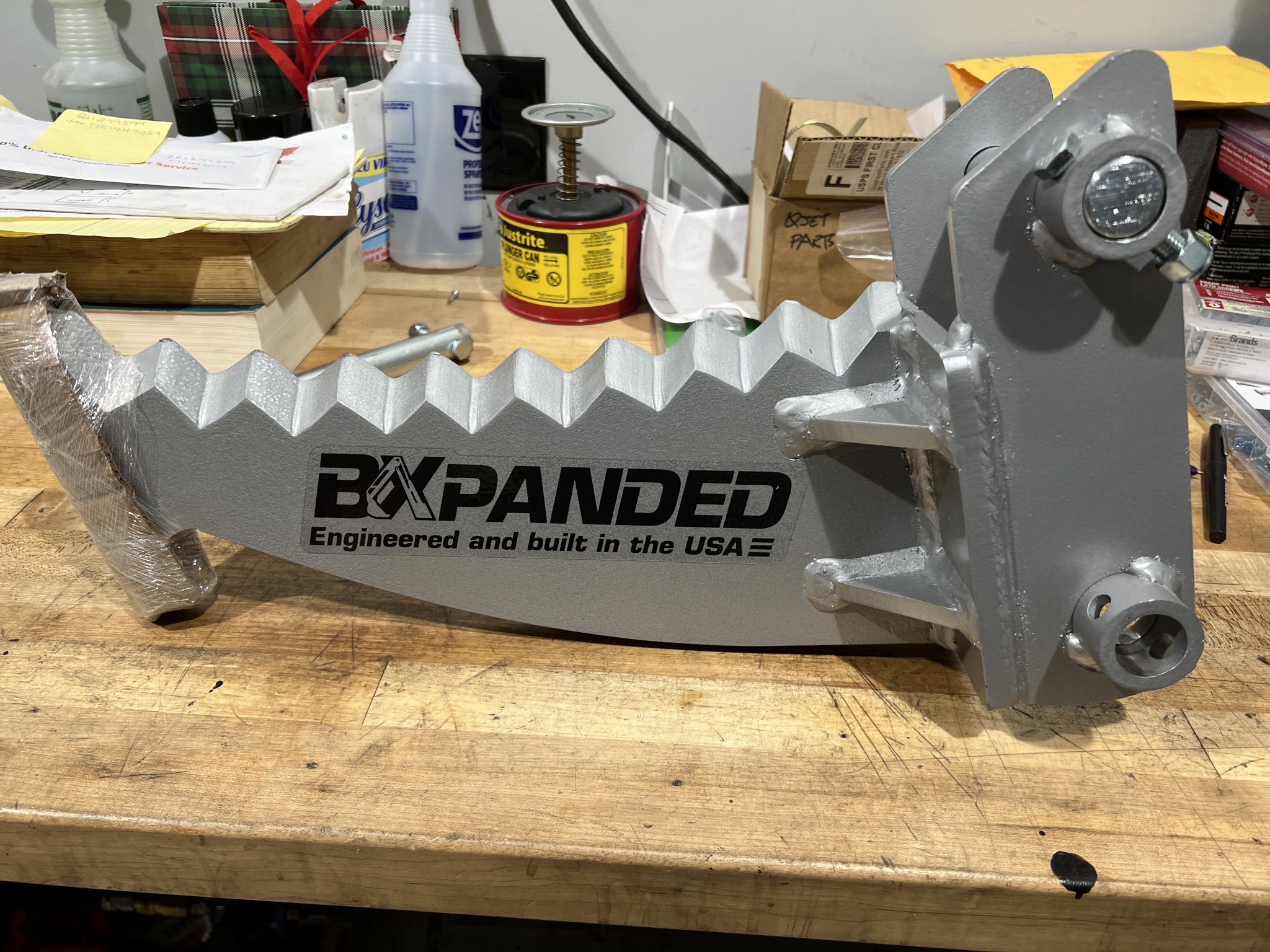

If you hit roots or really tough spots you could throw the ripper on to loosen up the area.
