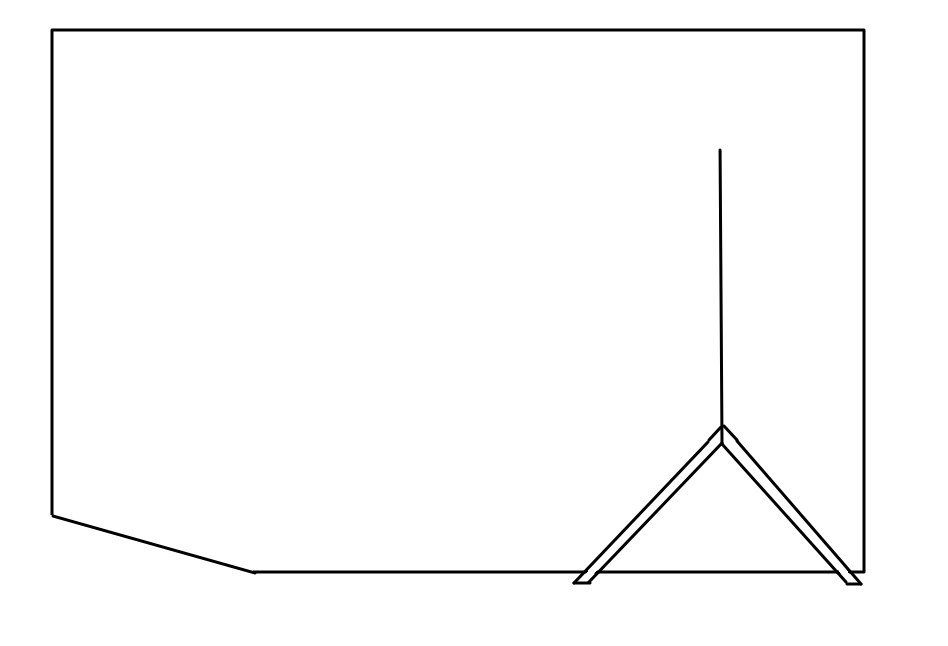

The rear of your box blade probable looks like this. If weight is on the rear blade, the front blade does little or no cutting. Tilt the box blade forward so the weight is is the front edge, then it will cut to the best of its ability.

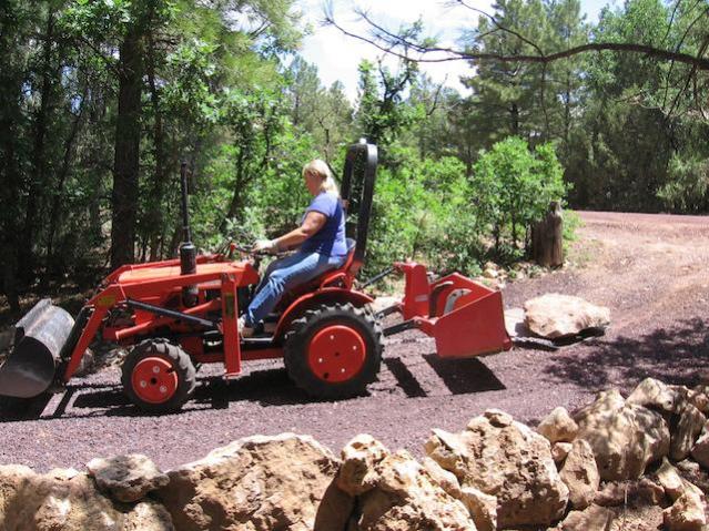

This one does, but it's only 42" wide. Weighs well over 300lbs, been told it weighs nearer 400lbs, but I haven't ever weighed it.

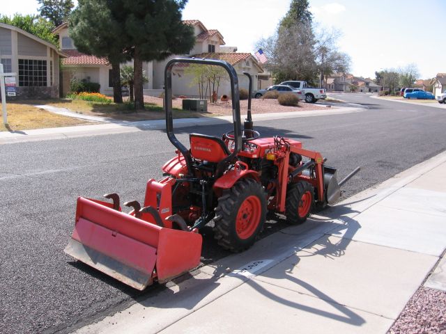

I've currently got a Gannon 4' tumbler. Not quite as big as I would like behind the B2150, but it's what I've got. It's a name brand Gannon, not a chinese sheet steel box, pretty heavily made for the size, so you (or at least I) would expect it to work pretty well as is. I've run rigid boxes like these back east back east on my beefier tractors of similar size (MF 35 for instance), with no issues once set right, as long as you didn't get into red clay (whole other story). But a lot of the soil out here is hard as concrete once you get through the talcum powder dust. I've read threads and watched videos, but basically no joy, it just didn't want to carry unless it was fully pulverized. Then I took the 2" thick press plates of my 50T press, grabbed a couple of strong arm clamps, and added just under 200 lbs to the box. Now, as long as I've minimally broken up the concrete using a pass or two of the rippers, that thing fills the box just fine, often to overflowing. You have to be sane about the weight the frame can handle, but I've seen wheels with tires, cinder blocks full of concrete, all sorts of stuff used as weights, and I've also seen tractor suitcase weights used.
