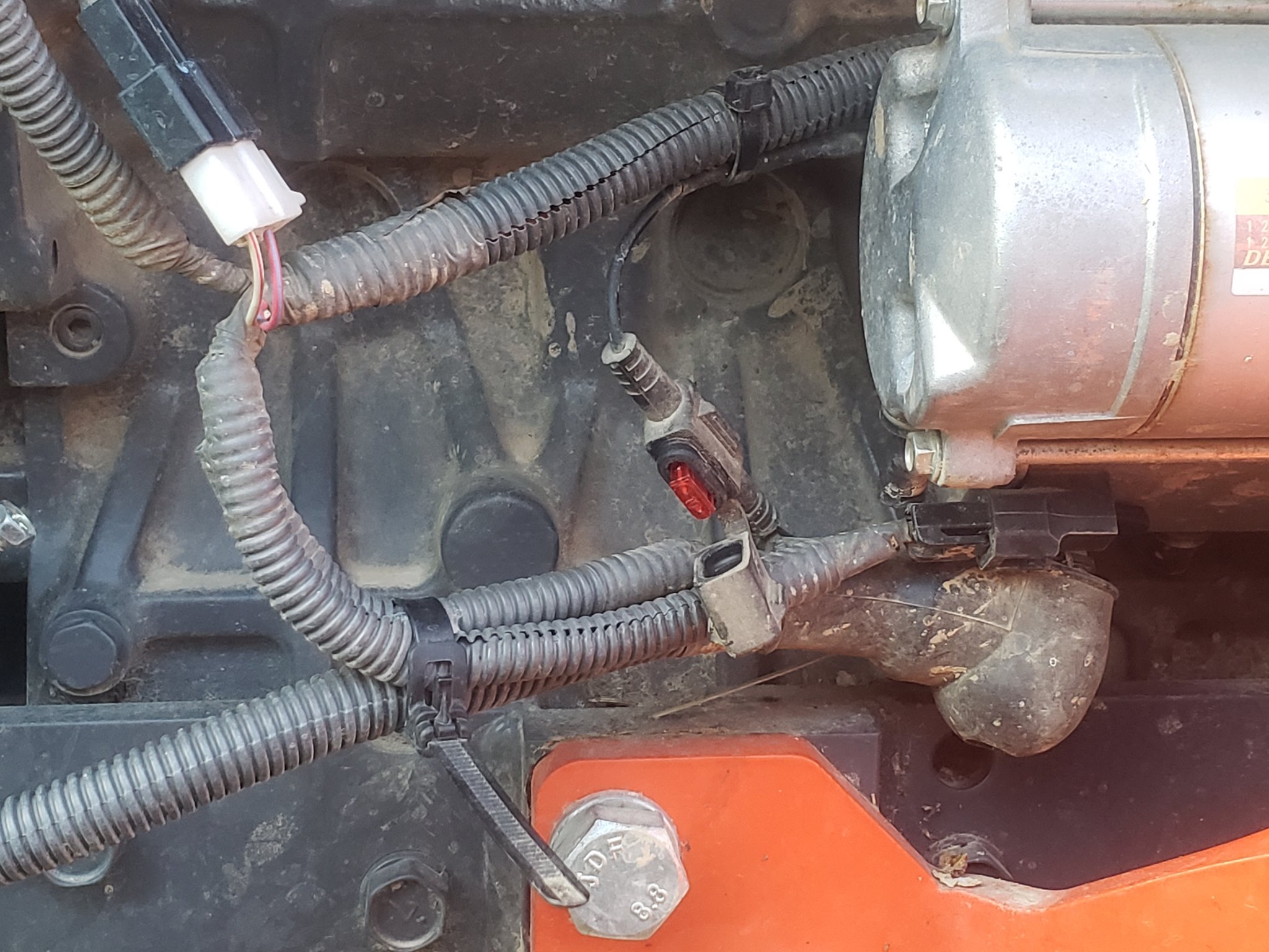

Update on the situation. I have learned a few things. First a lot of people have an on off switch for their 3rd function. Second 3rd function has a hot wire that has a fuse and lastly located my fuse box.
I checked the fuse box the other day and everything looked in order. No fuses blown. My 3rd function does not have an on off switch. It was installed by the dealer. I dont know if this is right or wrong.
This evening I backtracked the hot wire to the the starter where I located a fuse. Pulled the fuse and it was fine. Stuck it back in and bummed that I haven't found the issue. Started the tractor up and worked the joystick and the grapple worked. Seems like the wiring at the fuse was loose or the fuse had worked out.
I appreciate all the help and responses. You all saved me a days worth of work to loading and hauling
the tractor to the dealer to have them do no telling what.
I called the dealer and specifically asked them for pointers on where to look. I was disappointed with then the only response was given was to bring it in.

Great news! Troubleshooting the system yourself is a great way to learn it and helps to remember where things go in the future. You could even flag that fuse holder shown with a "3rd Function Fuse" label, or make note of it in any documentation/manuals that you have.
I added a separate ON/Off power switch to my install just to de-energize the system when the grapple wasn't on the tractor. Especially so over the winter months.
