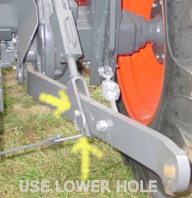

Hello all, I recently purchased an M5660 and it seems to me the tpl doesn't raise as high as it should. I have a 63 ford 4000 and it seems to raise almost twice as high as the Kubota. I don't know if this is normal for the Kubota or not. I already have the top link attachment in the lowest hole. Any input is appreciated.

Could be that the feed back linkage is out of adjustment.

Mark,
on the lower arms....
is there ONE set of holes or two?
Some lower arms have multi sets of holes, the ones closer to the ground or closer to the tractor will allow a little more lift.

I agree, my Kubota lifts the implements up ok, just not near as high as the Ford. I do have them in the lowest hole already where the top link connects.

I had the same problem on my M5040, dealer showed me how to adjust the feedback linkage to get it to lift higher, no problem easy adjustment, just be careful and not exceed the travel limits
