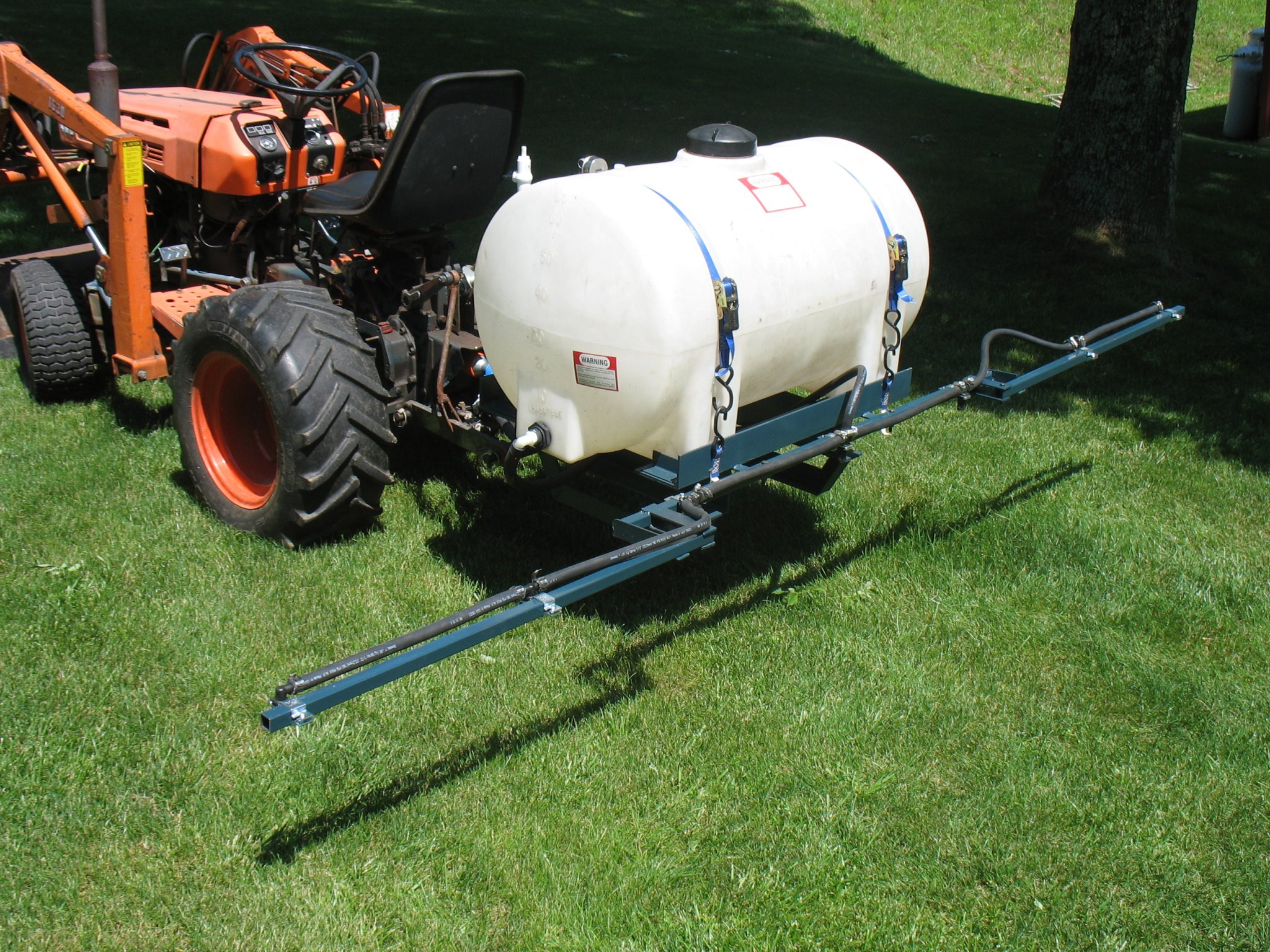

edit #2: Here is the new 3 point hitch setup I just fabbed together for the Fimco 25 gal. sprayer.
