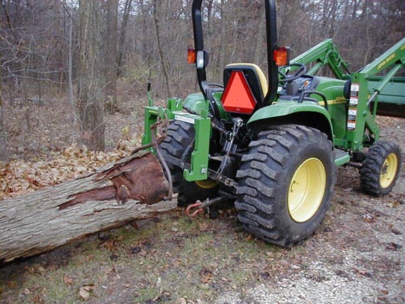

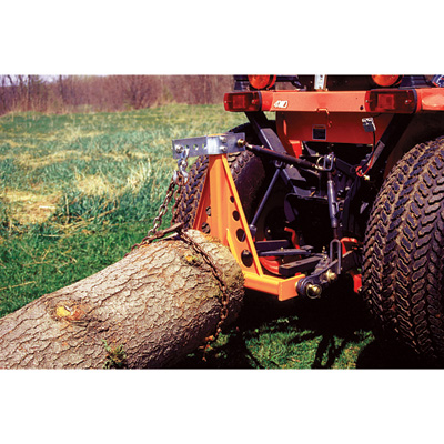

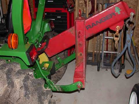

Here are a few different models to copy from if you still want to try it.

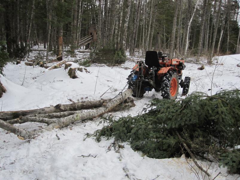

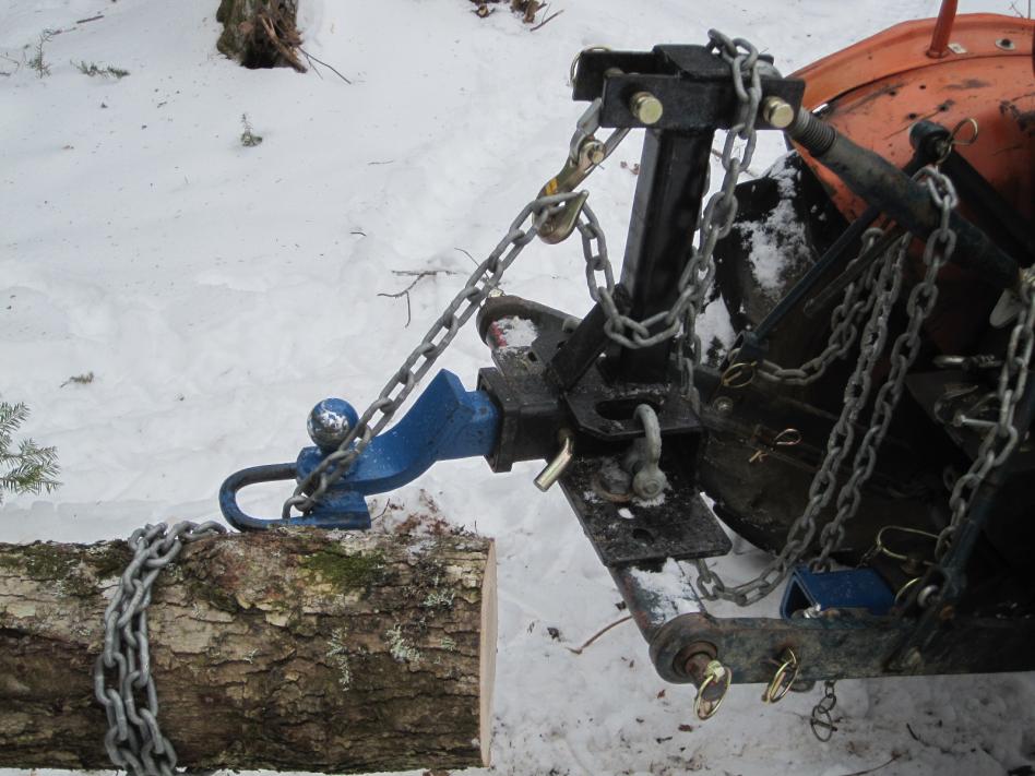

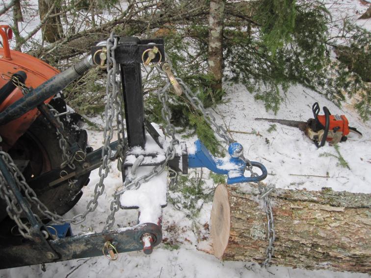

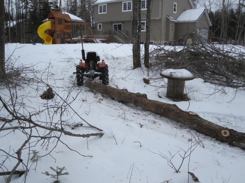

I built one for my 1980 B7100D a couple of years ago (and posted on here at the time). The chain passes through the tow loop on the trailer hitch & then hooks at the top of the trailer mover/skidder - lifting with the 3 point but pulling down low from the trailer hitch. That winter I used it to skid out 10 cord of Maple logs for firewood. Perfect conditions as a couple of hard freezes had solidified the swampy areas & there was 6 or 8 inches of snow which made skidding easy. Never once did the front end attempt to lift up even while climbing an incline. Little tractor was amazing with what it could lift/pull & hardly had to clear any trails to get around to the logs. Had a ball!

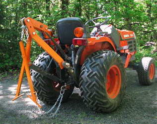

Finally got around to building the skidder last weekend. Cut and welded the pieces on Saturday and painted Sunday. I made it to fit my T-Bar with the 2" receiver. I used 1/4" thick 2"x2" square stock. I'll add a check chain from the draw bar to the log to help keep the front tires on the ground.
15,225
4,436
Yeppers that looks good,, I could have used something like that in the fall

I remember seeing your rig a while back. Amassing what these small Botas can do when set up right. :cool:
