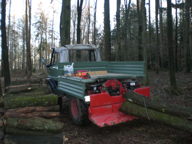

This is how older lighter Unimogs skidded logs. This setup is a professional one. What I like is how close to rear of Mog (Mogs are tractor and truck combined) and the lifting unit has a lip the log sits on. If the Mog starts to tilt back the very thing lifting the log acts like wheelie bars on a Drag race car
