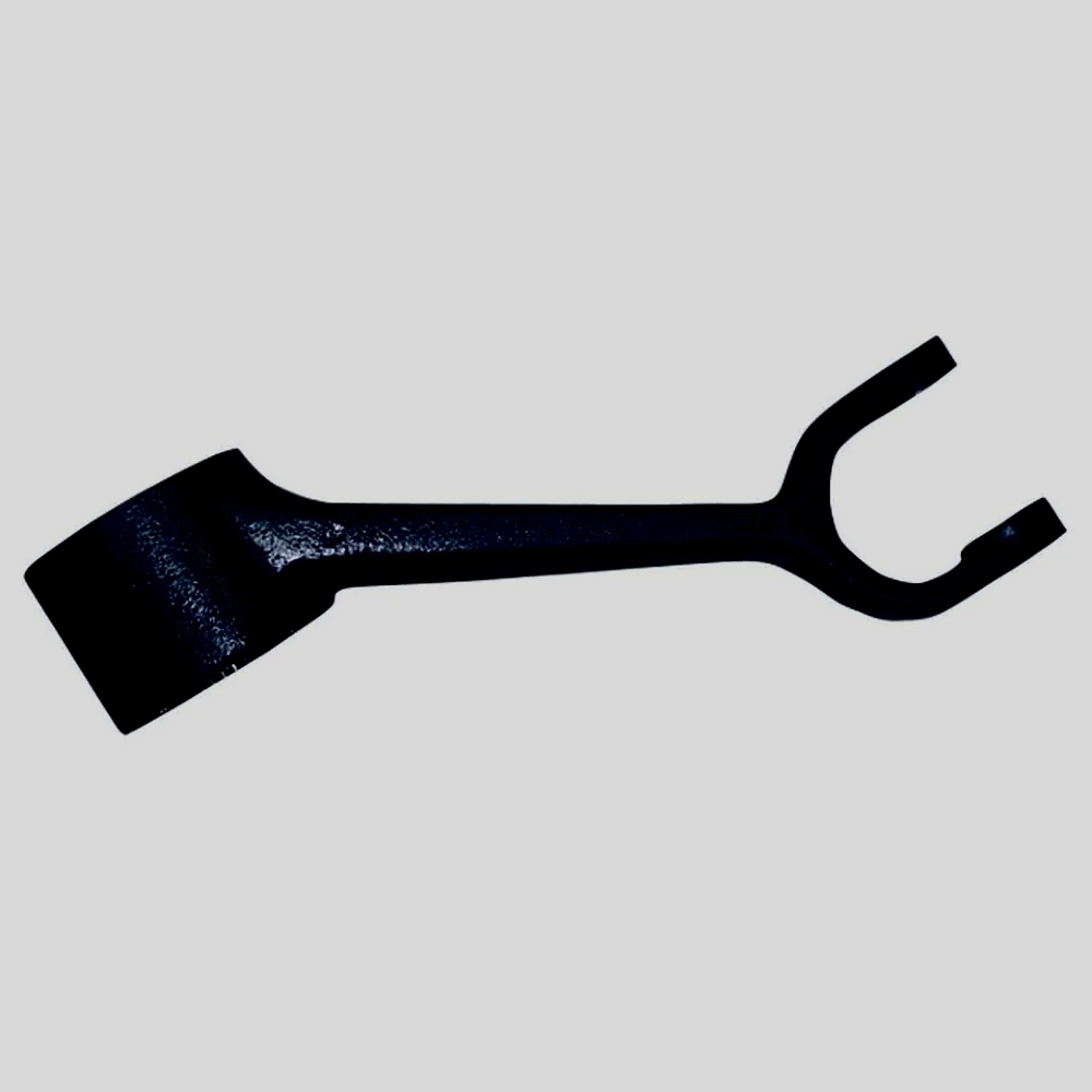

Thtee point hold down stay bars been around since Harry invented the 3pt hitch.

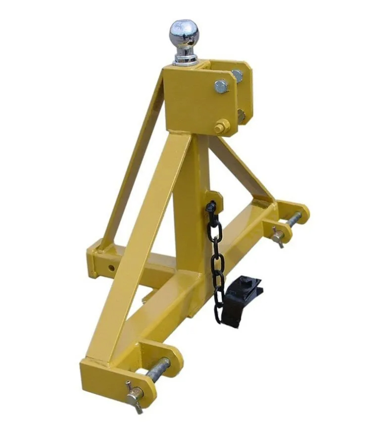

It sounds like the trailer was hooked up to a receiver on a 3-point hitch, and as he backed up the snowmobile, to presumably move it off the trailer, he created negative tongue weight which raised the receiver and the 3-point. Doesn't sound like fun.
This King Kutter receiver has a chain to prevent the 3-point from lifting up. I bought a used one for $50 but it was missing the chain so I added one.
