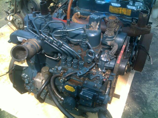

This is a bit of a follow-on really to a previous project that i just never progressed very far with to be honest.
I have a nice little V1100 engine good looking for a good donor tractor to go into, i dont have any what i would call spare tractors lying around , so i'm going to attempt a retro fit into my B7100D, mad, maybe but i allway like to be at the cutting edge or should that be the edge full stop:D:D
Anway, its going to be out with the D850 and in with the V1100, not sure if its going to as straight forward a project as some previous ones.
I do have one big advantage with this swap over, the v1100 is also one of the 70mm series engines so maybe a tad longer etc, a lot of the block details are the same etc along with the oil filter location injector pump etc etc, so in a way thats half the battle won.
its all the parts that interconnect that will need looking into at greater depth, such as drive shaft and flywheel etc.
As they say over here, " its a tough job but someone has to do it";)
pic of a similar unit attached.
i'll keep you all upto speed with progress, good or bad.
rob

Rob
B6000DT / B7100DP /B8200DT/L225/Globe PTO Chipper/Lewis Backhoe/huxley TR66
Nov 22, 2009
679
9
Leafy England....
well i have made a start, small, but its a starting point nevertheless.
spent a while trying bits and seeing what will fit to other parts, so far the engine crankshaft and clutch assembly and flywheel all workout out nicely ( thats one big issue overcome :eek:).
Drive shaft from gearbox fits into crankshaft a perfect fit, clutch fits spot on to shaft splines also:).
bellhousing backplate is not far off a spot on fit, just need to drill two differing holes as they are a fraction out, otherwise good to go.
the drive shaft coupling on the gearbox - drive shaft is not such a good fit, infact , its not even close, probably have to source one from a 1750 or b20 as they are probably closer to the size i need. i did suspect that this would be a problematic piece to overcome.
thats about it so far, i'll stick some pics up of things as they progess further.
