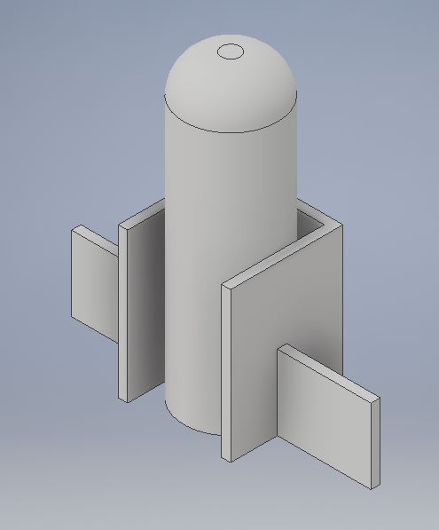

If you have any scrap wood around .....make a box that has two legs sticking left and right - this box will allow the container to sit in the bucket, but not allow it to slide left or right as the box will not be able to move due to the legs.
Something like this:
