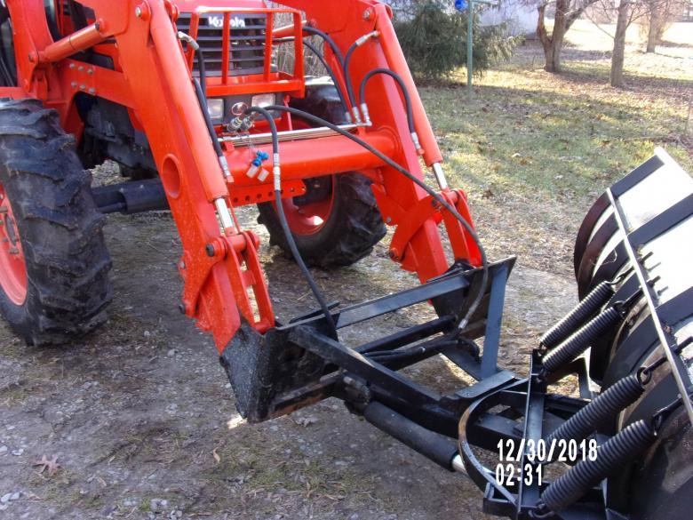

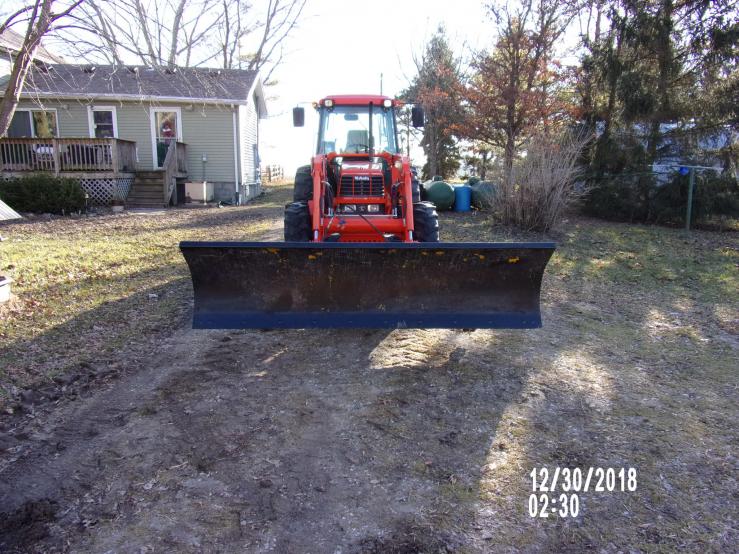

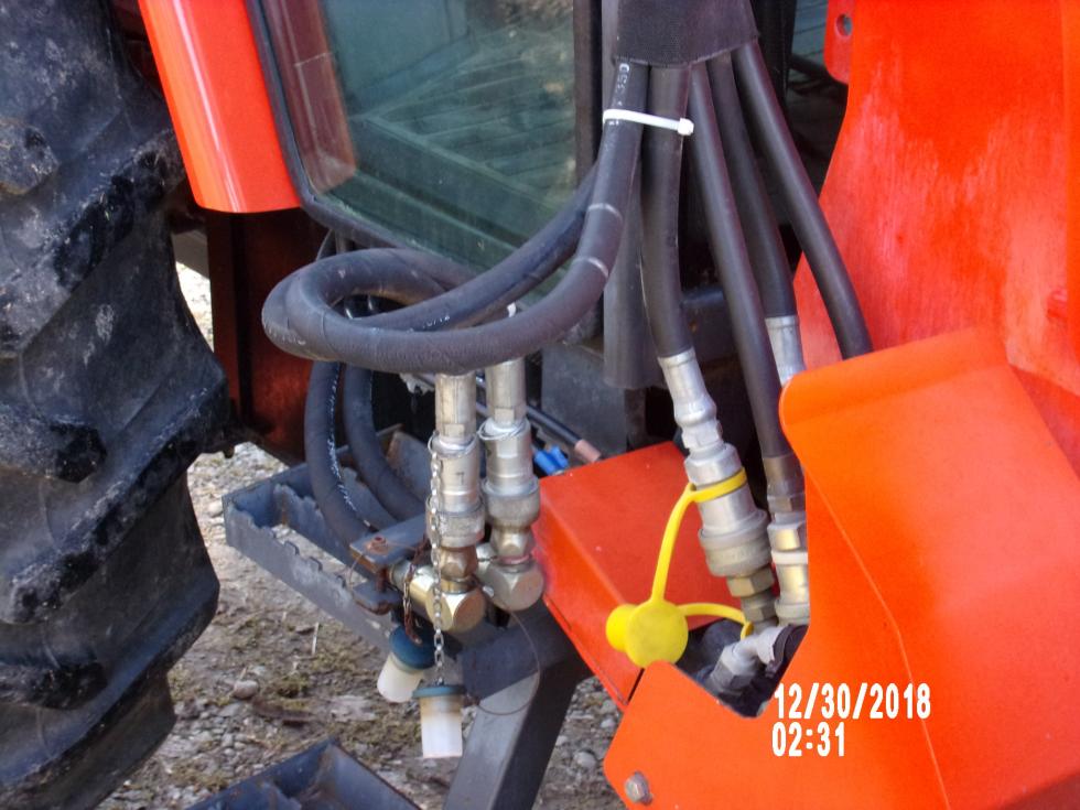

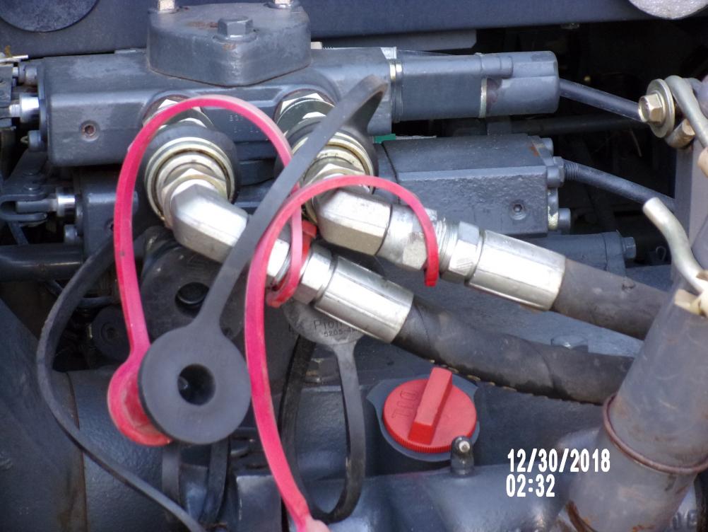

Added a Bobcat style 2 pin plate to carry the plow on the front of my M9. Also included the pictures of the added hydraulic lines and the disconnects so I can remove the loader if necessary plus the hookup out back for powering the power angle Use the top remote (non detent) for angling the plow.
10 foot wide and around 1000 pounds. The cutting edge alone (which I replaced) was a tad over 100 pounds.
Have it just in case...:D No snow yet.
Like my new camera too. Takes nice pictures...:)
Obviously not for a small tractor but I'm sure the M9 is up to the task. Probably use it mostly on the road out front. It's a mile to the pavement. Need to add some sissy sticks to the plow and a rubber top flap but that can come later. I have the same setup on the 105 so I can use either if necessary.

Came by that one per chance. Was sitting outside the county garage, no for sale sign or anything but I thought I'd ask and it was. I had no way to pick it up (my farm truck is hibernating for the winter) so I asked if they would deliver it and they say sure so it came here on the bed of a stake truck.
No undercarriage, just the plow and the frame and cylinders. Had some odd lengths of hydraulic hose in the shop, just enough to get to the couplers.
I'm a little worried about the QD plate but it should be ok. Has some broken welds on the vertical stiffeners but I'll address that this summer when it gets sandblasted, welds gouged out and repaired and a coat of Orange II.
Probably have to either get the cylinders rebuilt or change them out, both are pitted a bit and both weep slightly, about enough to wet the housings.
Someone at the garage redid the skid shoes. They took 2 5" rounds of 1" steel and made up shoes and welded them to the bar stock adjusters. Very stout setup.
The old cutting edge was shot (crooked) so I got a new one (undrilled) and drilled it to the required spacing, countersunk the holes and square broached them for 5/8" dome head A325 plow bolts with alloy hex nuts and alloy lockwashers. That should secure the edge just fine.

That is an 8 footer. Lots of them on CL here as well. Hard to find a 10 footer because even angled over it's overwidth for on the road. 10's and 12's will be road department plows.
10 foot will give me a 2 pass road blade and the neighbors on the road will appreciate it, however they probably won't contribute towards the fuel.:eek:
That one is pretty rough. I was worried that where the cutting edge mounts to the sub frame it would be rusted out but it wasn't. Glad of that. Would have been some serious fabricating if it was.
This spring, I'll strip it, sandblast the whole thing, plasma gouge out the broken welds, re-weld them and give it the 5 gallon finish in Orange II. I need to add alignment wings to the QD plate, it's hard to line it up to pick the plow up as it is.
Believe this one is a Western. the bolt pattern on the cutting edge is Western though there is no nameplate on the plow.
Should outlast me which isn't saying much.
I have the remotes on the loader frame for operating my WR Long square bale grapple that I haven't used in 4 years, so all the plumbing was already in place. Might as well use it.

Dang, looks like mine.... I only have 4 tip over springs (have space for 2 more however). I splayed the upper angle iron mounts out more so as to apply the force to the ends of the QD plate and ran a 3/4" piece of flat stock across the bottom as well. Burned a lot of rod on that deal. Could be a Meyers and not a Western but the bolt pattern on the cutting edge is Western. No matter, will be orange this summer.
Same price as what I paid, well, mine was a hundred more (for the plate) and my time to fab it up.
