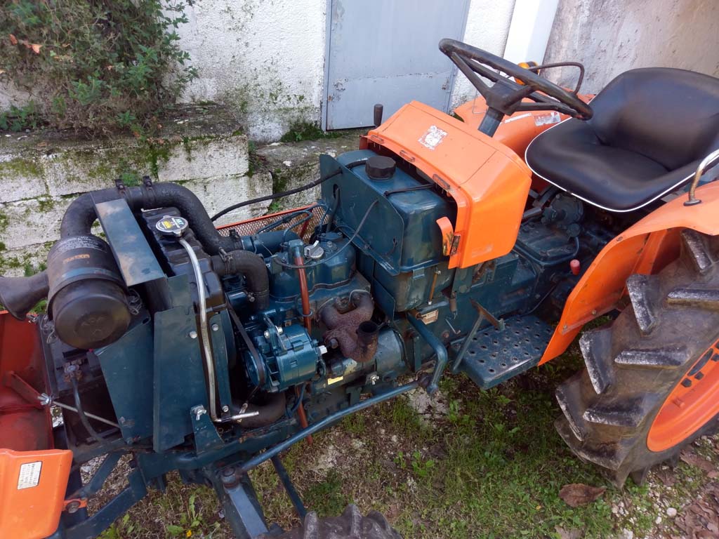

The old tractor is working hard with no problems at all, so now i decide to service some of the implements.
Nothing special for most of you, i had some orange color lying around in the house from an old project so i decide to service the tiler and paint some parts.
Here are the photos that i know you all like.
You can see how bud it was, the primer and the final result,
the seat had faded and i paint it as well

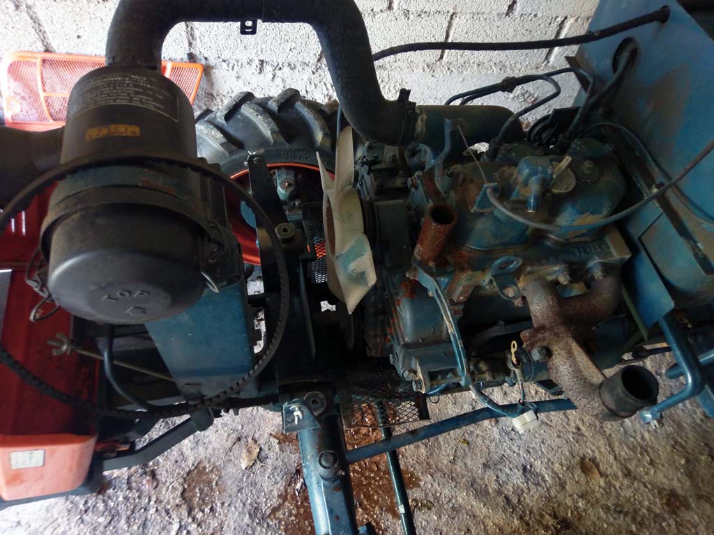

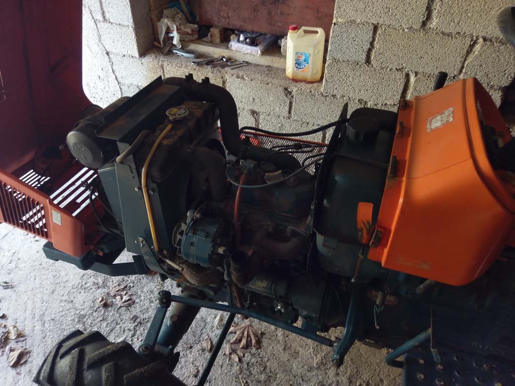

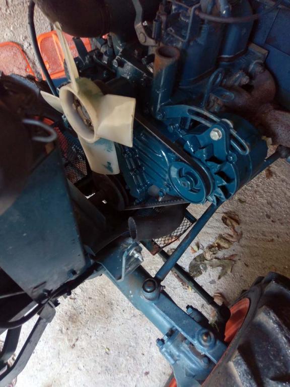

But here i i'm and after one year, the Kubota is holding strong and as it needs i decide to clean the cooling system it was very muddy as you can see at the second picture.
A new hose had to installed because the old was ready to collapse , new belt and a small restoration with new ball bearings at the alternator because it had develop some bearing sound.
As you can see i have spay paint the parts. :D
I know it needs a good wash but i have no time and it's raining all day.
Here are some photos of the disassemble and assemble.

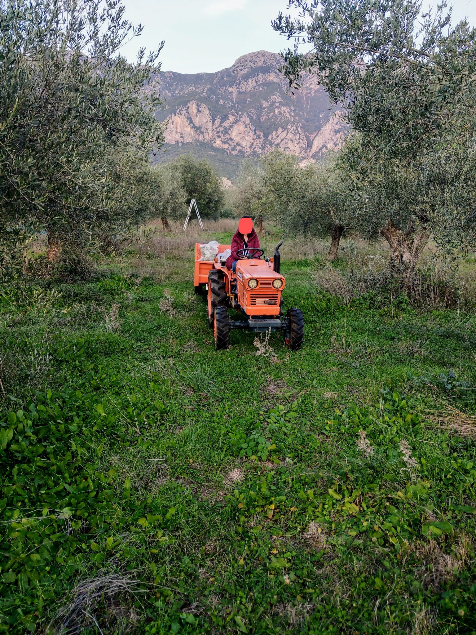

Long time no see again. The truth is that the old beast now has 1800h on the clock going strong without problems.
This time of a year, again we harvest the olives and the kubota works hard.

You are a busy man. Are the olives for your use or is the orchard big enough that you are raising them to sell? We have mountains and orchards here but both look quite different. It's apples here.

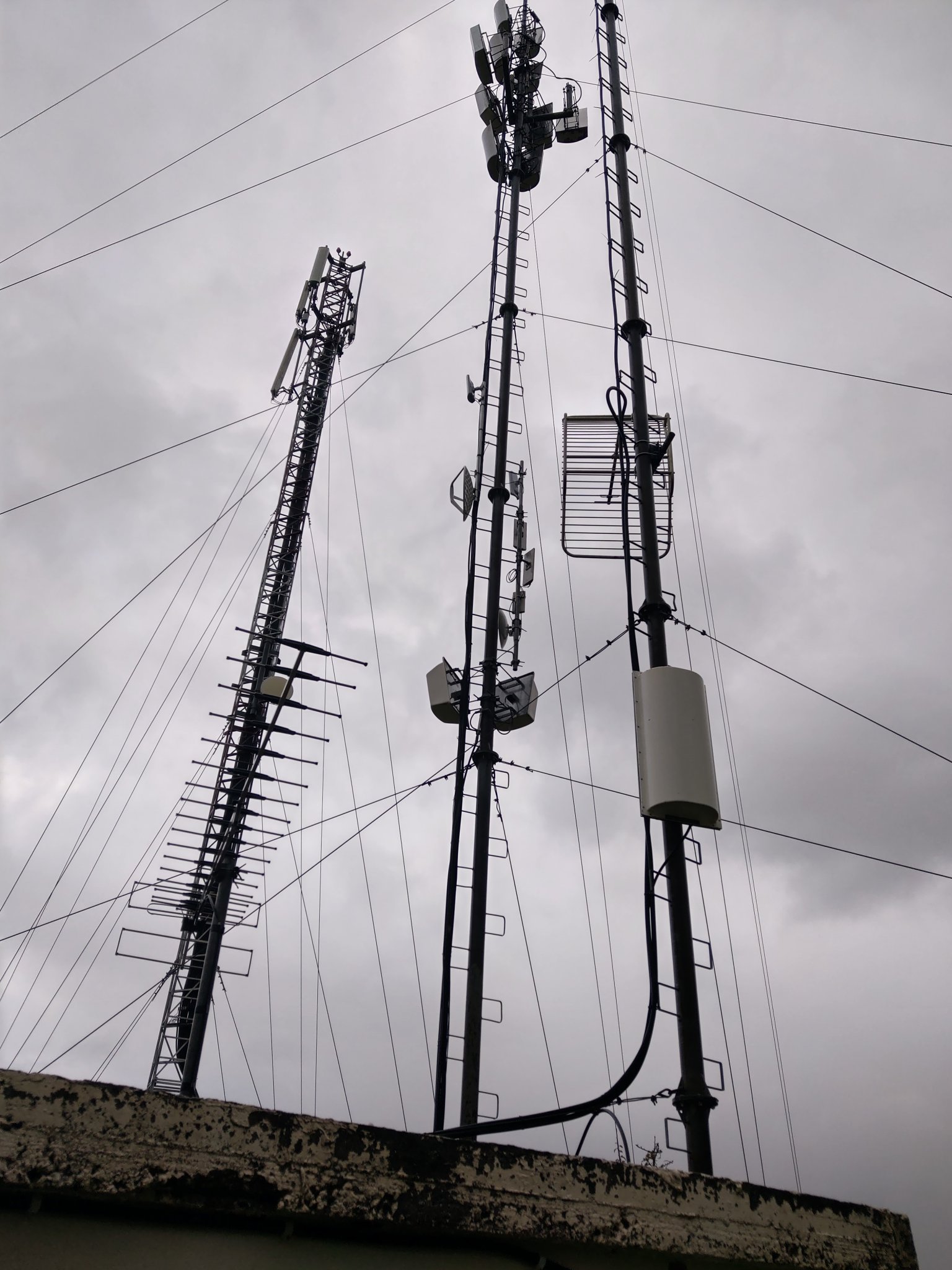

I'm a small IT, i make hotels and business networking and i have a small Wi-Fi network, like internet provider.
The olive trees are enough, my father likes them, about 400 trees that offer me their fruit and the oil that my family eat, some times i sell the extra olive oil (virgin olive oil) about 5€ per litre... All that in a happy village life.
(not all the antennas are mine)
