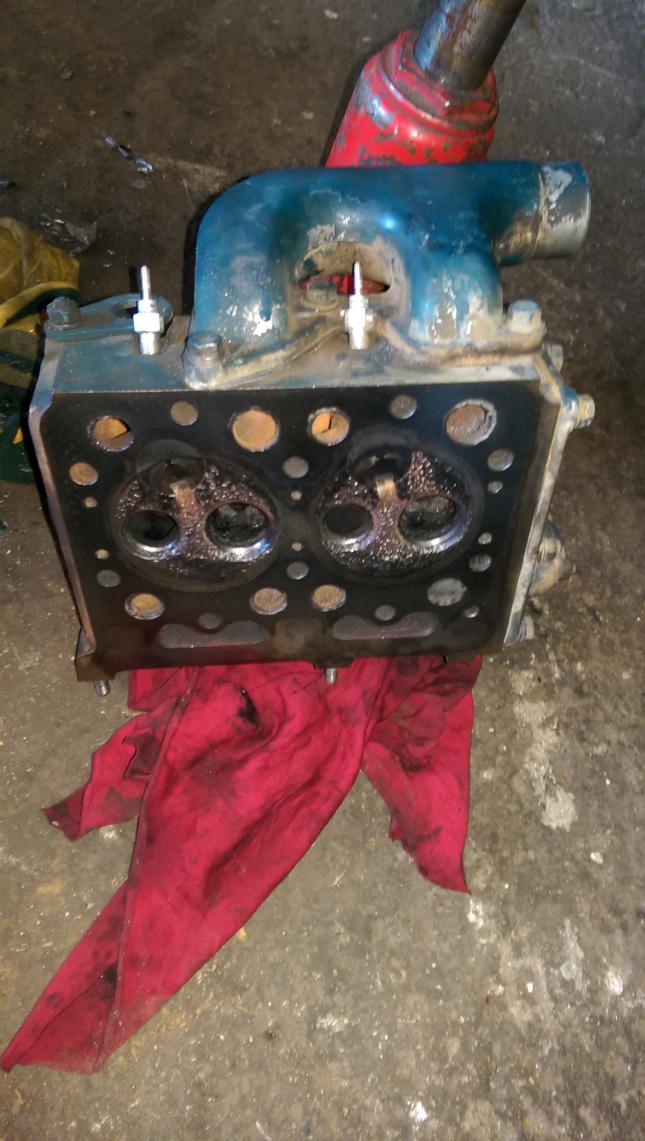

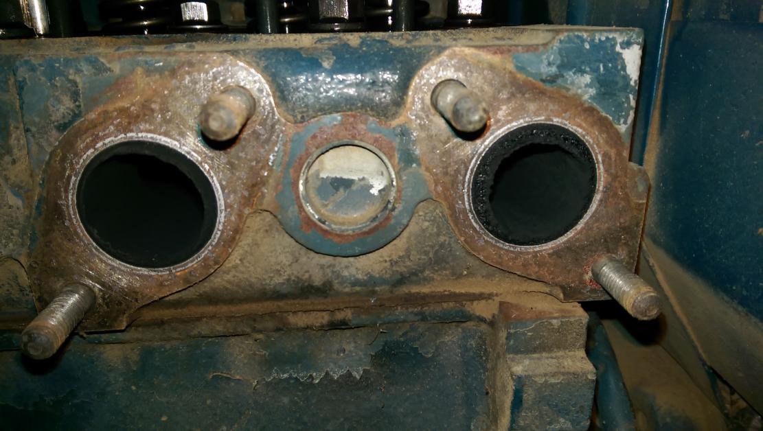

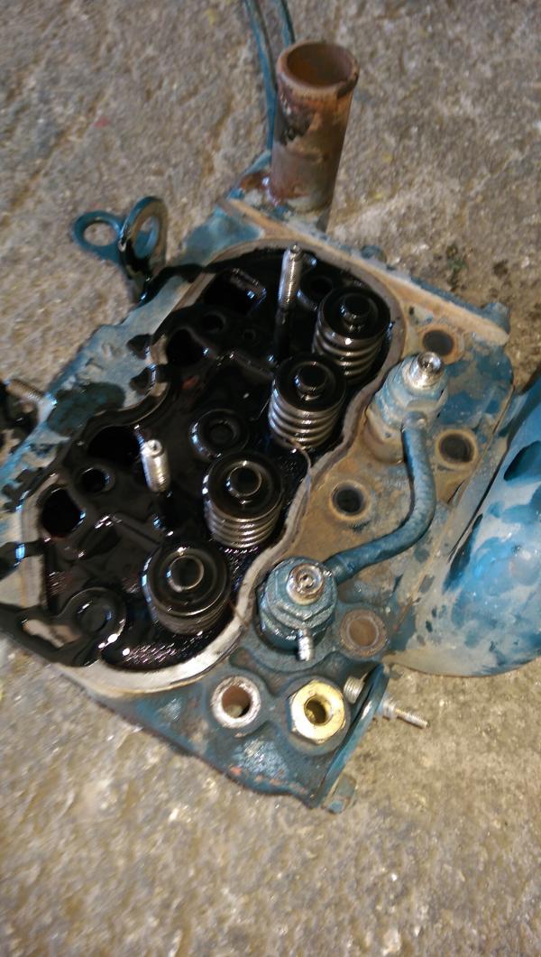

Here i am again.
i have made a great progress today.
only 5 hours it was the disassembly, even with the problems that i have found.
first i start removing the oil and water and i continue with the parts upper the head and the head.
just unbolt everything and save the bolts in a box. easy job.
you will see that the back cylinder has a lot of junk at the exhaust port.
...the photos....
sorry for the dirty tractor but i didn't have a pressure washer there.
i will wash it after the rebuild.
the cylinders are in a good condition not perfect but i will hone them and i will see how they will perform.
as i see with the little thinks that i know for engines (because i'm a computer boy) the combustion looks almost perfect.

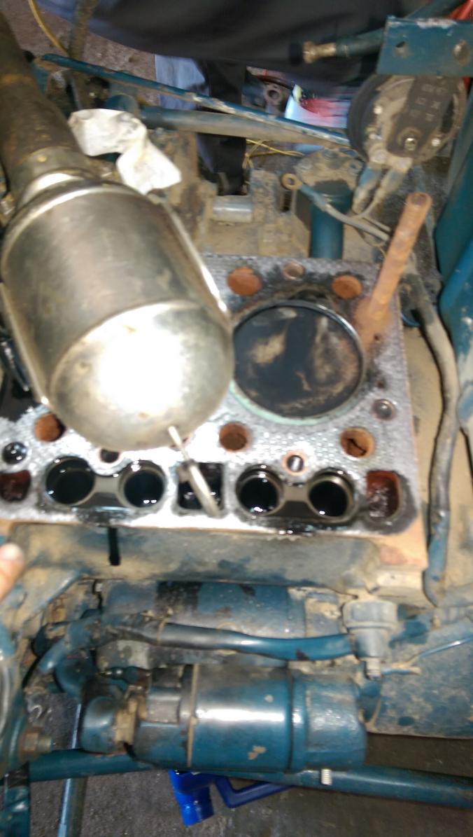

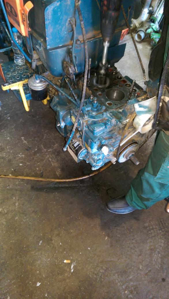

as you see the combustion has a nice brown and black color that to my eyes looks fine for its age.

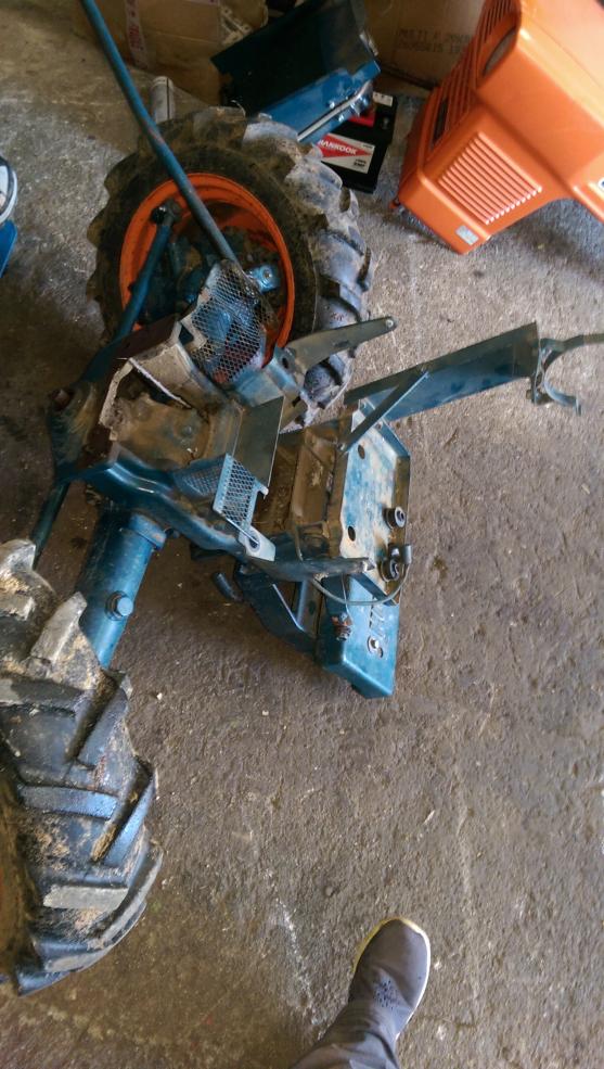

now i thought that all the day is going to be as easy as now,
well the problems had start after i remove the four bolts under the engine that hold the metal tube that protects the 4x4 shaft.
well the rear coupler it wouldn't move it self with nothing, i had to use the torch and make it glow red, then with a bigger hammer i manage to move it back and remove the shaft.:D:D
YES i say time for the sump and i start o remove the bolts,
well NO.:mad::mad:
Two of them are inaccessible because you have to remove the front differential.
and 3 of the bolts that hold it its in a very deep and problematic space.
Its like the build the tractor and then they decide to add the 4x4.
bravo kubota

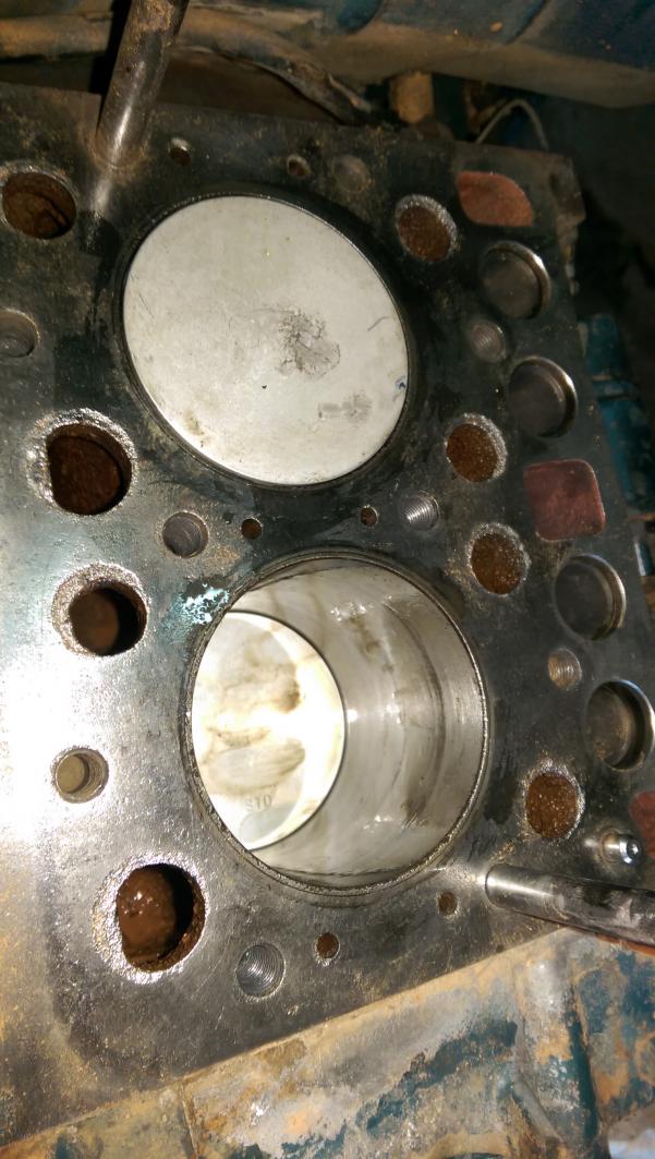

after a lot of :mad::eek::p:D:mad::mad::mad::eek::eek::eek: i had the pistons in my hands,
the rings have some play and the cylinders walls need some honing.
the crank looks and feels perfect.
so i will wash,clean everything, hone the walls, change the pistons, the rings and the bearing rods.
and at the head i will change the valve steam seals and will grind the valves.
new gaskets and etc...
here are the two last photos

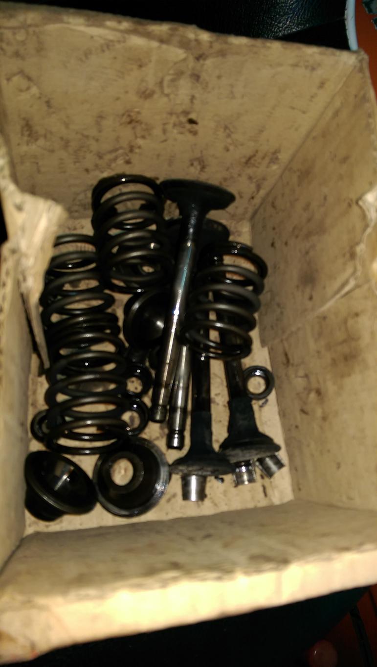

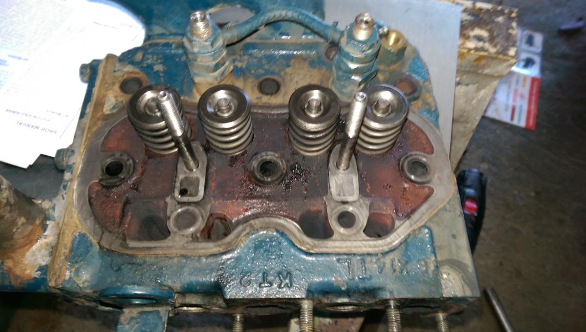

here you can see the nice clean cylinders, not perfect but for me they are in good shape.
i have also clean the block and wash it, clean and check the valves.
and since now everything is clean i start with the head, assembly the valves and grind them, new seals new type with springs, my old ones were just a rubber seal without springs on top where they seal the valve.
the head is ready.

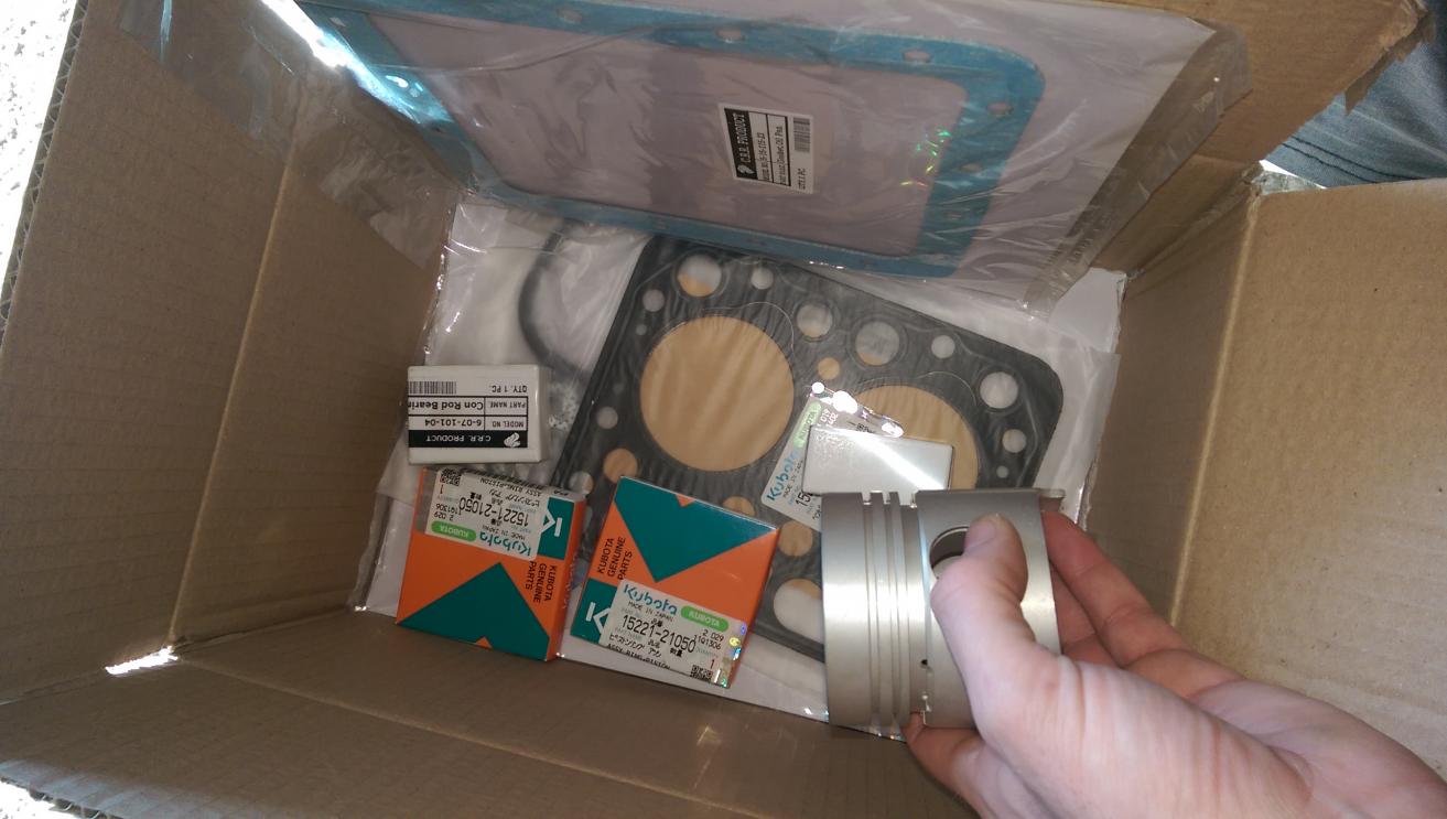

old piston out and two new pistons with new rings in.
i have also put the head in the front wheels and all the parts that need for engine to start,
sorry that i don't have pictures but it was late and i make everything to start the tractor,
i have not put the hood and the front drive shaft,
so for an info for all, i have pay the parts + filters and oil and antifreeze 250euro
The tractor start after i bleed the lines, its working perfect without black smoke and with good sound.
if i find time tomorrow i will put the 4x4 shaft and the hood, recheck again everything and start working it.
