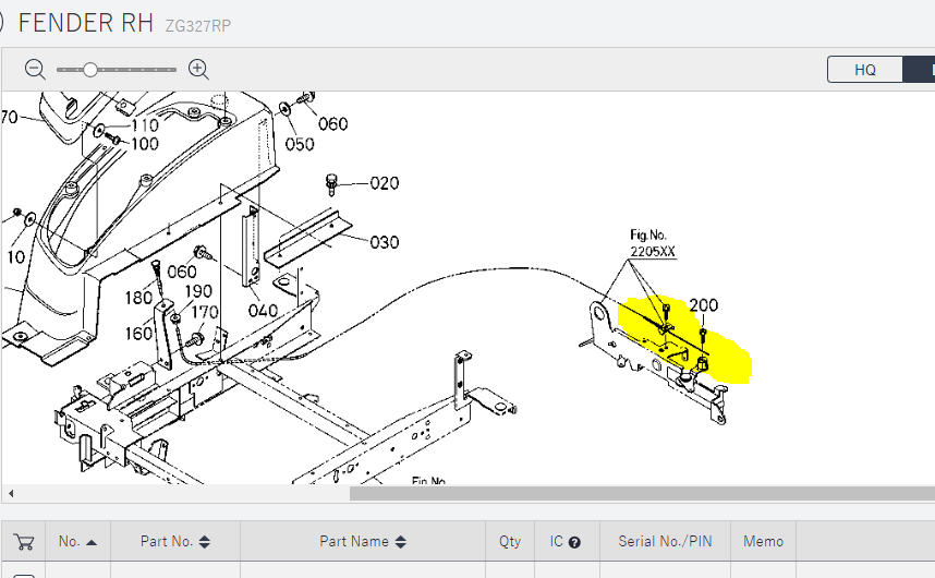

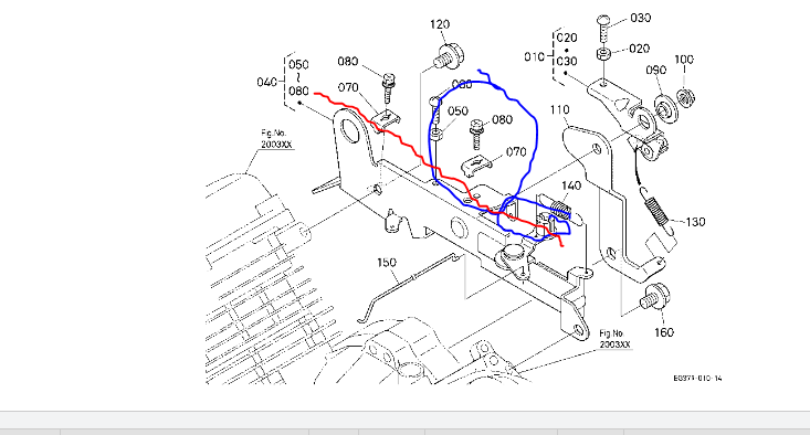

Need help understanding how or where the choke arm/linkage connects to the carburetor. Mower is a ZG327. A picture would be helpful

most if not all those carbs had a plastic clip. You'd push the end of the rod through the plastic then rotate the clip so that the other end clips over the straight section of the rod. If that little clip is broken, you may have to replace the carb-I forget on those mowers, but on some of them that's the only way to get em (the whole carb).
