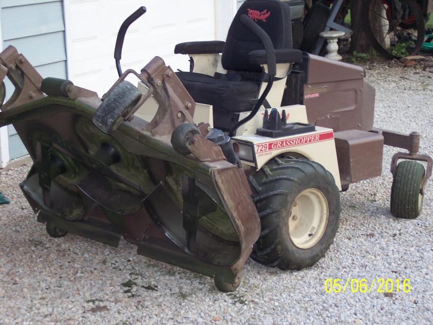

Fatjay, you said "One thing has to change, the R4 tires need to go. Tight turns dig in and ruin the lawn."
Before you go out and replace your tires, mow for a while at a slower pace and get use to turning.
We've had Grasshopper mowers for several years and my wife does ALL the mowing. She complained initially about the divots the tires made when turning. She's a cosmetologist and one of her regulars owned a lawn care service. She'd pick his brain ever time he was it about how to do this, how to do that.... She'd come home and be excited 'cause Kenny came in and got a hair cut. Then tell me the technique he told her, then go right out and try it.
We never changed tires. New machine last fall, same tires! Yard looks NICE!
I'm suggesting you need a good coach!!
