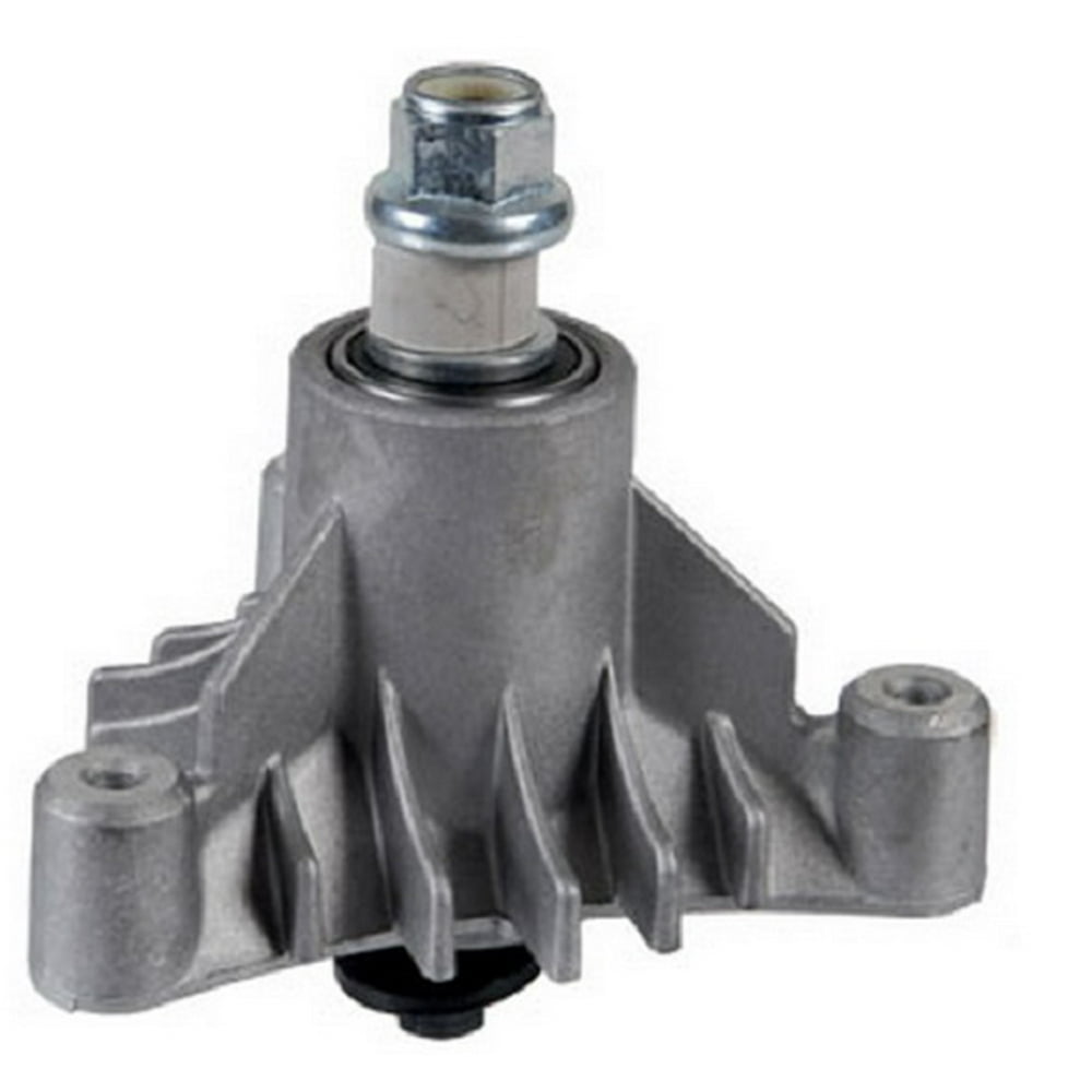

On many mower deck spindles there are bearings at the top and the bottom of the spindle. There is often a fairly large space between the bearings at the top and bottom of the shaft in the hub. That area needs to be filled with grease to get grease to both bearings.

The bottom would require you to remove the dust cover to see the grease.
Look under the pulley for it to overflow.

yes, but only after the entire cavity is filled. Most dealers don't put enough grease in them and Kubota doesn't ship them with a lot of grease in them. When I was doing them professionally, the dealer only allowed a certain amount of grease/fluids/oils/etc to be used, so on something like the bigger ZD series mowers, if I wanted them greased properly, I had to buy the grease myself. Using a pneumatic grease gun, it would still take time to fill them all up. And almost a full tube of grease-per mower.
yes hit it until it starts to ooze out of the upper seal under the pulley. From then on, it won't take much grease each time, a few pumps at the most, til it stars to ooze out.
