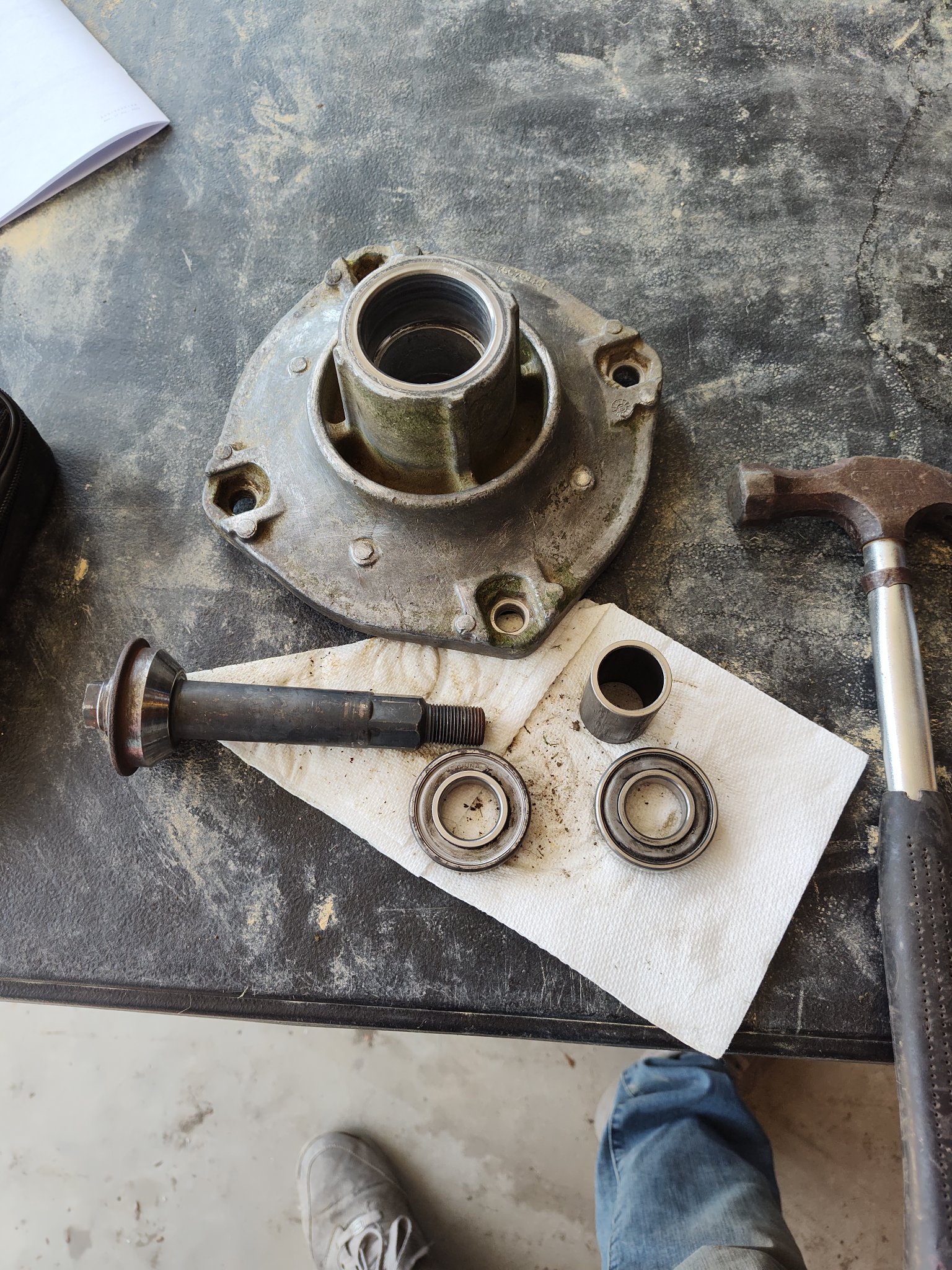

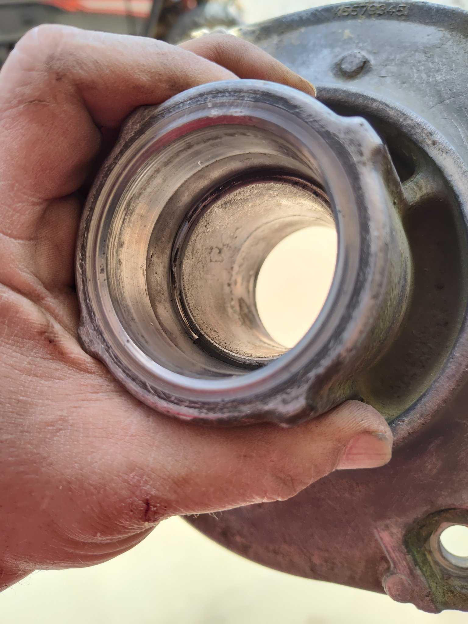

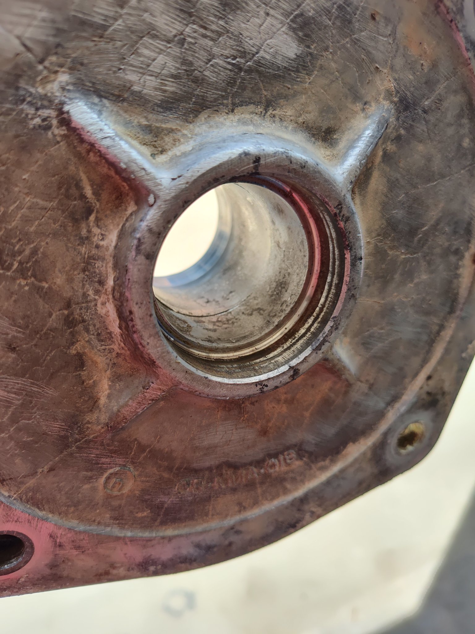

Looks like that's not the case. May just pick up a holder as a spare. Along with a couple extra bearings. Was easy to get out. Dangit, there goes my justification for another Harbor Freight visit...
IMG_20240423_112125338_HDR.jpg IMG_20240423_112121649_HDR.jpg IMG_20240423_112115249.jpg IMG_20240423_112437601.jpg
View attachment 126865 View attachment 126866 View attachment 126867 View attachment 126868
Yes, very simple spindle in your case. It uses a caged, ball bearing (and looks to have double seals) so no provision (or possibility) of being greased. When its done....its done.
Some spindles use a tapered roller bearing and race....and require you to replace the race along with the bearing and certain 'preload' applied when installing new bearings.
If your housing is not damaged.....just replace the bearings. However....I would advise doing the other spindles as well (if they look to be original).
The bearings in the other spindles can't be 'far behind' the one you removed.

I'm glad you brought that up actually. I have less than 100 hours on this mower. When I told the dealer that, they said that it was probably a fluke and not to change out the other two. Now you have me doubting myself.
"Fluke'......maybe.
I would be inclined to agree that 100 hrs. on a properly made sealed bearing is nothing.
BUT....in the picture, I can clearly see 'CHINA' on the metal seal of the one bearing, so that tells me all I need to know. Replace them all with good quality bearings and you'll be good to go for years to come.
