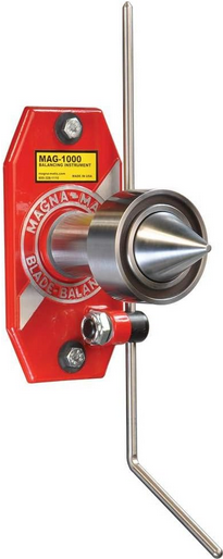

Are your blades in balance and straight? My understanding is blades should "generally" be sharpened and balanced every 25 hours, for homeowners that's at least once a season, landscapers tend to do it every 1-3 days, all highly dependent on use conditions.
(note: not an affiliate link; i get nothing from it other than potentially helping another member and have no interest in the product or company, it's simply a direct link to the balancer i own)

That’s my balancer! Since I bought my Z422-54, I went maniac and bought the balancer and an American Sharpener system for the blades. Makes it a breeze to get the blades razor sharp (although I run the grinder lightly over the finished blade edge to “dull” it slightly. I’m in the “not razor edge” camp and my cut stays consistently good all summer. I’m careful not to hit debris/roots installed a special “moving deck lift pedal” to raise the deck slightly as I mow…works like a charm as I have many roots to mow over.

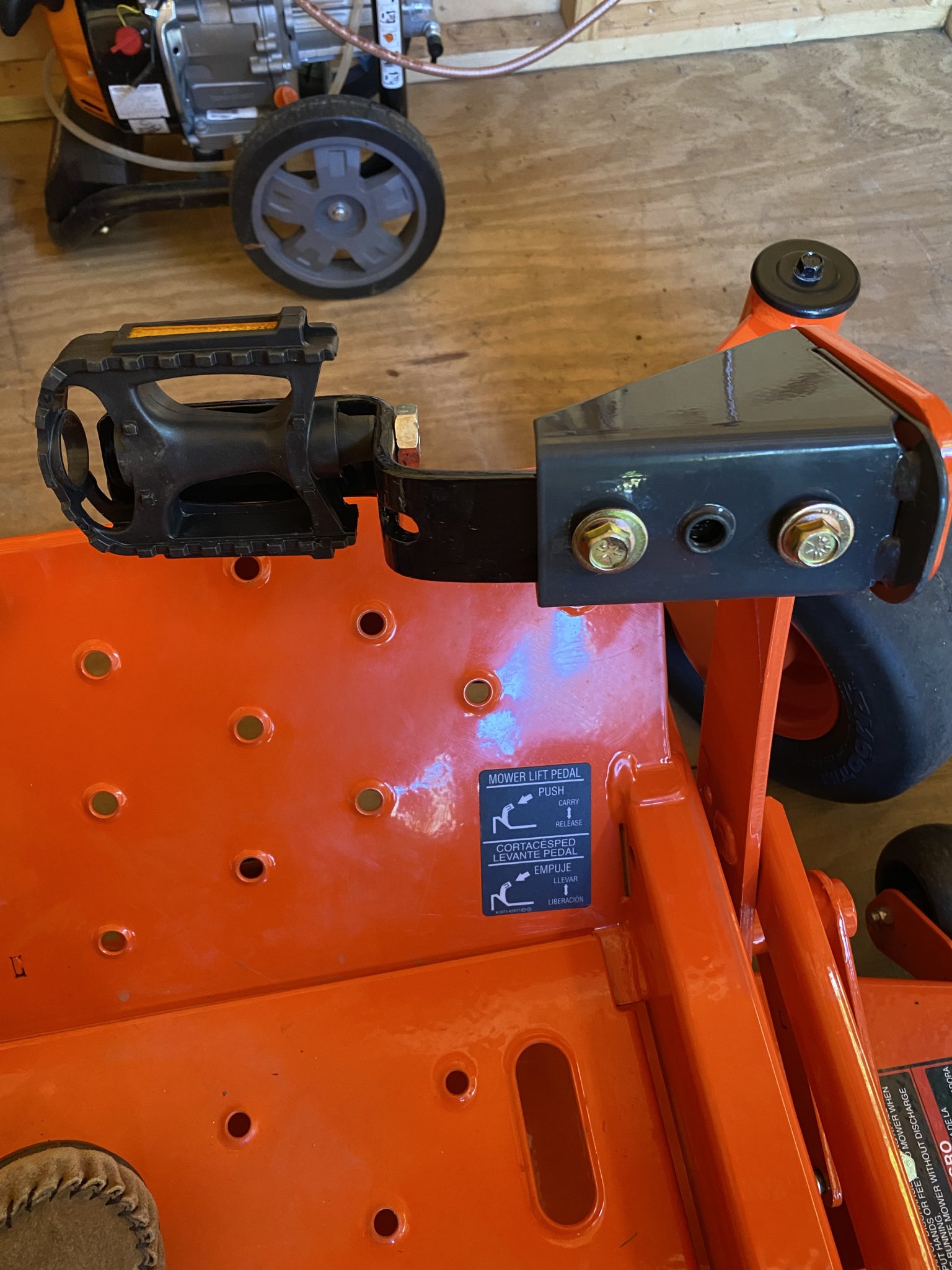

Yes, the “All American” system. I had used whatever I had in my tool drawer for flap wheels and I think they were a finer grit. I have a couple new ones for this season that are a heavier grit to try. Love the system! I have it permanently mounted on one of those old “movable” folding work tables I got from a yard sale. Here is the lift pedal I devised…
