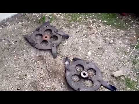

How about the Meg-Mo blades? They put a hub on each spindle with four short rotating knives. They are set up just like the blades on a disc mower, they rotate on a hub. Most all the reviews I see just say they don't do a good clean job of cutting one's lawn, and they are expensive.

I've seen Meg-Mo blade ads and would guess they have similar results to a brush hog, which "isn't fantastic" for lawns, but obviously brush hog blades have a purpose and fit that purpose well. I would guess a smaller version of a brush hog blade (Meg-Mo) would mow smaller fibrous stalks well, but not necessarily mow grass well (and likely ball tall grass up). The real-world testing videos I watched match your impression implying that's the case.

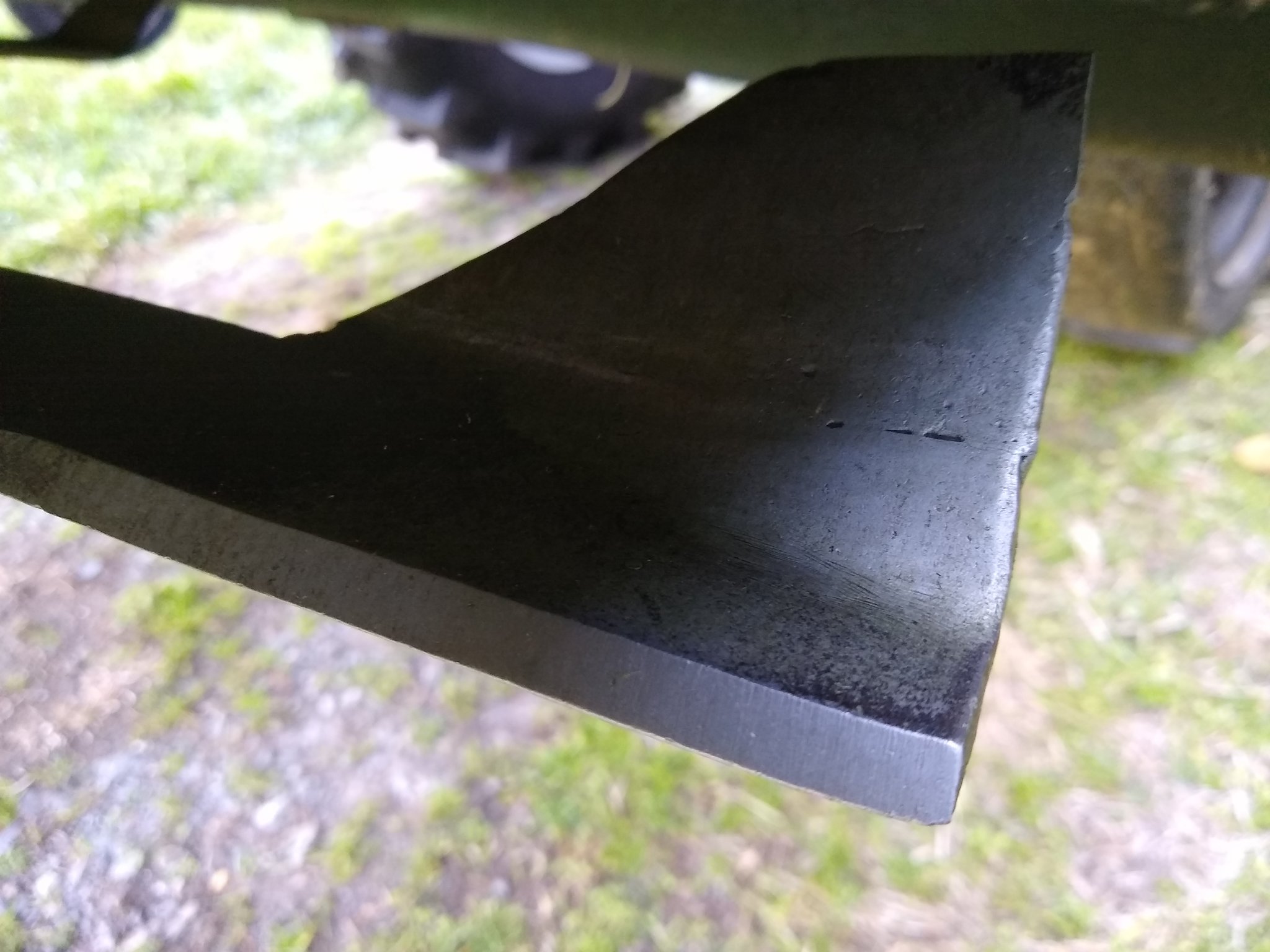

The 5' side discharge RFM on the Ford has regular blades to which I added small wings to increase air flow (pic below). The main purpose was to make it better at blowing the leaves off the yard in the Fall. It works well for that and the occasional normal mowing.

Interesting. Did you make a jig to get the same life on each blade end? Did you experiment with the angle?

I cut the add-on pieces as uniformly as I could. Then clamped them to the existing blades for welding at the same angle as the factory upturned part of the blades. Following welding, I balanced them by griding material from the heavy ends. They work well enough that I scrapped my homebrew 3-point leaf blower.

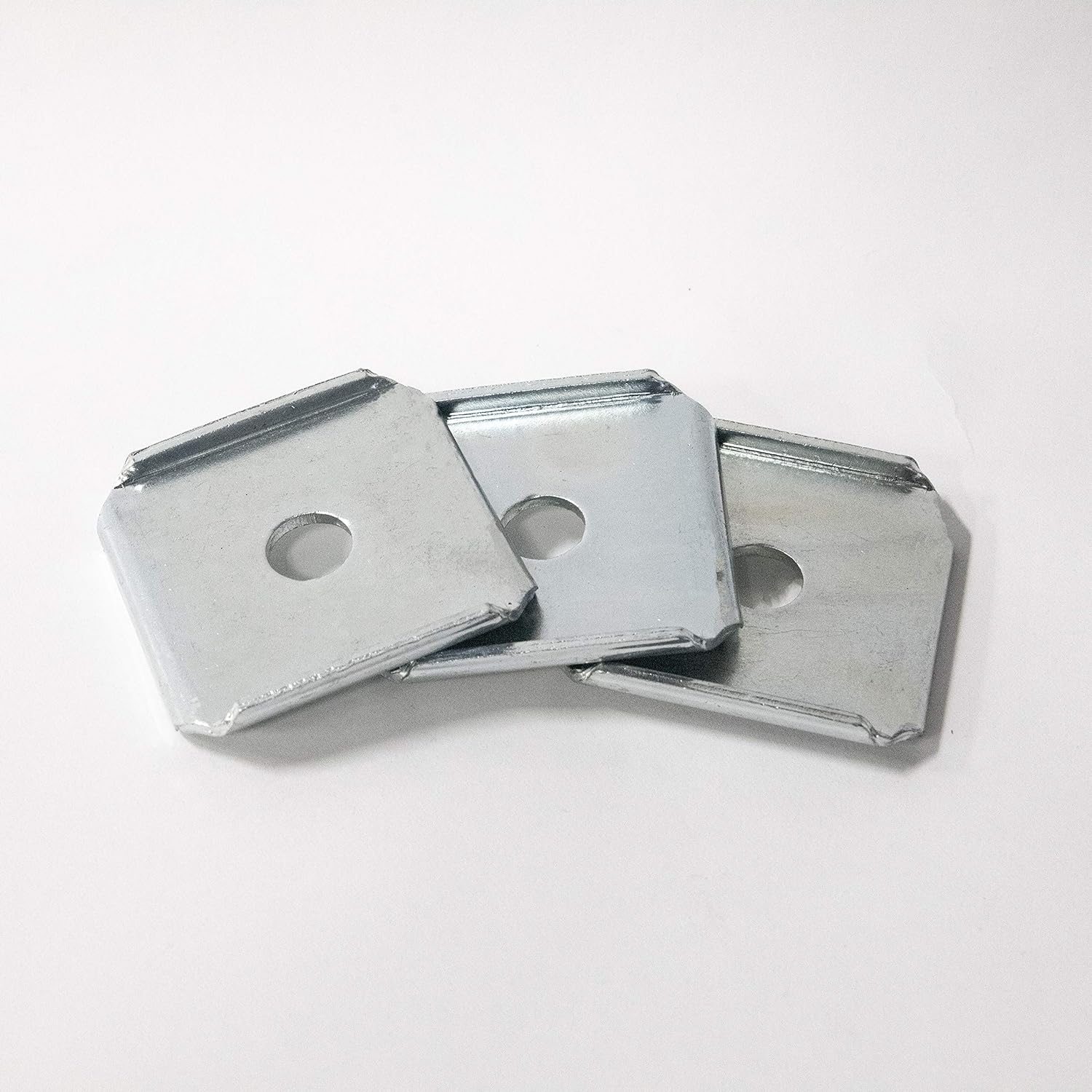

I have a Toro Titan 60” ZT mower and tried the X-blades with the adapters that were shown above. For my machine, it was too much weight and it sounded horrible starting the blades. Once spinning, the cut was great. The debris shooting out was absolutely destroyed.
I used them just one time and went back to single blades. I ordered all of the stuff from Ballard, and their gold blades are very nice. For the price, I’ll go back to Oregon G6 though.
