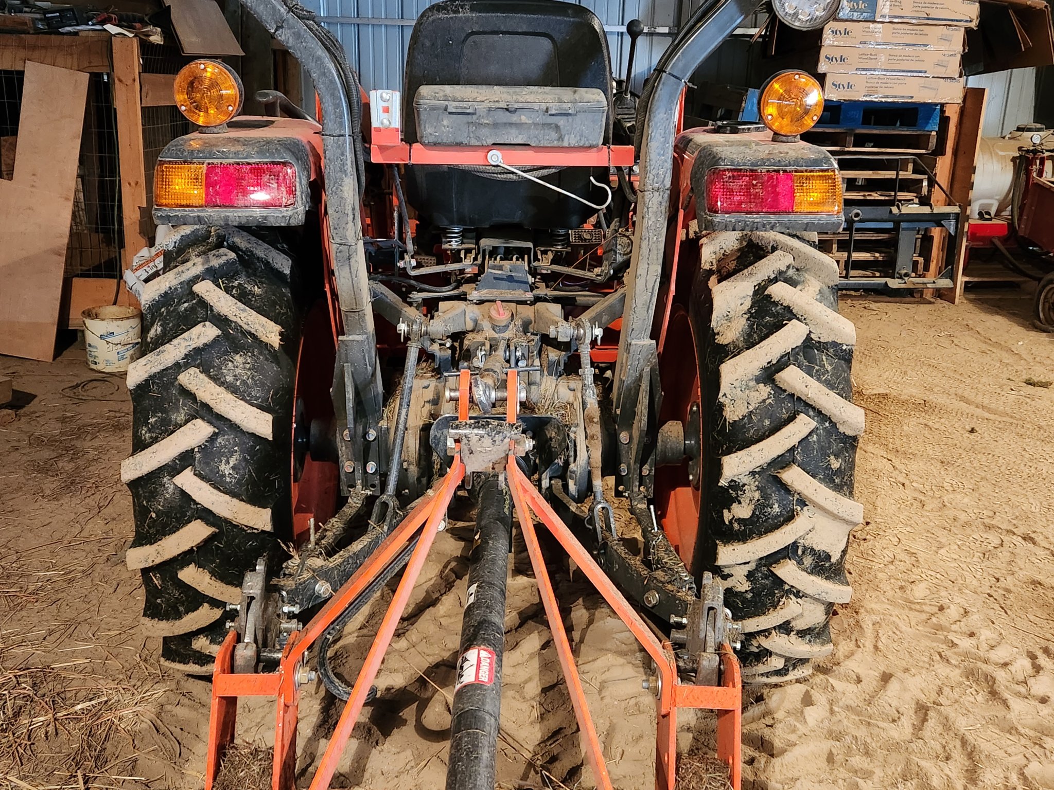

So you do have agriculture tires, R1's (and not industrial tires, R4).
How are they set up now? Can you post photos of them as they are now?

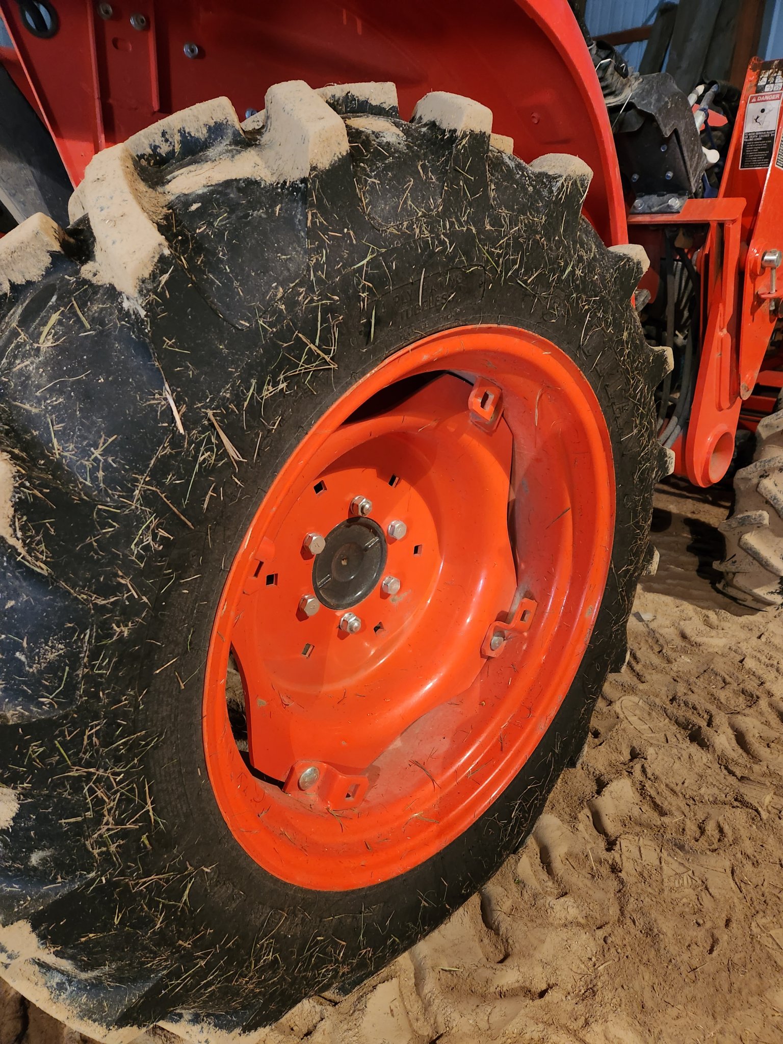

You'll want this surface (arrow in photo) bolted to the outside of the driver's side (other side). You have to have both sides, jacked up and braced.
Have you checked with a tire company as to what it would cost to swap them around with the correct equipment?

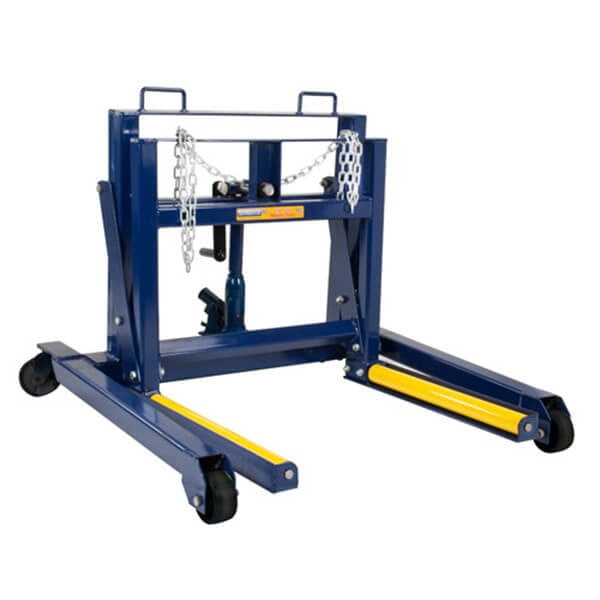

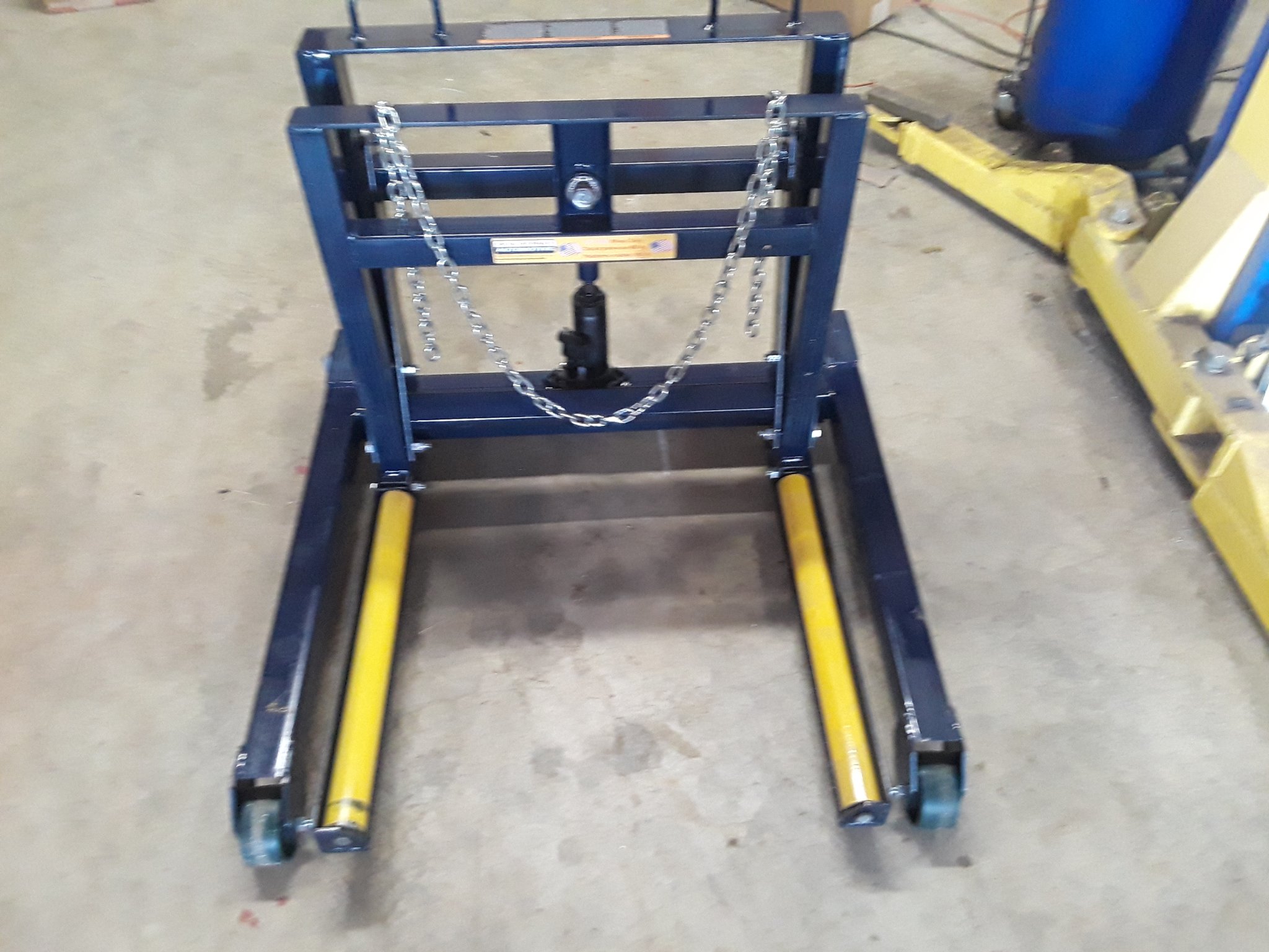

I am getting too old for this kind of fun so when I bought my L3901 I purchased a tire helper.
Hi Dan
Been trying to find a similar “tire helper”. Where did you get yours? Looks like just what I need to help flip my tires and install on the other side for improved wheel spacing.
Thanks

Hi Dan
Thanks
OttoOrange
My wheel dolly is made by Hein Werner
Hein Werner is very proud of their products and normally out of my price range but I got lucky and found this one on eBay. It was listed by a business liquidator that really did not know what it was and thought it was missing pieces. Everything was there in the pictures so I offered half of their Buy It Now price and they accepted. I think it came to about $600 with shipping.
Just do a search for "tractor wheel dolly" and you will get all manner of products. Something like the Hein Werner is close to a grand and the shipping is usually the deal killer.
