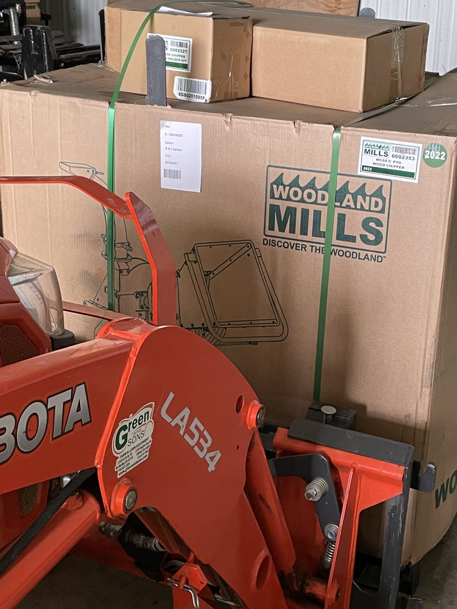

Shipping company contacted me yesterday…WC-68 to be delivered this week Friday.

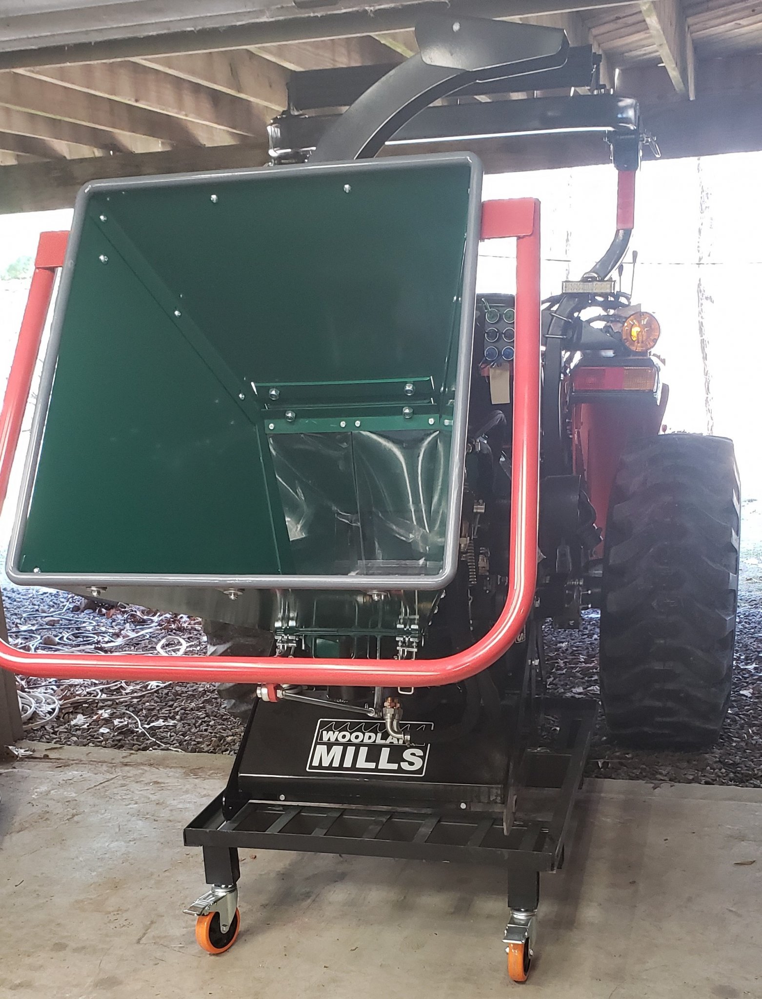

It might not be the top of the line chipper, but it does everything I ask of it and a lot more than I expected behind my little LX2610SU. I figured out that if I don’t want to stall it on large stuff then I just cut the feed rate way back. That also makes smaller chips which are better for mulch that we use in all the flower and shrub beds away from the house.
Next addition to my yard equipment arsenal may be a good sprayer to can de-critterize the chips so that we can use them near the house without creating a termite smorgasbord. Stuff Lowes calls “cypress blend “ is chewed up pallets that someone said “cypress “ within 20 miles of the grinder, and thanks to “build it back better “, they get $5 for 2 cubic foot bags. That doesn’t cover much.
You’ll love that machine if you’ve been burning the brush or hauling it off. I can chew up a pile of brush that’s 6 feet high and 18 feet wide (3 loads off my little trailer) inside an hour. Beats the hell out of my little Briggs powered 3”
Only took about an hour to get it ready to eat. Save the bottom of the crate for a dolly. Grab some casters from HarborFreight and stiffen the corners a bit. I keep mine inside the shed and wash it after every use just to keep the dust down a bit in the shed. It’s actually sort of a post-op check on the knives and bearings, but I figure it doesn’t hurt to clean it while I have it open. No point in inviting mice to live in it.

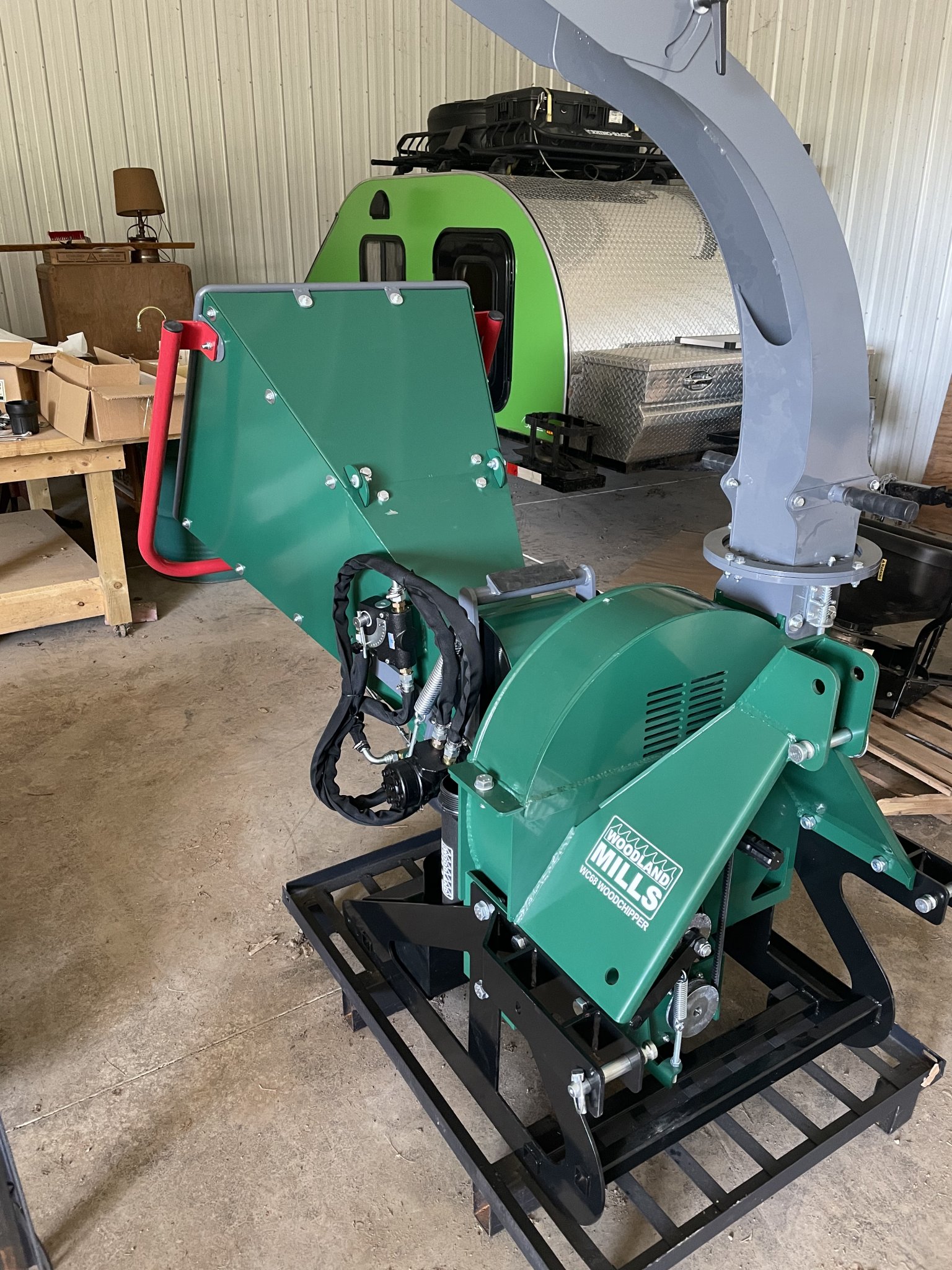

I’d like to make a confession…Forgive me orange peeps for I have sinned…I went green today🫣. Finally uncrated and assembled. Need to go to town and get some oil…little green monster is bone dry. 😉

That's an excusable green. WC-68? If so, I have it's twin brother. I have the LX-2610 tractor, so same horsepower as your B-2650. Unless you cram something huge in there (+5" diameter), you're not gonna stall that B-2650 with it. Winter to early spring is best chipping. No leaves and less sap (lighter wood) in deciduous species. Green leaves tend to be heavy and clog the chute when mixed with twigs. The WC-68 could use a little more air-flow, but it's designed to chop, not blow, and some of the movement is actually the fins on the flywheel slinging the chips as much as it's blowing them.
I've had mine about 18 months now. Before the LX and the WC-68, I was hand feeding a little 6.5 HP Briggs powered 3 inch chipper. It did a pretty good job, but that thing would beat you to death. 15 minutes feeding that thing, and you can't feel your fingers. I already have significant neuropathy from spine problems, so no telling how much damage I was doing to my hands and wrists. All I know is I had ZERO grip and hurt for a week after an afternoon with that thing. The other problem with it was the tiny 3" opening. It doesn't take much of a crook in a branch to be too big for the opening. The WC-68, though, is a PLEASURE to watch it eat up a lot of stuff that I'd have to cut repeatedly to feed to the little guy. I've got a lot of volunteer elm and birch (neither of which isn't worth a flip for firewood), and some of it's 30 feet tall and 4 inches in diameter at the base. It's fun to feed a whole tree to that thing and watch it eat. Anything over 2" diameter in oak, maple, or hickory, I cut up into firewood. I just spread most of the chips on the ground for mulch as I'm clearing the property a little at a time.
Next major investment will be a grapple. I've got WAY too much deadfall and junk brush I don't want to put in the WC-68 or can't because it's too large. I want a dump trailer too so I can haul all that stuff off to the dump. I've only recently added a culvert so I can access the back 1/3 of my property. The little LX has made a tremendous difference in the progress I'm making.

Yep, wc-68. I still feel dirty and ashamed on the color. It’s what it is. We had an ‘El Derecho’ in June. I had ordered the chipper before the storm and arrival of chipper (chipper arrived about a week after the storm did)but did not get it until after snow plow went down our road in June to clear the road. We had a doozy. I suspect I won’t have it all cleaned up within this year. I am glad I ordered it when I did as it will get some use. The packaging was awesome and the instructions were really easy to understand as well. One caveat though is the PTO shaft…I followed the instructions but to hook up and unhook, the knuckle at the implement has to be slid into the implement all the way to attach the knuckle at the tractor. Be a lot more convenient it enough slip to not have to slip the rear knuckle on the shaft to the implement for both hook up and removal IMO…makes awesome ballast though. I am a little worried about going up a steep hill with it(I have a very hilly/steep property.)
