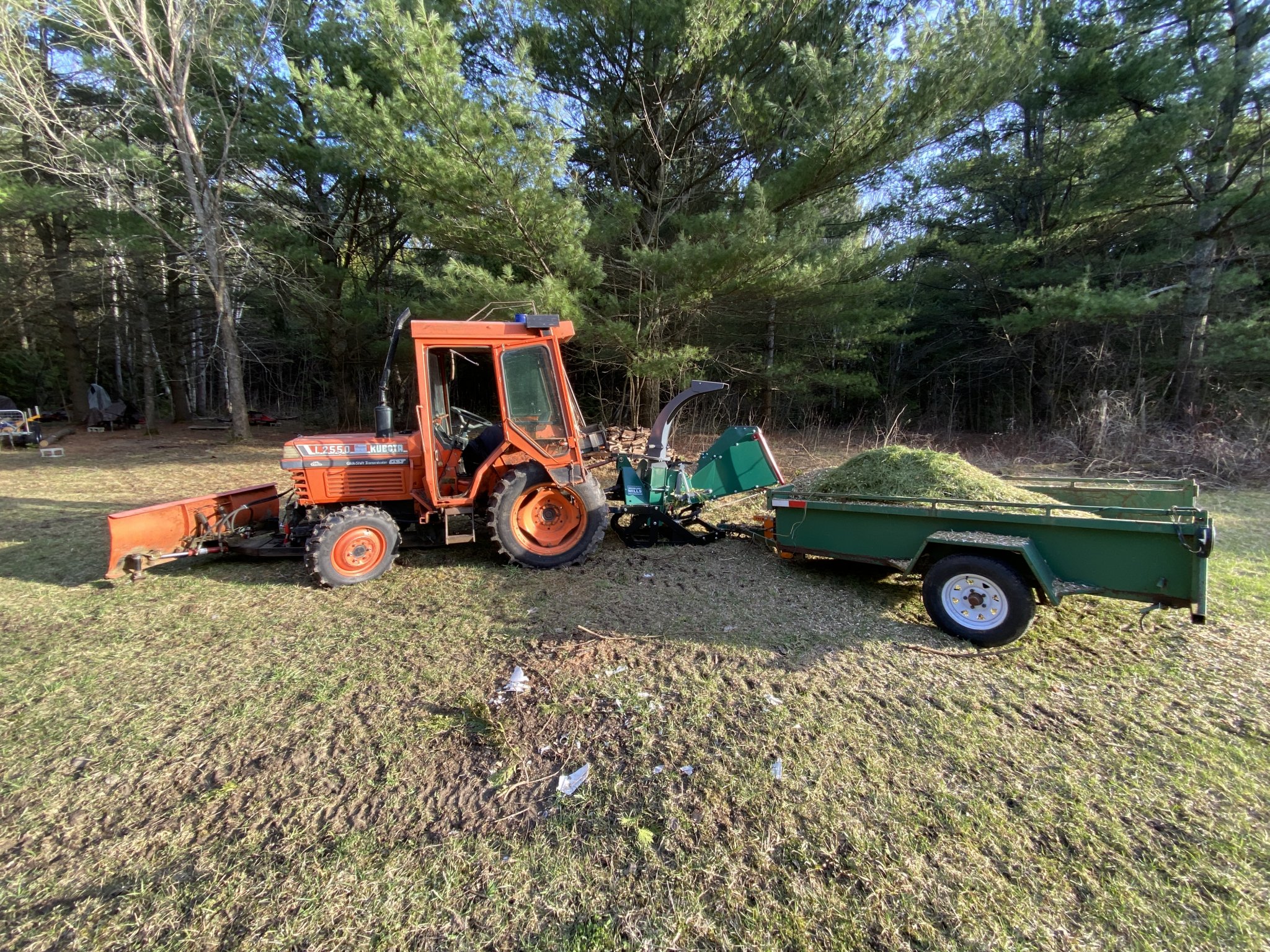

I have the WC68 for use with my L3800. It's only a year old and my guess is I have about 20-30 hours of real use. No complaints so far. I don't chip anything over 3".
Last summer I cleaned out a large section of wooded area - both deadfall and trees I took down. Mostly oak & maple.

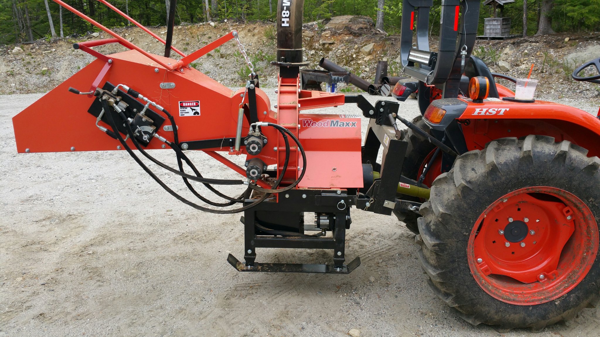

I have the woodMaxx and will be using it soon to chip a bunch of brush and trees. I bought it becouse it is self contained. As I have no rear hydroilics. The feed works great. I have tried to feed it with the feed in reverse and it dont feed so well..lol but chews thru whatever to stick in there. It is big and heavy.

I have the woodMaxx and will be using it soon to chip a bunch of brush and trees. I bought it becouse it is self contained. As I have no rear hydroilics. The feed works great. I have tried to feed it with the feed in reverse and it dont feed so well..lol but chews thru whatever to stick in there. It is big and heavy. View attachment 78870
I like that lever to raise the feed roller. For the WC46, I take the floor jack with us in the FEL.
That is correct. Especally sometimes the feed won't pull in branches or a log or it wont grab it enough to pull. Moving the roll up and down will start it going.

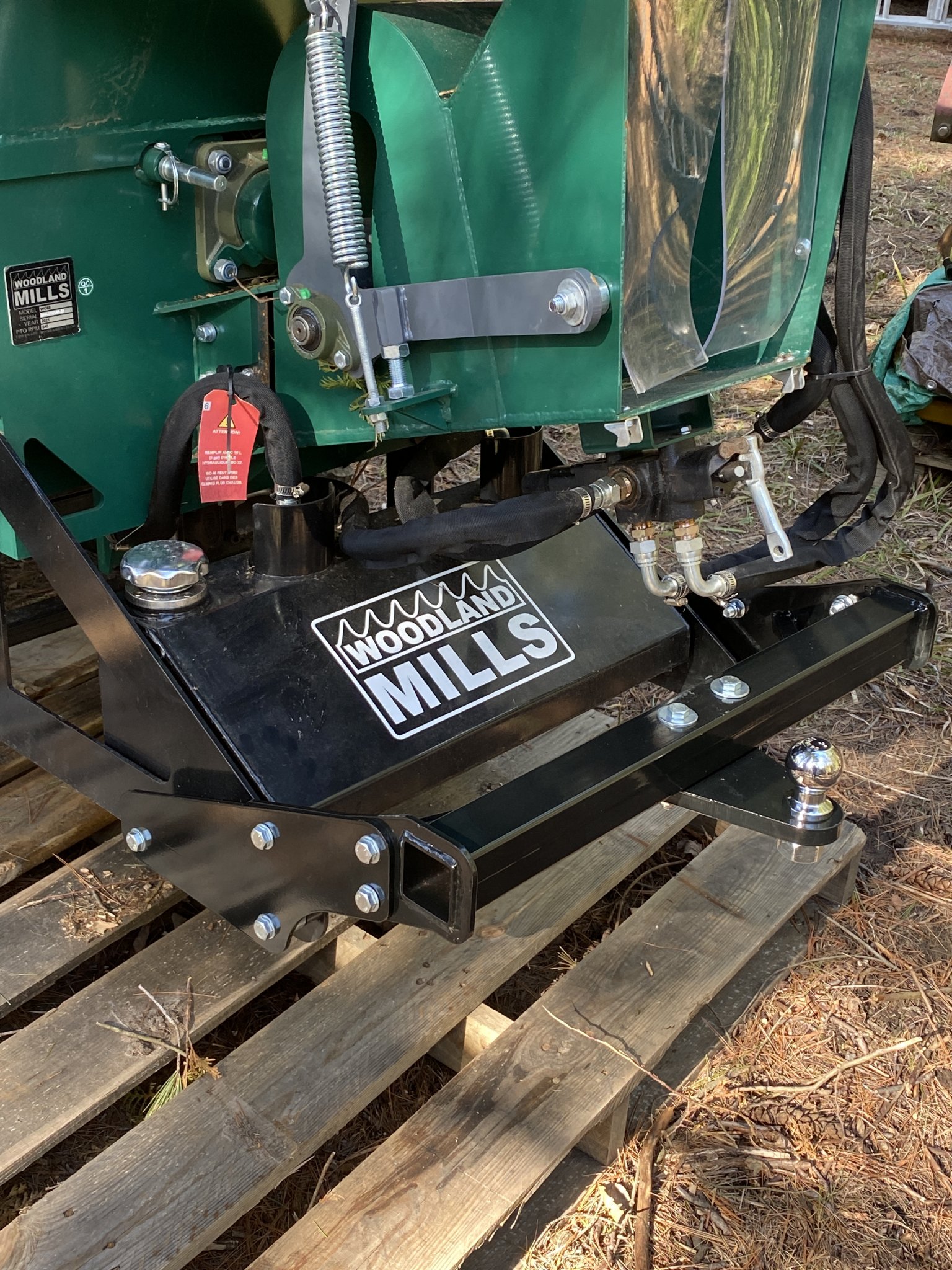

Good day. Is the trailer hitch a trip hazard when operating? Would you add it all over again or is it in the way of where you would naturally want to stand when feeding the beast? Thanks.
3,192
5,273

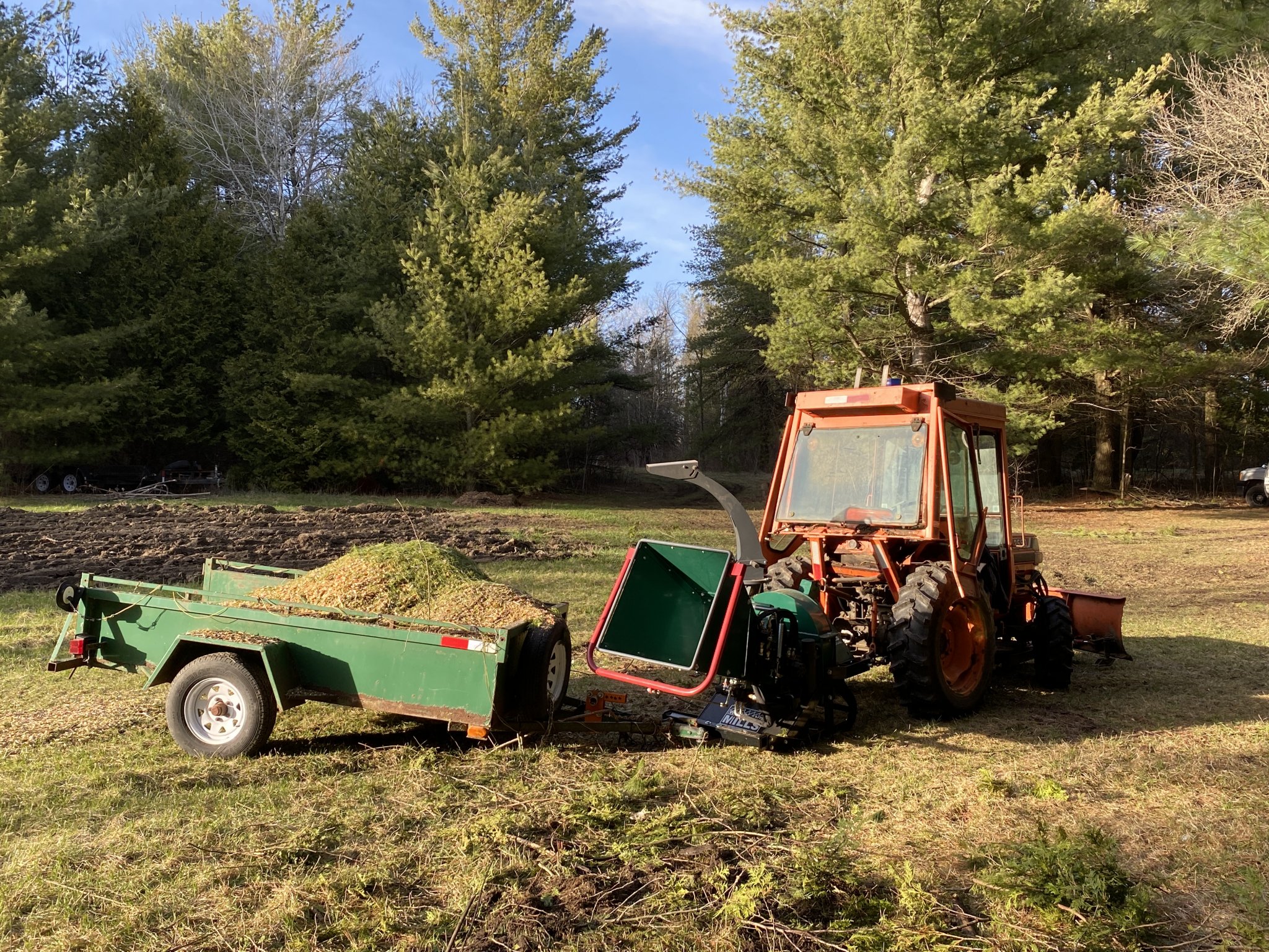

I have the WC-68 with probably 60 to 70 total hours on it between me and my brother I share it with. So far it will chip anything that fits through the feed chute. Most stuff has been 3” or less but have had things up to at least 5” with no problems. I have yet to do anything in the way of maintenance other than grease it routinely.
Had the discharge chute clog several times chipping green sappy evergreens until I figured out the cause was operator error in not slowing feed speed for sticky stuff such as that. Have not had one clog since.
Woodmaxx is probably a good machine, just don’t have direct experience with them. Nothing but good things to say about the WC-68 and Woodland Mills.
