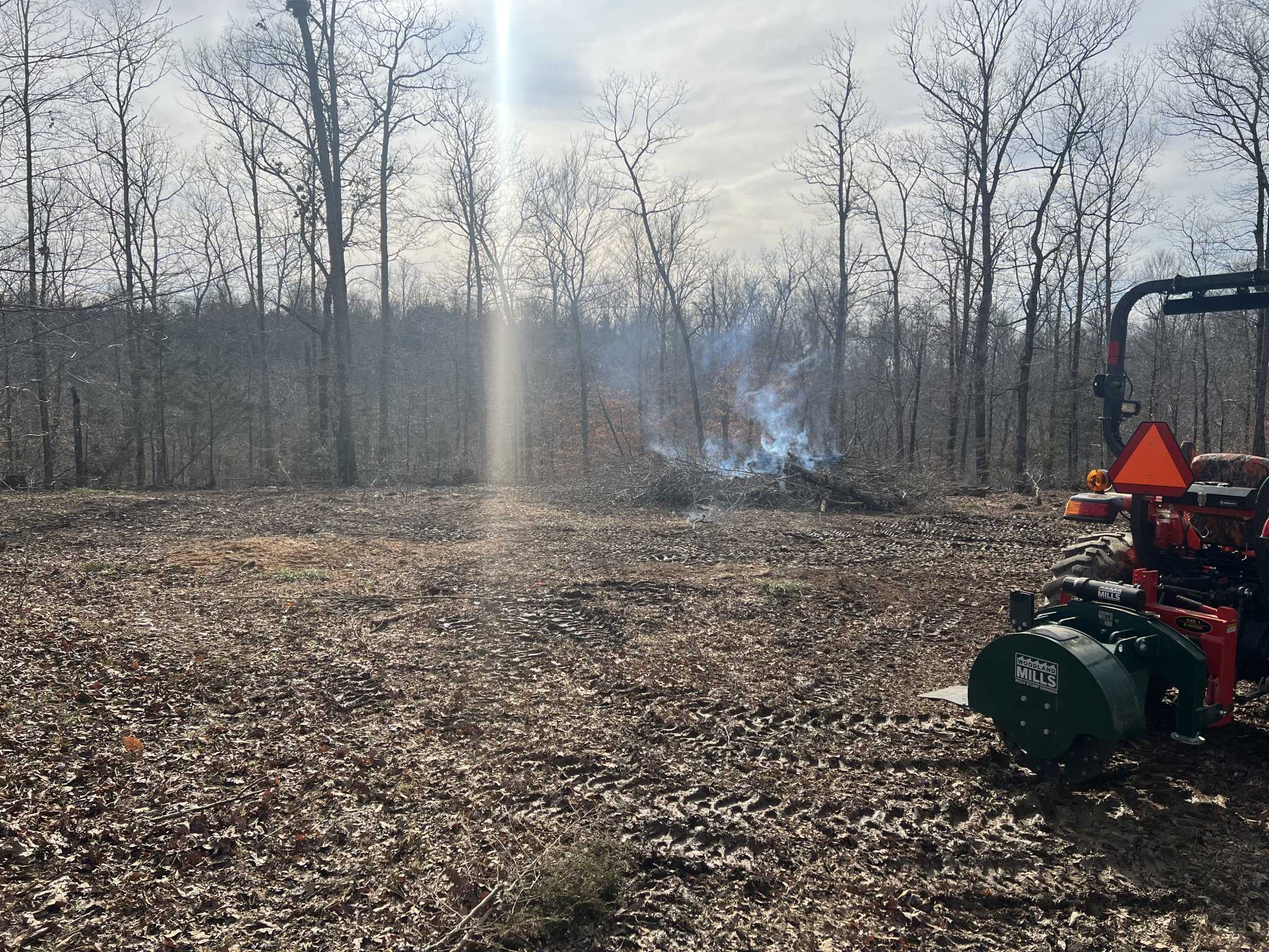

just finished clearing about an acre + food plot and ground all the stump about 3” below grade. Only problem I had was about 4 teeth were broken from rocks. Probably 60 plus stumps. Hickory and white oak.
