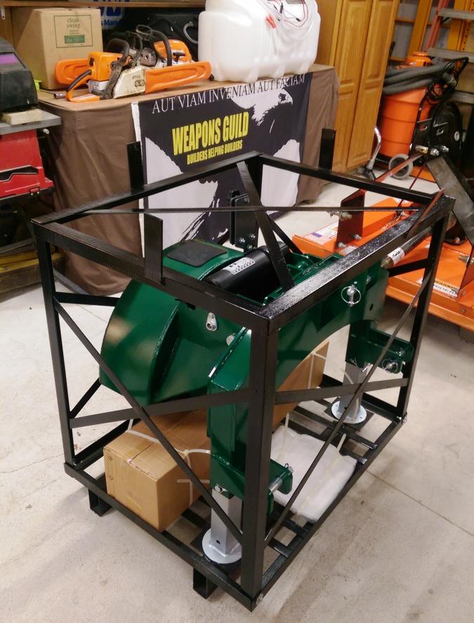

here is what it looked like before i got it off the crate:

it did weigh in at close to 500lbs on the crate & i did take it off the truck with my Titan pallet forks on the FEL.... which BTW still work perfectly even with the Piranha Tooth Bar still on the bucket. was wondering if it would make any difference at all on using the forks & it did NOT. what i did notice right away was that the loaded rear tires made all the difference in the world about keeping me on the ground instead of the reverse wheelie i had happen when unloading the woodchipper.

Whats the poster on the bench for?
you mean our WeaponsGuild flag? Thats our Weapons building site. WeaponsGuild.com after my wife & kids its the #1 thing i do. (build guns) THEN my tractor. :)
have those in several locations around benches in my shop.. they serve dual purposes. :)
1. they are a great flag we had made.
2. they "hide" everything under the bench out of site
it wasnt intentional to have that pop in the picture but its hard to take a pic anywhere in my shop without them being visible.
