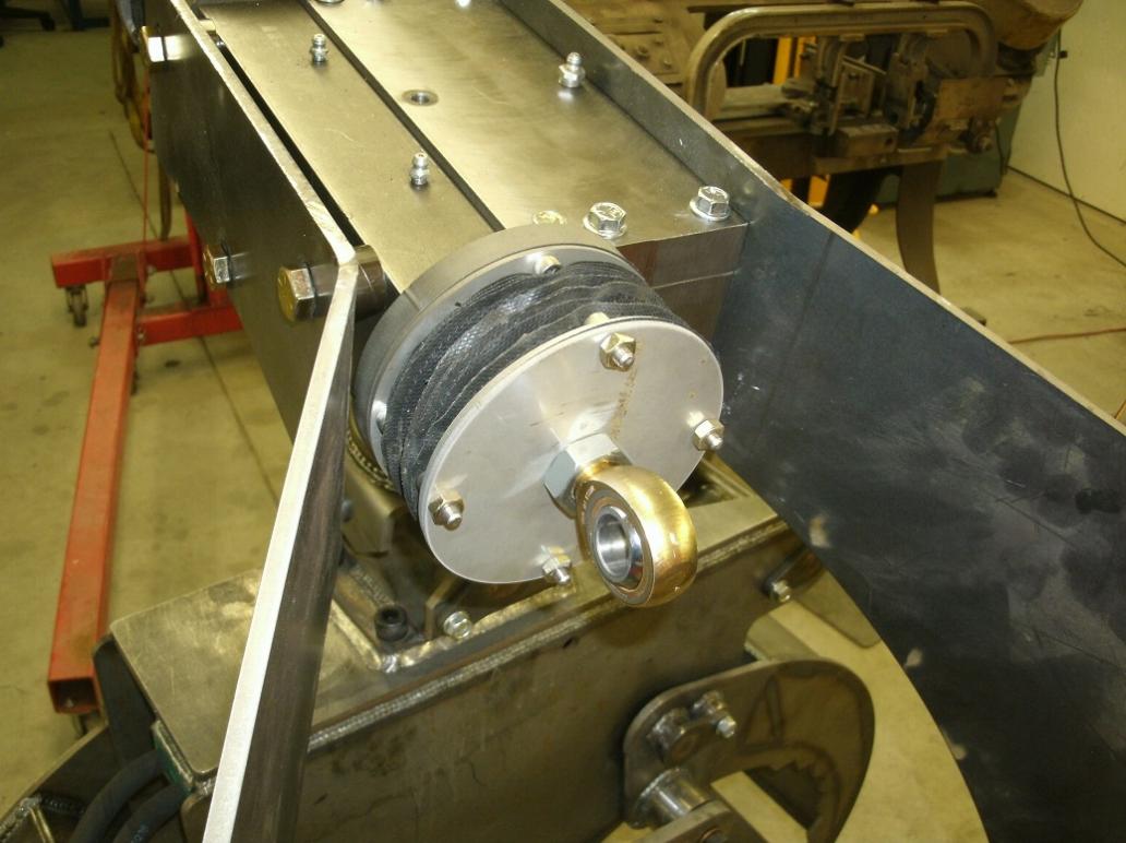

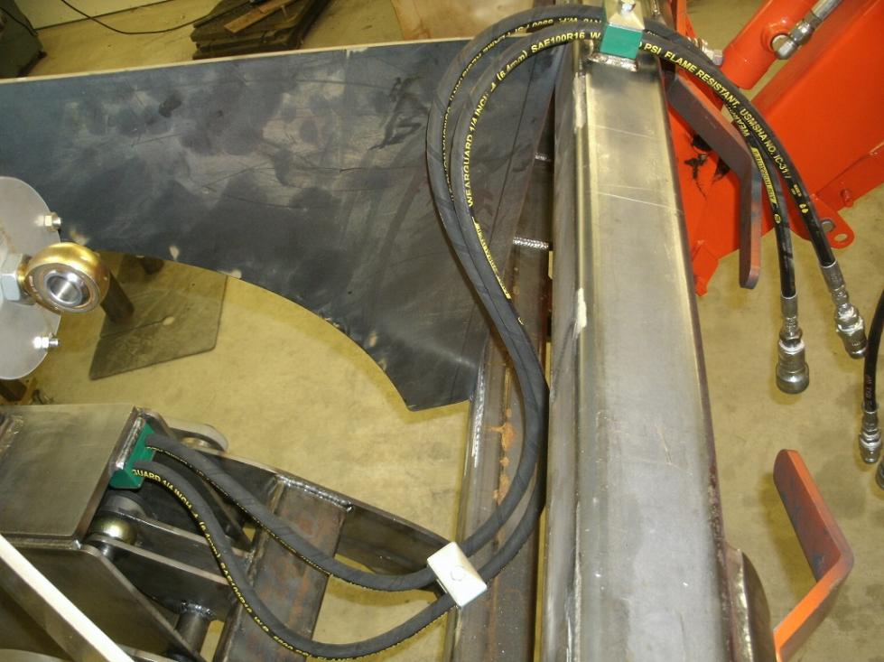

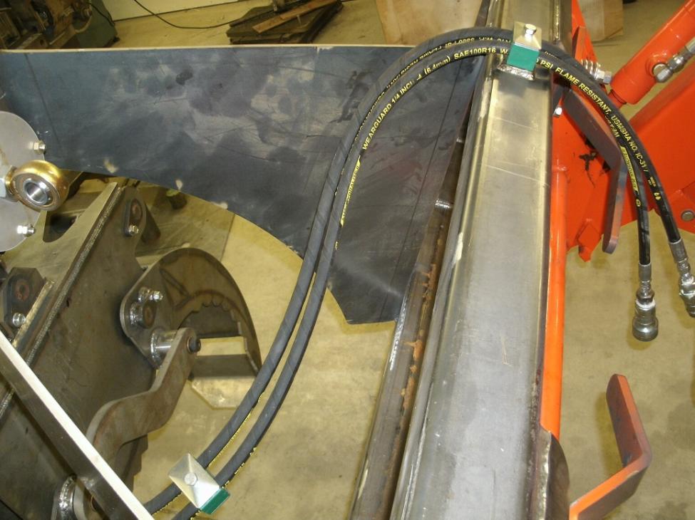

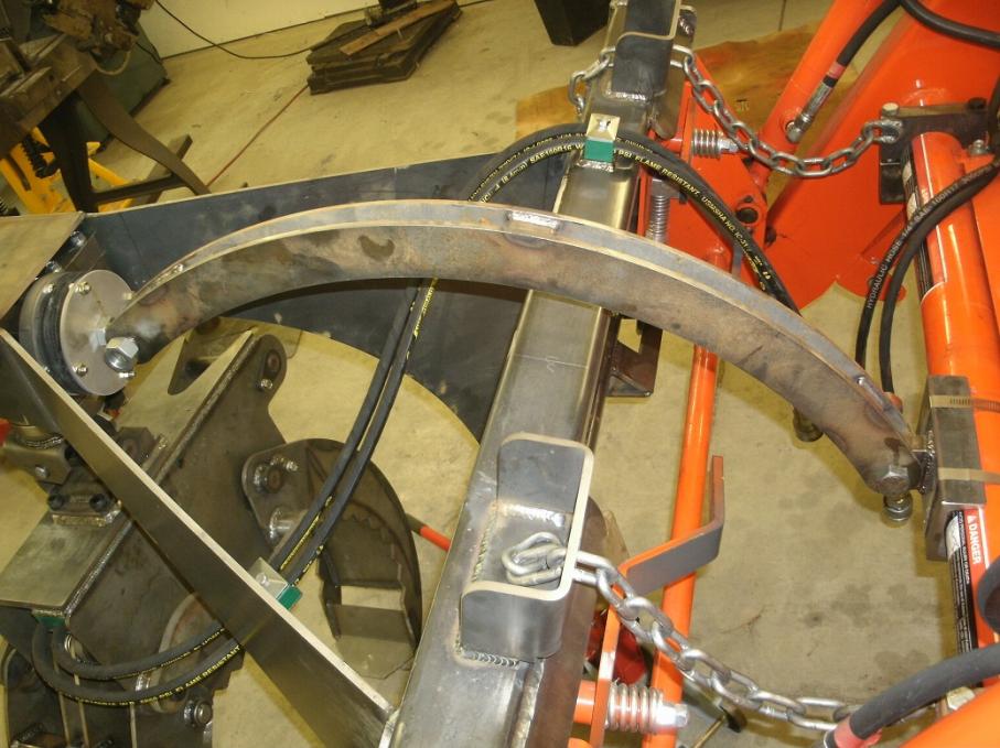

Made a new linkage that goes over the top of the ssqa. Reason being is the handles for the ssqa latch were in the way if I went underneath. Also made up the chain stops to limit how far forward it can curl.
Going to put it through some more sea trials this afternoon and if it passes, disassembly and paint!

Well, it passed the test. Could have been a few inches further out. Would be nice if the rotation were run by hydraulic motor so you could spin 360*. But, for a build that had one of the goals to use up what was laying around, I'm calling it done. Disassembled and welded up a few things that I couldn't get to earlier. Off to powder coat we go!
