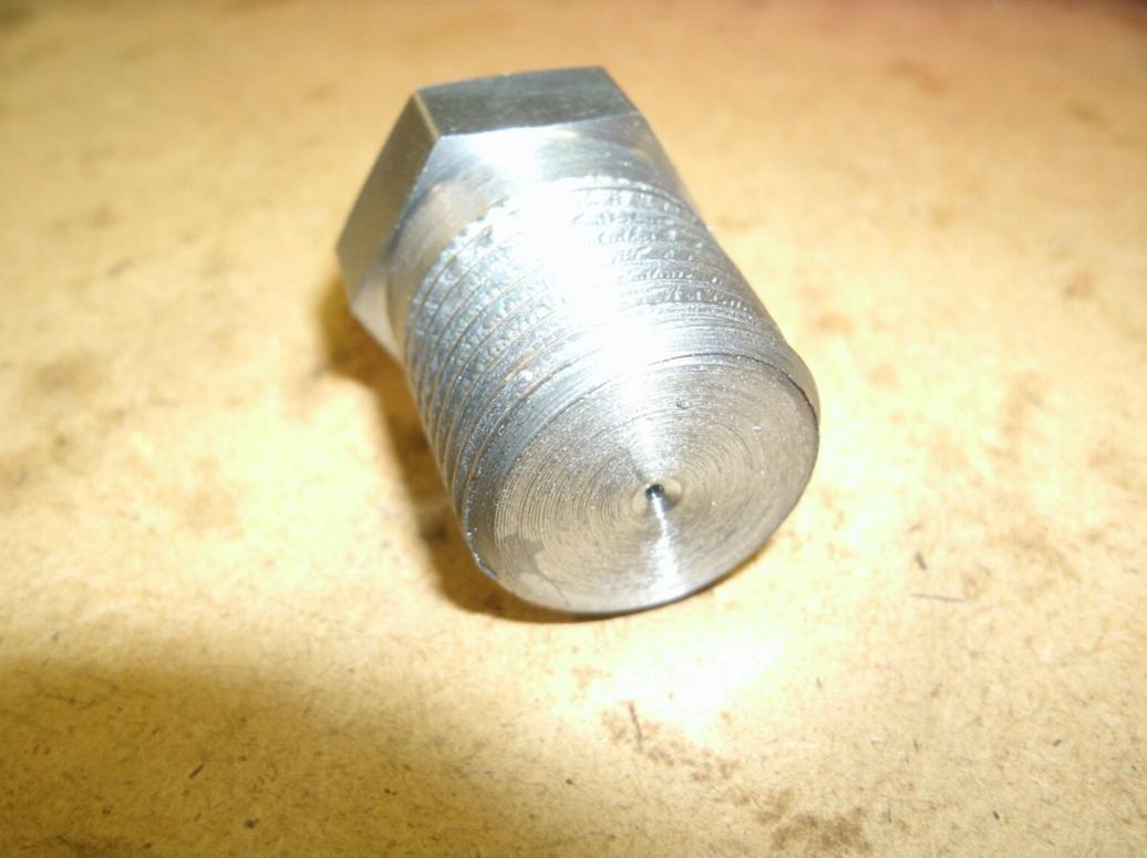

Cobbled up some linkage for my original idea for rotating the grapple. Also machined a restrictor fitting to slow down the hydraulic cylinder. Drilled the hole to .040".

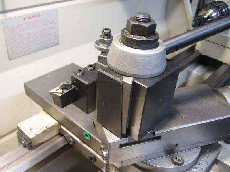

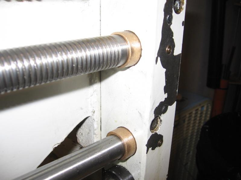

I'm loving it, thanks for asking. The minor problems with the cross slide are now history. (@zero cost:)) It now has a quick change toolpost with 9 tool holders, added a shelf for tool holders, replaced to tailstock spindle key to remove play, changed oil in gearboxes, some oiler buttons replaced. Also tracked a high speed vibration/noise to the outboard ends of the leadscrew & feed driveshaft: the steel shafts were spinning directly in a cast iron block, which was worn. Bored the block out for two 1" oilite bearings, then bored those to fit the shafts- smooth as silk now.
Very, very nice! I like the way you've got your tooling within arms reach.
Let me guess, your having fun?
