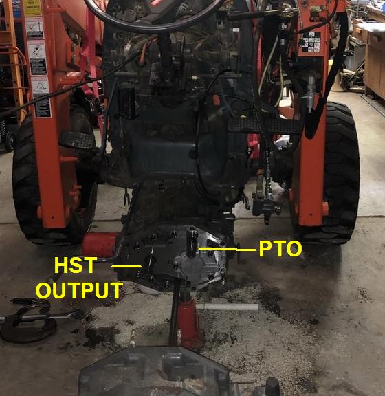

Since it’s a hst there is only one input shaft on transmission.......
There are really TWO power shafts from the engine going in the front of the HST - one drives the HST, and the second one runs in a tube through the HST unit, continuing rearward to drive the pto. All Lxx10 models have gearing in the clutch housing driving these shafts. Some of the power goes through the HST (a variable-speed reversing coupling for the driving wheels. The rest is for pto equipment.
That said, when an HST tractor stops moving the cause might be as simple as a disconnected linkage (most common) or it might be something more serious inside.
Hope Linder Mountain will tell us more about tractor hours, owners, how long, how did tractor operate right before it stopped moving. Any major repairs? Any noises? Is there any motion at all in either direction?

Part 5 in the pic above is the gearbox where the pto shaft is driven. Pic below shows the second shaft (upper right) coming thru the HST above the charge pump
