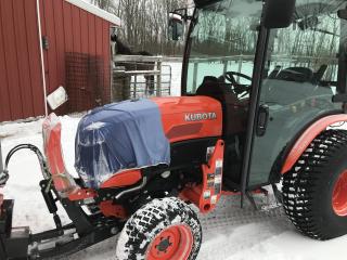

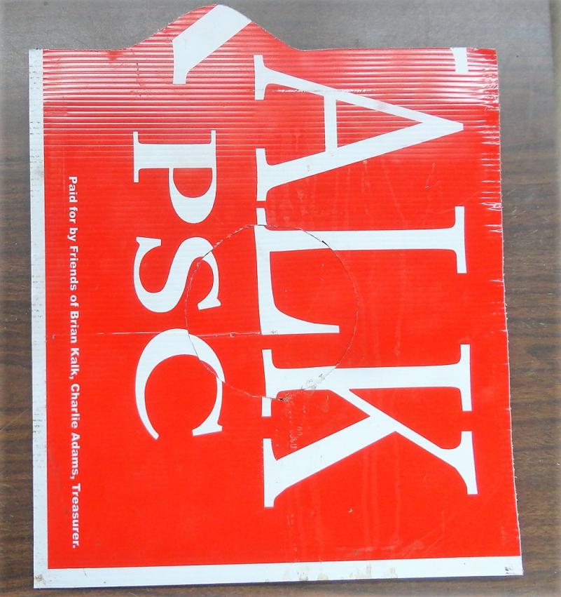

Looking for something readily available to partially block off the front grill a scrap piece of plastic window vinyl was taped to the grill’s outside surface. So now we have the complete plastic carboard insert in the radiator screen slot and the front of the grill area blocked off. Now, intently watching the temp gauge, its back to the race again. Idling outside, the temp flickered to the first segment (hey, progress! Or should I say “Hay! Progress!). Pushing snow for a few minutes brought the temp up to 2 segments and when loaded harder with the blower I might have seen segment 3 flicker on once or twice. (Now we’re getting somewhere). I tried removing just the radiator screen plastic insert and the cold conquered the engine’s heat again and back it went to 1 segment and less at a fast idle. Okay…..that’s good to know also. In its stall with the diesel feed bag on its time to think about the next step.
Getting braver now, and with the powerful steed chomping at the bit to get going again, some painters tape (easy to remove) was used to cover the side openings & perforated vents on the hood. Out on the track and again watching the temp gauge closely it nicely warmed up to 1 and flickered on 2 segments on the gauge. Much better. Engaging the blower and working it fairly well raised the temp to indicate 3 segments. We’re almost on the last lap and nearing the home stretch now, ladies and gentlemen!! I pushed it quite hard and couldn’t get the display to register 4 segments before I finished with the snow removal. I let it idle for a little while and it cooled down to the 1 segment and it went back into the stall. In a few checks I put my hand on the oil filter and it was quite warm but you could still leave your hands on it. Both hydraulic filters were warm but not nearly as warm as the oil filter. Let’s call it a tepid temp. The most important observation was that the pto rpm was now functioning normally again.

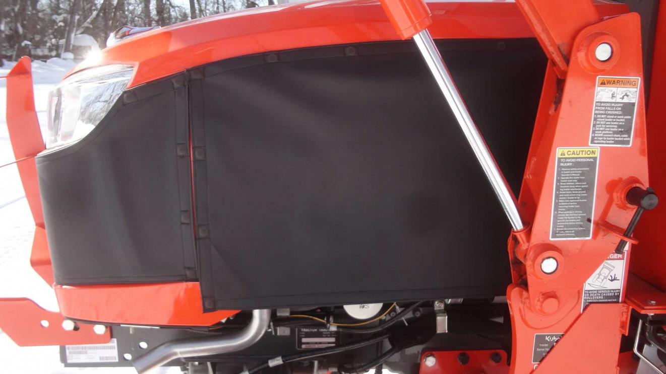

Now it was time to ponder a final solution for these cold weather operations. The “solution” should let the engine warm up nicely in the starting gate. It also should be flexible enough to allow for the temperature swings up here in the north’s winter which range from colder than -20° F to +30° F. (a 50° F temperature swing). It also should be easy in its application and easy to change in an up or down temperature swing. Last but not least……It should be worthy of being worn by the purebred Kubota mechanical steed and look like it was meant for the breed. (In this case, the B2650)
The first part was already done. The corrugated plastic cardboard was fine as is unless one finds it in Kubota orange. The next step was to design something that would follow the curves of this great steed, making it look good, yet be easily adapted to changing temps.
I started by making paper templates of the areas that needed covering. Trying to get a flat piece of paper to follow what appears to be a straight line on a curved surface just isn’t all that easy. Trying to follow a curved line on a curved surface with a flat piece of paper is a little worse. Trying to combine the two was frustrating at best. So frustrating that during a break I skipped the oat bag and went right to some malt barley in liquid form. After a few pails full, and unable to draw a straight line, suddenly things started to look pretty decent when placing the patterns on the tractor. It took quite a number of tries and adjustments to get something to come out just right. Yes! Finally! (Fist pump) Cold beer solves another problem!

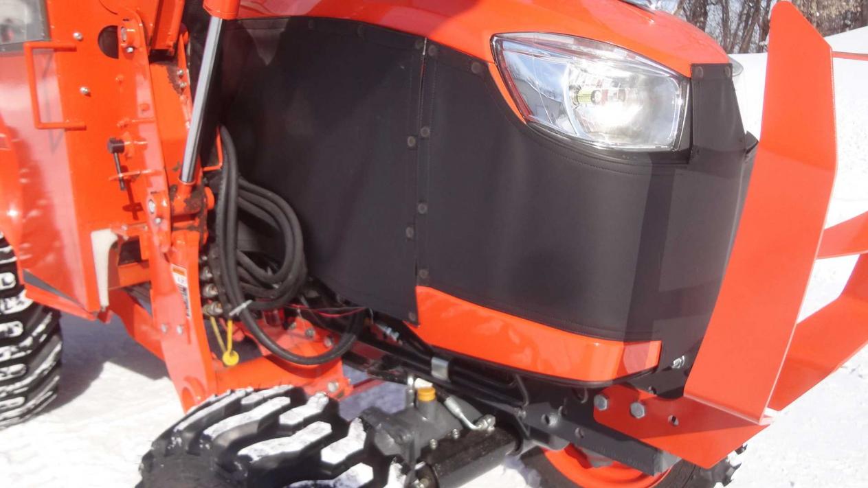

I hoped the easy on/off requirement could be met by using magnets sewn within the hems of the individual pieces. More beer said this will work. I decided on 3 patterns to separately cover the front and two sides of the hood. This would allow four items (when including the plastic insert) to be manipulated to help control the engine’s operating temperature. Some leftover brown naugahyde served as a working prototype material. There was enough to make the front and one side piece. Dragging out the old singer sewing machine (no beer allowed) produced two somewhat ugly but acceptable prototypes (after many setting changes and different techniques) for some trial runs. The diesel feed bag was offered to the steed for the next snowfall. It soon came with some nice cold temps to boot. Perfect!
Here's some pics of my trusty 'ol Singer sewing machine and working on
the prototypes:
Another -20° F. something day and a heavy snowfall. With the plastic insert installed in front of the radiator, in addition to the front of the radiator grill and one side of the hood being covered the steed was turned out to warm up. In little time the temp raised to a nice on/off/on 1-2 segments. Out of the gate and blowing snow raised the gau3ge to 3 segments and I don’t believe I saw it go any higher. Pretty pleased to be able to operate at midrange temps at an easy pace. This started me thinking that now installing a heater in the cab might be possible with the temps as they are. The patterns and prototypes were tweaked, cut and resewn till they looked pretty darn nice. And figuring if the temps could get to midrange in the real cold weather all that was needed in moderate temps was to start removing the appropriate pieces. The finish line is just a few furlongs away now. Can almost hear the crowd cheering.

Off to the surplus store and found waiting on a roll was a nice soft black almost satiny looking piece of Naugahyde. After figuring out the economies of scale prior to the purchases I bought the black fabric and ordered the other materials needed. This would either allow for some unforeseen mistakes or have some extra pieces/sets for someone in need. The goods quickly arrived and I put together the first set for a trial run. Here’s what I came up with. A 3piece weather front kit sewn to nicely follow the lines and form of the tractor’s hood and grille. Neodymium magnets were sewn inside the hems so the pieces attach and remove without any tools and in less than a minute each. Since the magnets are inside the hems there’s nothing to scratch the paint and they’re extra easy to adjust and shift into place. A gentle tug will lift them free for proper placement or removal. After using the first set for a couple of weeks the pieces have stayed right in place and don’t wander around a bit. Success. Here’s the pics:

In the coming weeks it snowed a few times, was very cold, and even warmed up a little for perfect testing conditions. When it was extremely cold, well below 0° F, all 4 pieces installed worked as intended and the operating temp showed midrange when blowing at a casual pace. With the 3 weather fronts in place I also noticed that now any snow on the hood top would melt and run off, indicating that there must be enough warmth under the hood to prevent any fuel gelling or hydraulic flow slowing down. Again, the actual filter temps were the same as with the prototypes on. Warm to the touch but not too hot by any means. Hydraulics functioned perfectly. The gauge would indicate 3 and sometimes 4 segments if engine loading was high.
Another day, when the temp was above zero, the fourth segment appeared on the gauge. If I pushed it pretty hard the 5th segment would display. Removing the plastic insert brought the temp down to midrange again on this warm day. (This use of “warm” is of course subjective.) Removing one or two side panels lowered the temp way down again so I put them back on. It’s sure nice when a plan comes together and works like planned. Now if only there was a way to get engine heat into the cab. With the muffler under the tractor in front and before sealing up the floorboard area, in certain conditions I smelled a whiff of exhaust inside the cab. I decided to opt for plumbing in an auxiliary cab heater instead of trying to direct heat from under the hood inside. That sure solved the cool cab and cold feet problems. With tractor under load this pic shows the aux heater core temp where the coolant enters the core.
Tractor temperature gauge was reading midrange and with a coolant temp of 168° F in the heater core that seems like a good match, right? That would also mean my oil temp is just a tad higher at this point also. I think the mechanical steed just crossed the finish line!

Now that this winter front setup has been in use for over a month of varying temps its performance has met the goals hoped for earlier. Maybe even exceeded them. Depending on the temps and how the pieces are used together the preferred operating temperature can be maintained just about anywhere in any outside temps. (Maybe this mechanical steed has some Alaskan Malamute or Husky in its genes?) The one caution to heed would be to carefully keep the weather fronts away from any metal dust or shavings as those magnets are strong. Since they’re fully enclosed in the hems, they should be easy to keep clean of any metal shavings if dropped on the floor or placed near some metal dust, etc. But if unnoticed that could dull the paint when in use. Best to watch and keep them clean. As of now I have a couple of extra sets sewn up and ready to go if anyone is interested and I can figure out how to do that without getting into trouble. Don’t want to get into any trouble this early in the game.
