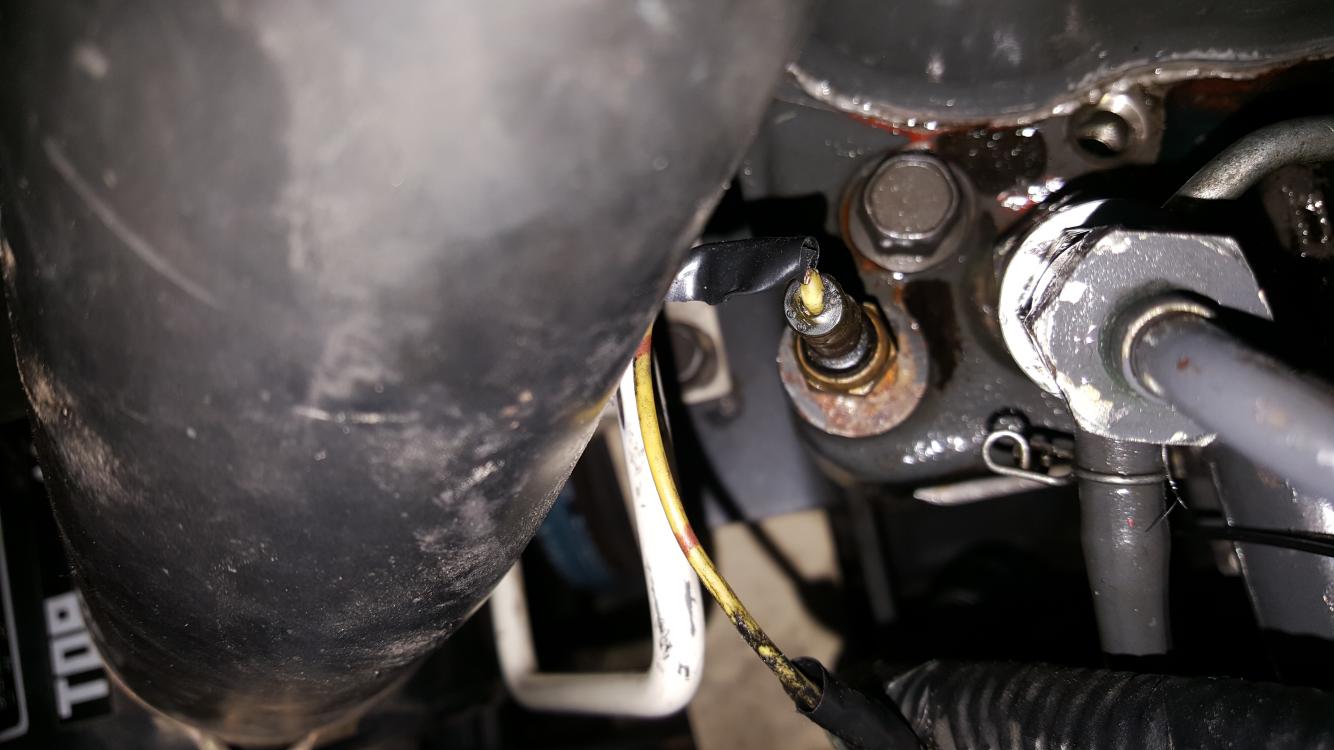

There is a thing that screws into the engine head with a wire that I twisted and it got shredded a bit and I'm wondering if that might be why the glow plugs aren't getting power.

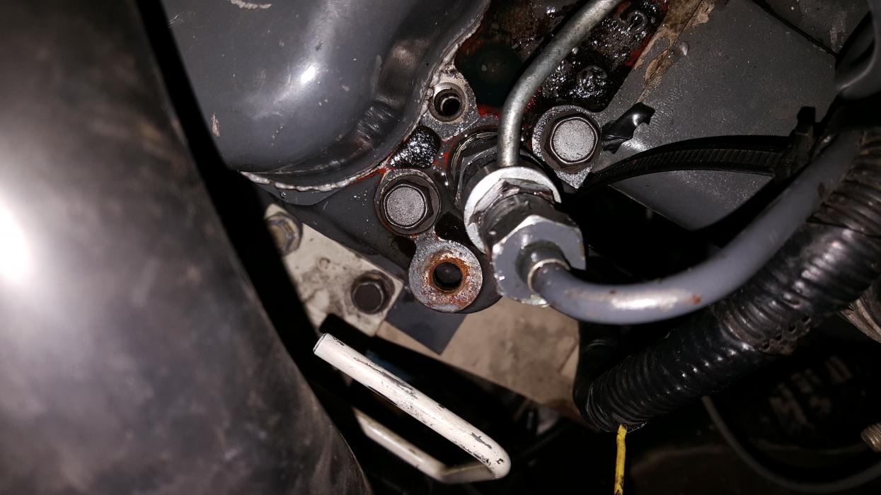

"an someone tell me what this is for and that it's called? Its screwed into the head and the wire is frayed. In fact while messing with it the wire literally broke in half."
that looks like a water jacket temperature sending unit. Not imperative for operation nor starting - but nice to have if you need water temps!;)

Sending unit, probably water temperature. Nothing to do with glow-plugs.
