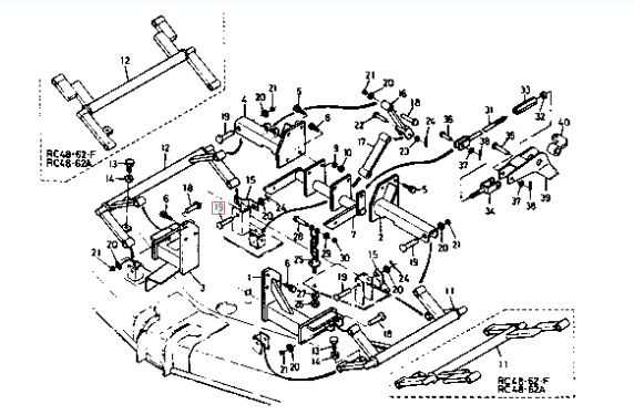

I think you might be mixing things up....
You have a B6200E which called for a RC48-62F or RC60-72
The 8200D called for a RCB60-1
If you have a RCB60-1 deck for the B8200D, the driveshaft should already face the front of the tractor for a crank driven PTO, so no directional swapping is needed.
But the RCB60-1 takes a different set of mounting arms, made specifically for the B8200D, they are not the same for the B6200E.
B6200E deck RC60-72
B8200D Deck RCB60-1

Which model tractor do you have?
A D or an HST
The 6200D called for a RC60-72
Where the 6200HST called for a RC60-72H
If you have a RCB60-1 deck for the B8200D, the driveshaft should already face the front of the tractor for a crank driven PTO, so no directional swapping is needed, where if your trying to use it on a mid PTO driven HST model that deck will not work.
On this deck the gear box is in the middle facing forward, I think mine needs to be offset to the right facing forward? I will attach a few pictures later. I wish I could make this deck work as it is for sale somewhat close to me. I have a 2WD manual shift B6200 with no mid PTO whatever that is?

sorry hoping some one can help I have a B7100 with a mid mount PTO, but purchased a deck with front mount crank shaft PTO ( from a b6200) . can i just turn the gearbox around 180 deg and adjust pto shaft?
29,191
5,479
No, it's a completely different design and will be complete different mounts.

wolfman thank you, i am quite handy, cut weld and can be creative, can you possibly give some insight as to major issue will be.
For mounting all brackets bolt to the tractor have not put deck on to see if centers of brackets are correct.
I am more worried about gearbox and rotation?
