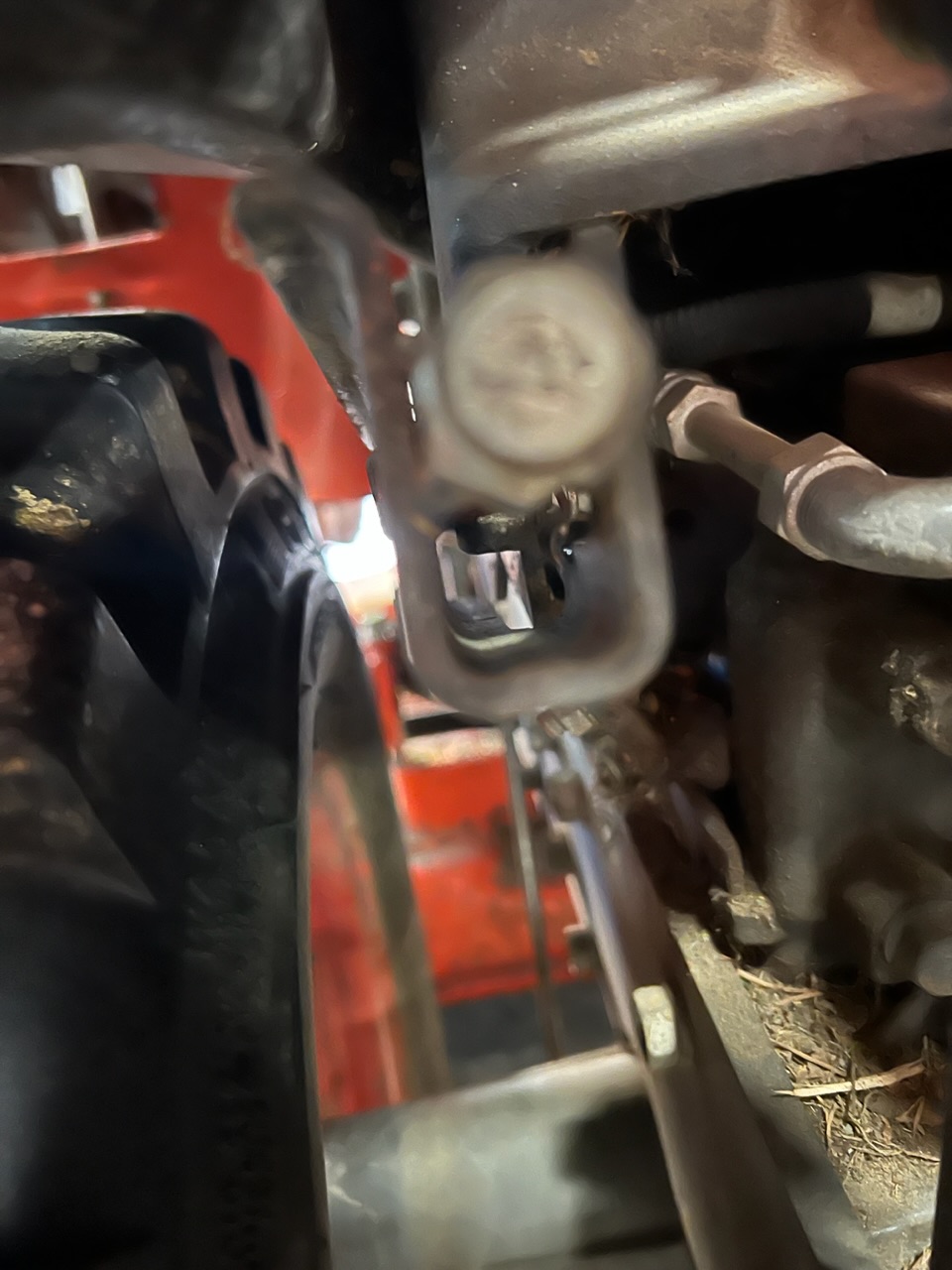

For some reason I can’t get my mower deck to lock in the top position. I just did all the maintenance on the whole tractor. Put the deck back on. Mowed with no issues. It just won’t lock up. Any ideas?

Comes up quite often with BX.

I’m saying I physically can not turn the dial to the “top” setting. 1-4 is fine. I can’t got from 4 to top or from 1 to top. The dial won’t go. The deck is fully lifted when I’m trying to do this.

If you follow the thread I linked above and look at your manual, you should be good.
Although this is an older BX2360, you likely have the same or similar adjuster just inside your left rear wheel.
I had the same issue 10 years ago.

Check your owners manual, I believe there is an adjustment screw that will allow it to reach the Top position. I just can’t recall exactly where it’s locate. Sorry . Maybe Wolfman will drop in and help. Looks like Rcw has it !!

Note there’s also a second “lock” nut there. Tighten that down when done to lock your setting.

Mine 2370-1 doesn't lock in the up either. The strange part is that without the deck on it will lock the arms in the hold position. With the deck on it doesn't because when lifted the deck can't lift any higher because the lift stops on the deck contact the bottom of the frame. I've lived with it all these year. Only thing I could try is to maybe set the leveling screws different this way the arms might go high enough to beable to turn the adjusting screw into the lock. Like I mentioned my lift stops on the deck stop the deck from going any higher.

Yes sir! Thats the fix!
