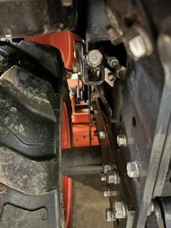

There's an adjustment beside and to the rear of the left rear wheel. The procedure is in your owner's manual and there are several youtube videos that show how and where to make the adjustment.

Thank you! I found it and checked again in the manual. Adjusted it a little and deck height knob now goes to top position!. Still have some learning to do! Wish all a wonderful day! :D

So, Stone1150, I think the adjuster that controls how high the deck travels upward is the one under the seat and inside the left rear wheel. I tried backing it out but it didn't help. Did I go the wrong way? Is there another adjustment somewhere else? Your help or anyone else's is appreciated.

My bx1880 had the same issue brand new. Not sure if it's a factory problem or a dealer set up problem.
The gist of it is that your deck is not being lifted high enough when the lift cylinder hits its max. Because it's too low, some of the weight of the deck is still resting on the adjuster ramp, which makes it very difficult or impossible to turn, or it will not go into the highest setting at all.
The adjuster for this is on the left side, inner wheel well. I set mine so that when fully raised the deck is slightly away from the hard stop on the frame, to keep it from slamming. The knob turns freely now.

No other adjustment that I know of. You probably did go the wrong way, loosen the jam nut and turn the adjuster nut in. You can remove the left rear wheel and use a mirror to see the entire apparatus it will clear things up for you.

I have a BX2680. The 'TOP' position worked fine...until one day I drove the tractor over a 10" or 12" berm at a 45 deg angle and heard a sharp crack. The 'TOP' position was unachievable from that point on. Yesterday I decided to see if I could adjust it out. I was successful but had to replace the jam nut with a .120" washer to get the correct adjustment.
It appears a bracket had moved as there was 1/4" of rust on the frame where a bracket had been when painted but had shifted leaving bare metal. I'm wondering if I had jacked the frame enough on the berm to kick the adjuster off the stepped mower height adjustment wheel, the impact resulted in shifting the bracket 1/4"?
