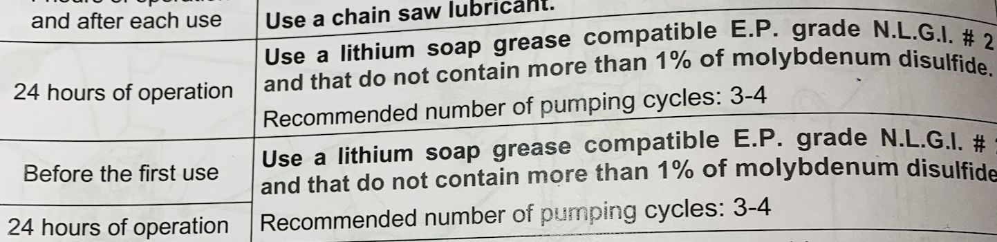

Thanks for the reply, but here is a snapshot from the manual:

My best guess at this point is they don't want me to use a Moly grease for these parts and are using a very odd way of saying it.

OK... I made the mistake of leaping to the conclusion you were discussing your FEL greasing recommendations, since only FEL is suitable for Moly grease.
And THAT is the issue here: Moly grease is suitable for pins, etc.... not bearings or most other points because the Moly is so anti-friction the rollers will slide and be damaged rather than rotate.
Sooo... it appears they are simply warning you to avoid Moly type greases in that particular application. (Sorry for the earlier “leap”.)

re: not bearings or most other points because the Moly is so anti-friction the rollers will slide and be damaged rather than rotate.
hmm.. wonder what 'Moly ' they put in trannies for the past 50+ years.... ?

These are snowblower parts, so different temp and application expectations. I don’t remember what manual for mine says, will look when I go out in barn later.

So moly is ok for my FEL and backhoe, but I should not use it on my mid PTO driveshaft on my front mount snowblower?

From Nitroonline (a lubricants company): http://www.nitronine.com/different-types-grease-uses/
Greases containing molybdenum disulfide as an additive are used in many heavy-duty, load-bearing, demanding situations such as in construction equipment, railways, farm machinery, etc. Specific everyday uses for molybdenum grease include:
  • CV joints
  • Ball joints
  • Steering linkages
  • Pivot pins
  • Kingpins
  • Worm and helical gears
  • Splines
  • Pinion gears
As well as just about any other heavily-loaded, low-speed application. It is also serves as a good multi-purpose grease. Its exceptional ability to reduce friction, however, makes it unsuitable for high-speed bearings (such as needle or roller bearings), as the rollers/needles need a small amount of friction in order to rotate a full 360° and perform as they should. Otherwise, they develop flat areas along the length of the rollers/needles and eventually stop rotating, thereby reducing the bearing's performance and resulting in a sooner than expected replacement.

So do I need to disassemble and clean the moly out of the u joints, or can I just start using the correct type of grease going forward?
