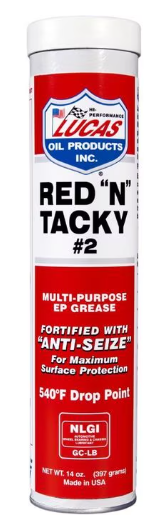

I like this:

@85Hokie for the win!!!!!!!!
I have a "butt load" of greases for some "specialty stuff" but if I was stranded on Gilligans Island and could only pick one grease to have on board the Minnow, it would be the above.

(Blaster Red Extra Tacky or Lucas Red and Tacky…whichever I can find in a full case.)

Red and Sticky,, I figure if its good enough for multi million dollar mining machines its good enough for my little orange tractors

Red N Tacky for the win in my shop!

So a Lithium based grease containing Molybdenum disulfide and designated Extreme Pressure? Looks like one of the Lucas products covers that.
