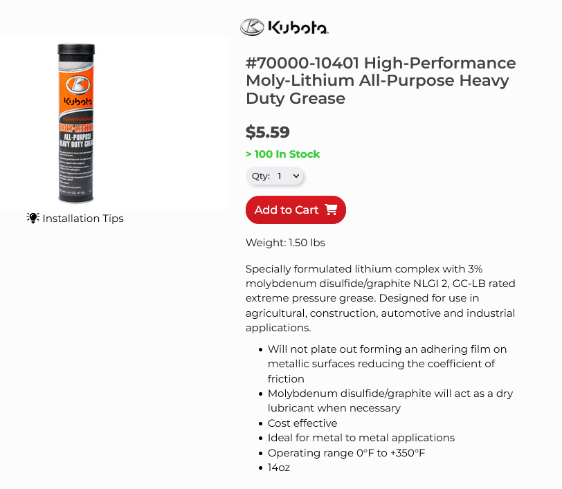

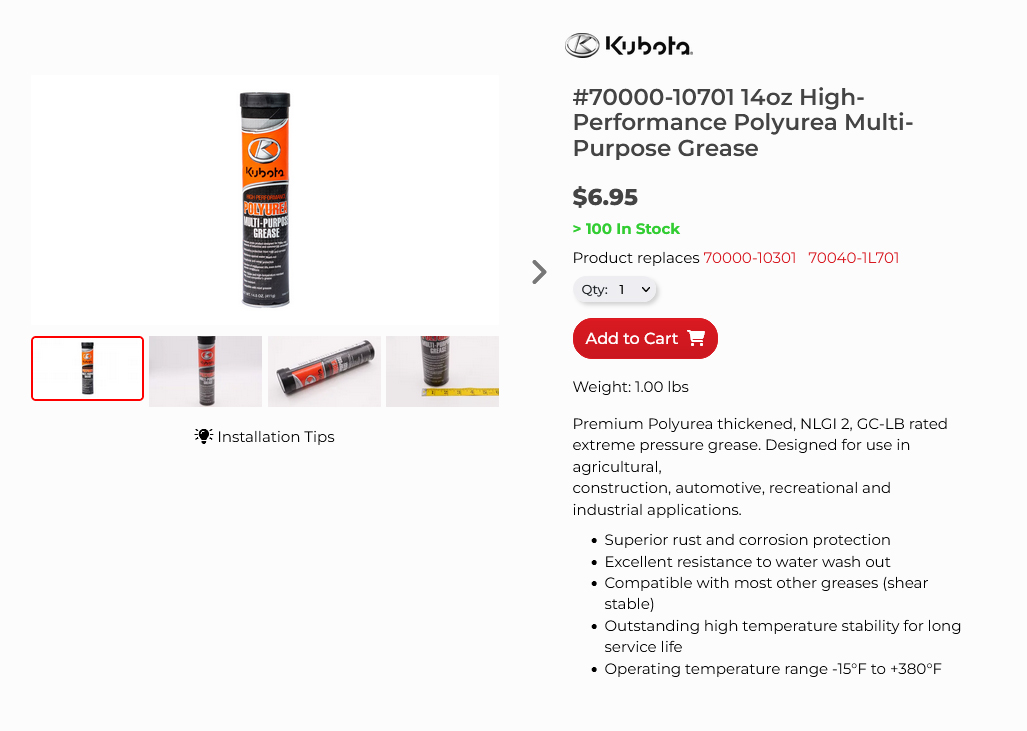

Both owner's manuals for my tractors only list one grease since the loader is an option. I buy these two products from the local Kubota dealer. I have four grease guns with the DeWalt and Kubota branded grease guns for the tractors and implements, another for the boat, and another for the Jeep, F250 and trailers.
Would it be great to only need one grease for everything .... heck yeah!

Since the manuals call for a lithium based grease for most things but a molybdenum based EP grease for the front loader arms doesn't that mean I need at least 2 different types of grease?
Forgive me for asking so many questions but I'm trying to learn from you experts here.
Thanks.
EDIT: I misspoke. It says containing molybdenum disulfide not 'based'. It also should say Extreme Pressure like 'Moly EP'. Perhaps one grease will cover everything.
So a Lithium based grease containing Molybdenum disulfide and designated Extreme Pressure? Looks like one of the Lucas products covers that.
Thanks guys!
"Moly" greases are lithium complex (lithium soap" greases. The difference is that your general purpose/ bearing greases do not contain as much molybdenum as a "moly grease". A high molybdenum content is not recommended for ball/ roller bearings but it will generally work fine. I would not use it in needle bearings. Lithium complex is better in the rolling (bearing) application. Moly is by far the better choice for sliding surface applications.
Polyurea is a good bearing grease, but don't mix it with lithium soap greases. I would not recommend it for sliding surface (loader) lubrication.
Will one grease work for everything on your tractor? Yes. Will having two greases work better? IMHO, yes.

That was a very good video and Wes clearly knows his stuff and does a great job of presenting the information. I'm going to continue to use the Kubota moly-lithium (dark grey) on the loaders and Kubota polyurea (green) on the tractors.
