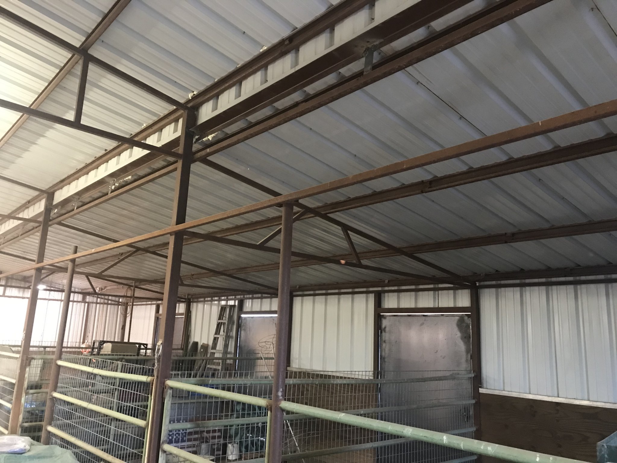

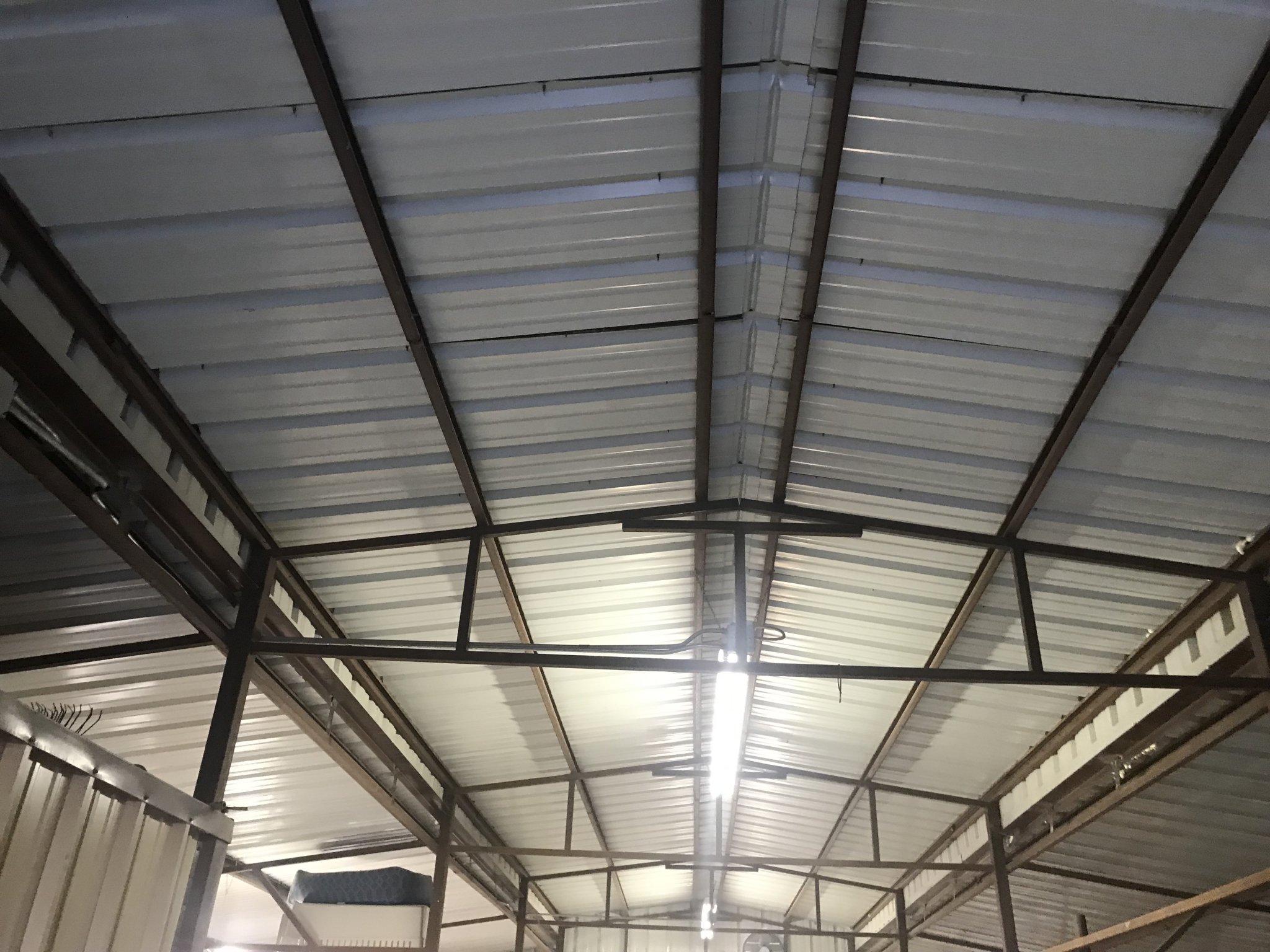

That would be very much appreciated and I agree that 10' would be a good height from the floor to the underside of the trusses.
I got home early today and snapped some photos.
jyoutz
Jan 14, 2019
3,447
2,532
Edgewood, New Mexico
The barn has also handled 38” snows with no issues.
One last thing. The square tubes that the frame is constructed from looks small, but the walls are 1/4” thick. They are stout.

I am confident that mine would also survive those conditions. He welded frame never creaks or moves.
One of the problems with the barn that collopsed is that the side facing the wind was a flat 15'x40' wall. I want a symmetric pitched roof to reduce the wind load.

You’re welcome. When I bought the place, I thought that the span distance between the trusses would be a problem. But 17 years later it has withstood high winds and 3+ feet of snow without any damage. I think the thick walled tubing and purlins provide the strength needed to withstand these events. I have been working inside with 60+ mph winds and have never heard the structure creak. Welding the structure together instead of bolting makes everything rigid.

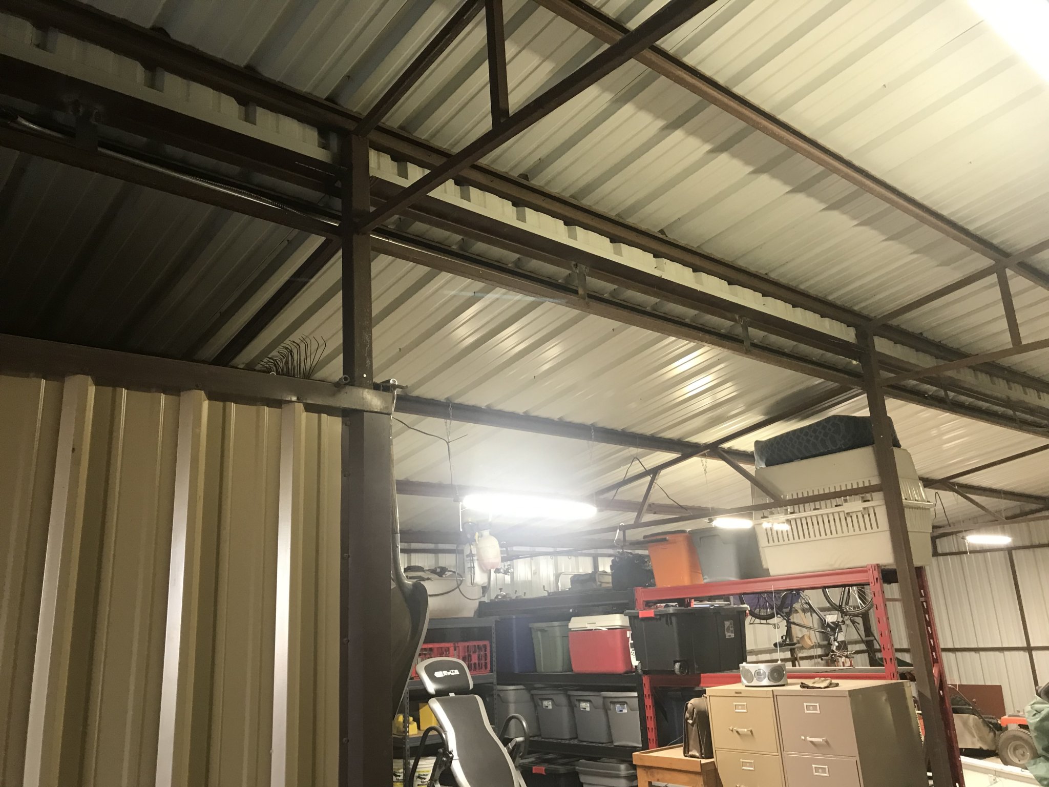

Are those flourescent bulbs?
I just changed my 34 four footers, and 24 eight footers to LED.
Much lower cost to operate, and much longer life.
No need to replace fixtures, just rewire to bypass ballast.

Yes they are. I’m going to look into doing that when my current box of bulbs is used up.

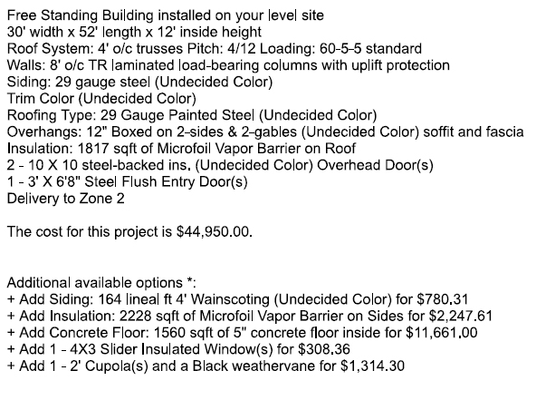

I've started to get some prices on a new structure and I think it might be helpful for others if I share some pricing in this thread. I'll update the table below as the months go by but I'm hoping to have this structure completed before the summer, ideally long before.
I plan on doing a lot of the work myself with the exception of the concrete. My neighbor is a contractor and he's going to give me a quote on the concrete work. He's currently building another shop on his property that's 40'x40' and it's going to be really nice. My metal "shed" isn't going to be that fancy. Just a steel framed structure with sheet metal on the roof and walls, a couple of roll up doors (garage doors), one standard 36" access door, no windows and some basic wiring (220V already at the site) for power, lights, etc. I do want to make it such that it could be incrementally improved such as adding interior siding, heat, water, etc., so that I could turn it into more than just a metal storage shed.
The trusses would cost about $6,000 for delivery from NC to MT so I'm looking at buying the material and making them myself as well as possibly driving to/from to pick them up. I'm sure I could drive there and back for a lot less than $6,000. I have a 22ft flatbed trailer and the trusses are about 15' long so not a big problem.

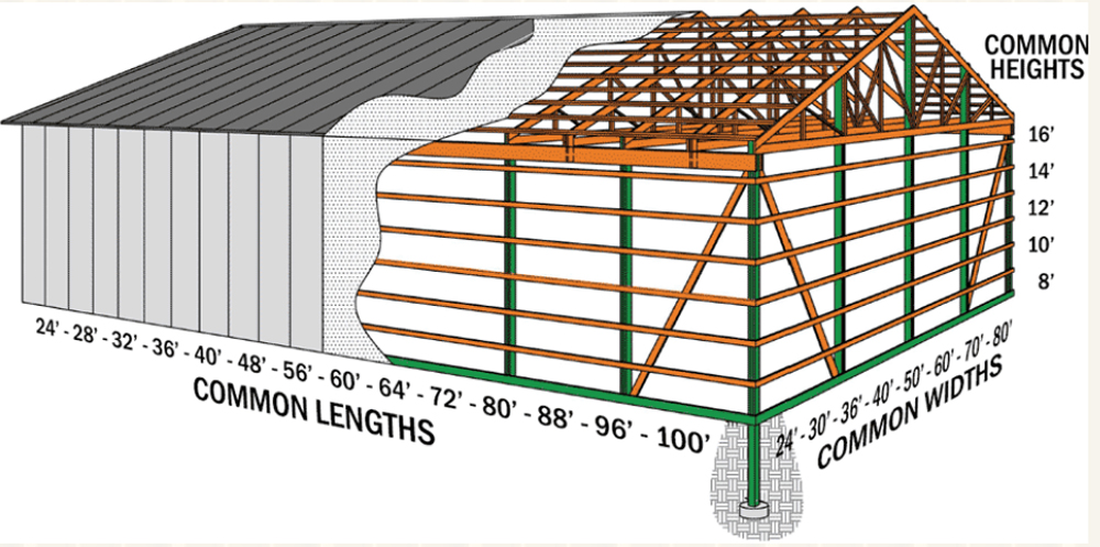

As a sanity check I got a quote from a "local" company for a post frame structure. This quote is for a turnkey building. The columns are set in the ground 40" and they sit on concrete donuts and the holes are back-filled with dirt. If I want a 5" thick slab poured the total price would be $56,611.
I did post frame with post protectors for termite peace of mind and it's been up for two years with no issues. We have mostly south wind 60-80mph not counting tornadoes. The roof is opposite north/south so the wind can't peel the panels back (happened to a neighbor).
I did 6" floating slab, spray foam, all 26 gauge metal. Most steel buildings use 26 but it's because the supports are further apart.
Trusses 5' on center with posts every 10'. 5x5 solid posts that still have good chemical treatment.
I did wood because I can staple Romex to the walls. Steel is better but I don't buy the "wood burns" arguement- a steel building won't survive a hot fire any better than a wood building.
I am surrounded by post frame and steel suppliers so we had plenty of options. Steel was almost 50% more at the time. If you want any pictures or details message me.

Sounds like a very nice building. I think I'm going to stick with a steel frame structure but not sure yet which direction I'm going in. Once my neighbor provides a quote for the concrete work I'll have a better idea. Structures up here need to be designed to withstand a 60lb/sq.ft. snow load and I don't think the trusses mentioned in the table above will do that set 10ft apart. I've got more research to do. At least I know that the columns are good to go in terms of compression and buckling.

The snow and heavy wind is not something we deal with here. The main advantage of post frame is you don't have to put a floor in which is why they make great haybarns.
