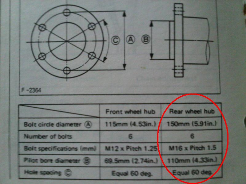

Considering buying custom made rear wheel spacers for the B2150hst 4wd and need the wheel specs. Their is a shop that makes custom spacers for a lot less then the companies typically mentioned using the same materials.
I know the bolt spacing is 6 inches, 6 x 152.4mm. Where can I find the center bore size and stud thread pitch.

Yes, Im thinking 2 inch would be good as this B2150 has the wider offset wheels and 12.4 x 16 tires making a 63" width.
These are B8200 specs that uses the same axle/hub assy as the B2150. Will verify on the tractor.
