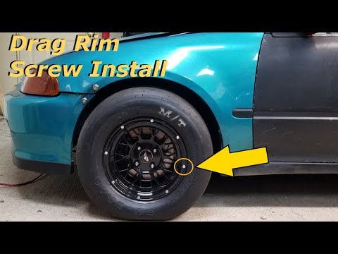

Do with this info what you wish. If it was mine I would use these long before tossing or tubing a tire. Common practice in budget drag racing for ages, or where bead locks aren’t allowed.

I believe I’ve seen pictures of using some kind of screws in holes drilled the edge of rims on off road vehicles, to keep tires from slipping on the rims when low pressure is used to increase traction.
Wonder if this could be applied to a tractor tire when an issue appears like the OP has? Maybe not the best solution, but might be the easiest.
