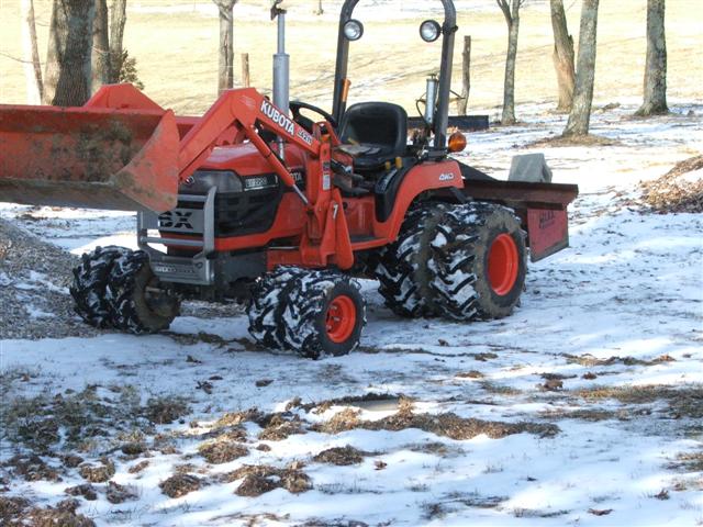

BX Kubotas are tippy little things, the wheel stance is too narrow and they WILL go over on hills. I had a BX2000 with backhoe (you won't keep that on except when using it) and it got so bad that I put a tilt meter on the dash and knew to be careful on my hills. But even if in the range of the tiltmeter, if the downhill front tire hits a rut - you're going over. The solution is to get a bigger tractor with a wider stance. My new Kubota (waiting on the subframe backhoe part to be produced) is a B series which is somewhat wider. The other option if you want to stay with a BX is to go dual wheels, there are kits. Now you traverse most any reasonable hill with a much higher degree of confidence. It's no fun when they go over....

This is actually not true in my experience. MY BX2200 with foam filled tires and the MMM on is VERY stable on side slopes, much, much better than my B2910 which also has four loaded tires.
Below is a link to a related thread, with a picture in post #1 showing where I start to feel uncomfortable, but reality is the tractor is still well under its actual tipping angle. Rock solid if I get off ( on the up hill side) and push on the ROPS as a test.
The MMM being so low adds a great amount of side slope stability to the BX.

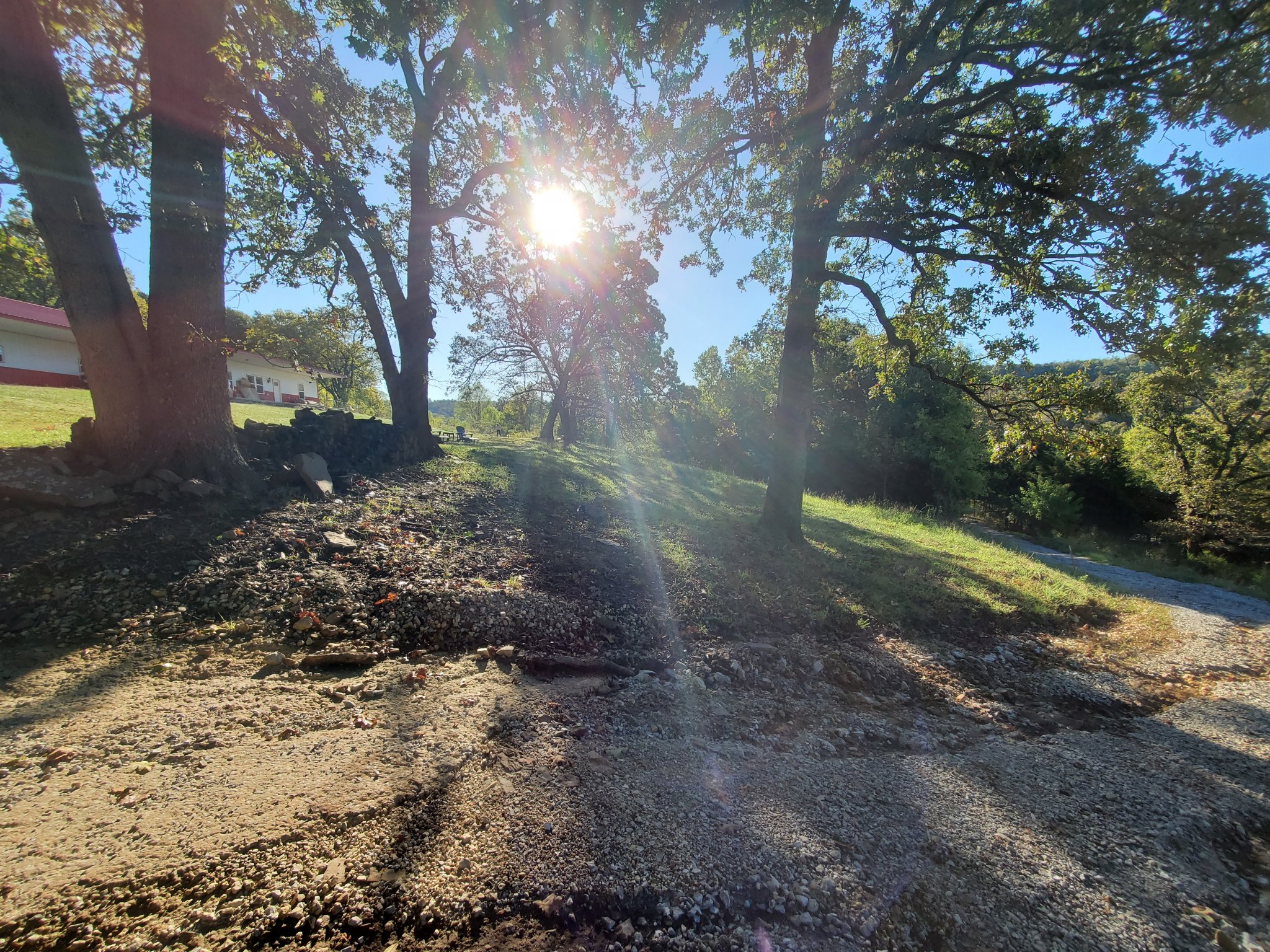

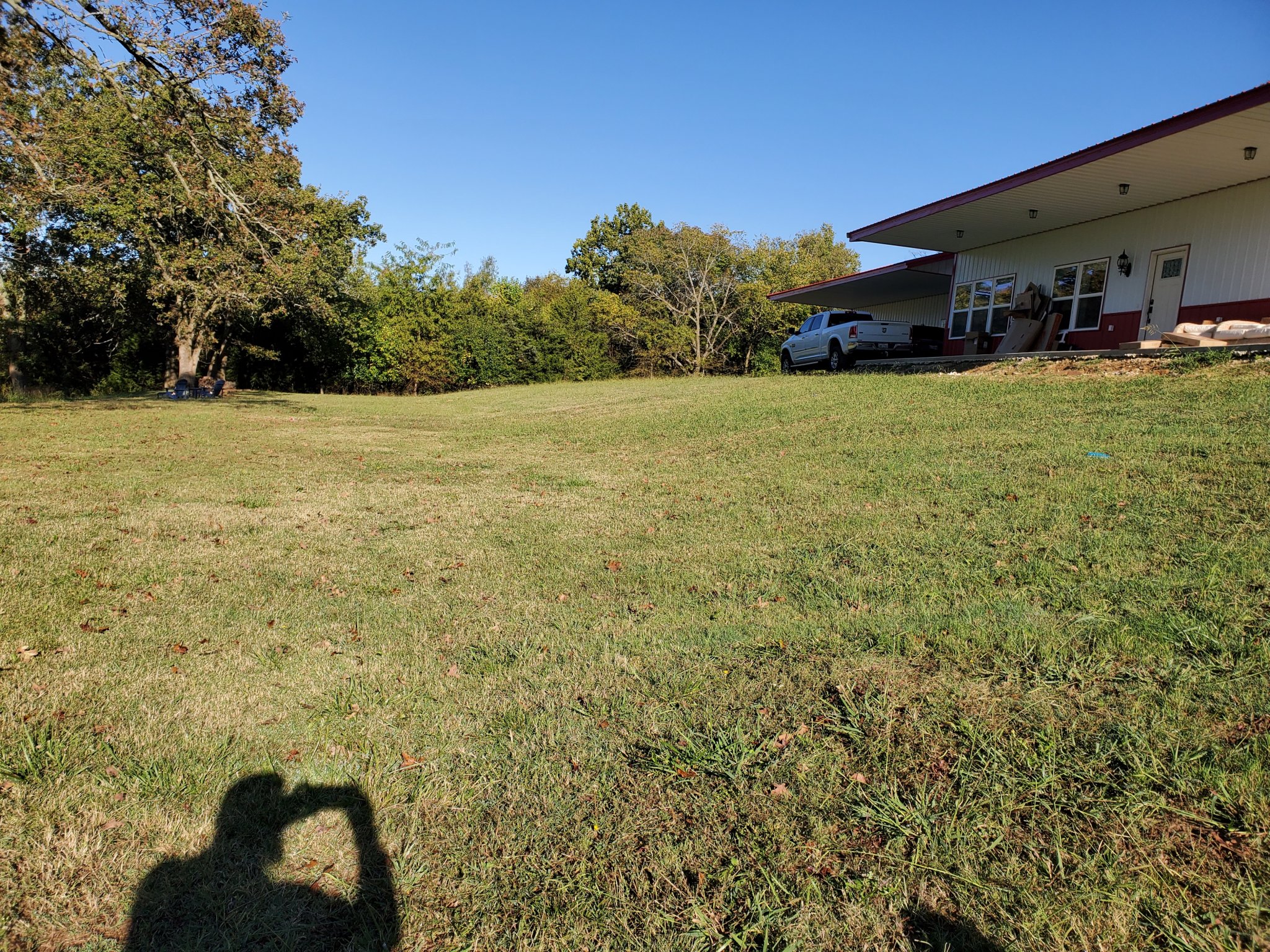

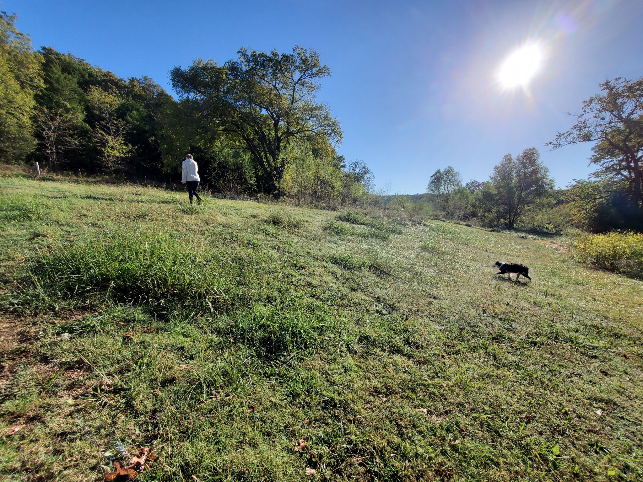

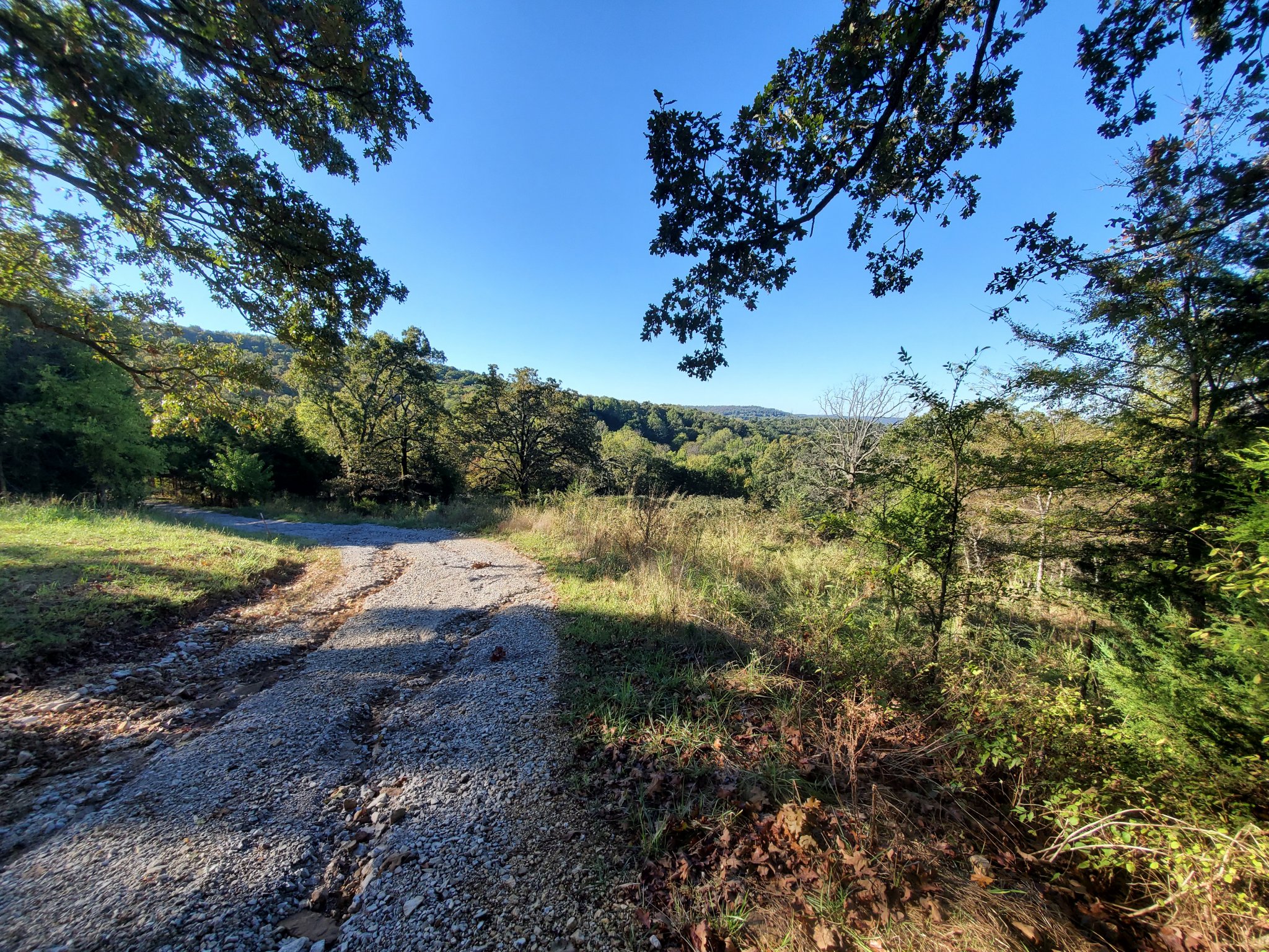

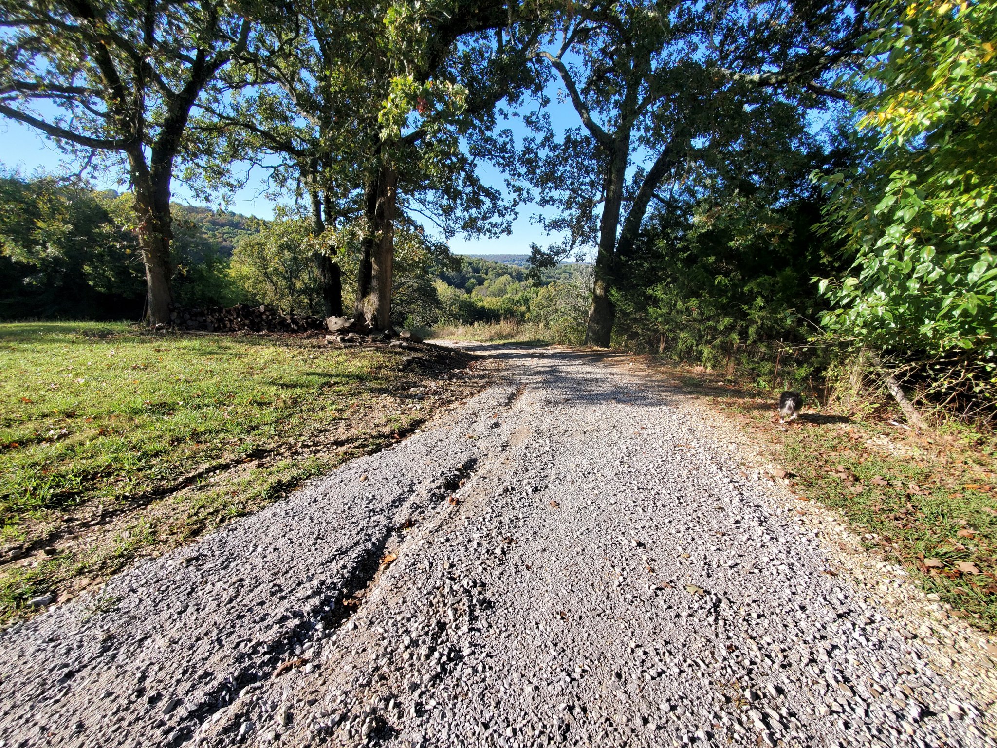

I have 11 acres. Though only about an acre of grass. I want to be able to maintain my driveway and clear out some of the brush in some of my lower section that you can see off to the right of the driveway. And other areas not shown.
Also went to my local dealer and they didn't even up having the lx but they do have an l2501.

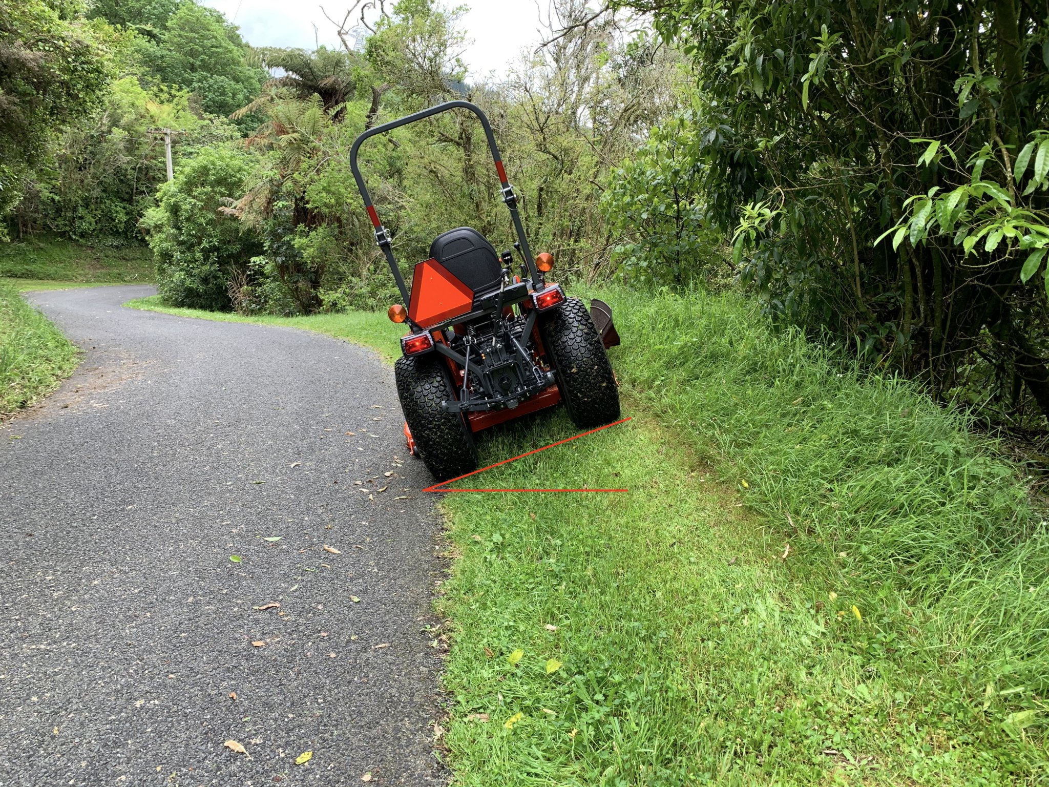

Photos are always deceptive, but I don't see anything in those photos that I wouldn't drive my B2601 on, or that I wouldn't have driven my old BX on. Definitely looks fine up and down, and most of what I see probably fine side to side as well.
This photo, for example, doesn't look that steep, but is about 15 degrees. I mow that every few weeks. It feels uncomfortable, but the tractor is pretty stable. I wouldn't do it fast, because if you hit a bump you might go over. But slowly, it's fine. And up and down that slope would be no drama at all.

Photos can be deceiving, but I didn't see anything there that I'd feel unsafe riding around with my BH on. So with no BH, mowing shouldn't be a problem if done properly. In that situation, I would go for the LX. With 11 acres you'll benefit from the bigger tractor more than you might think.

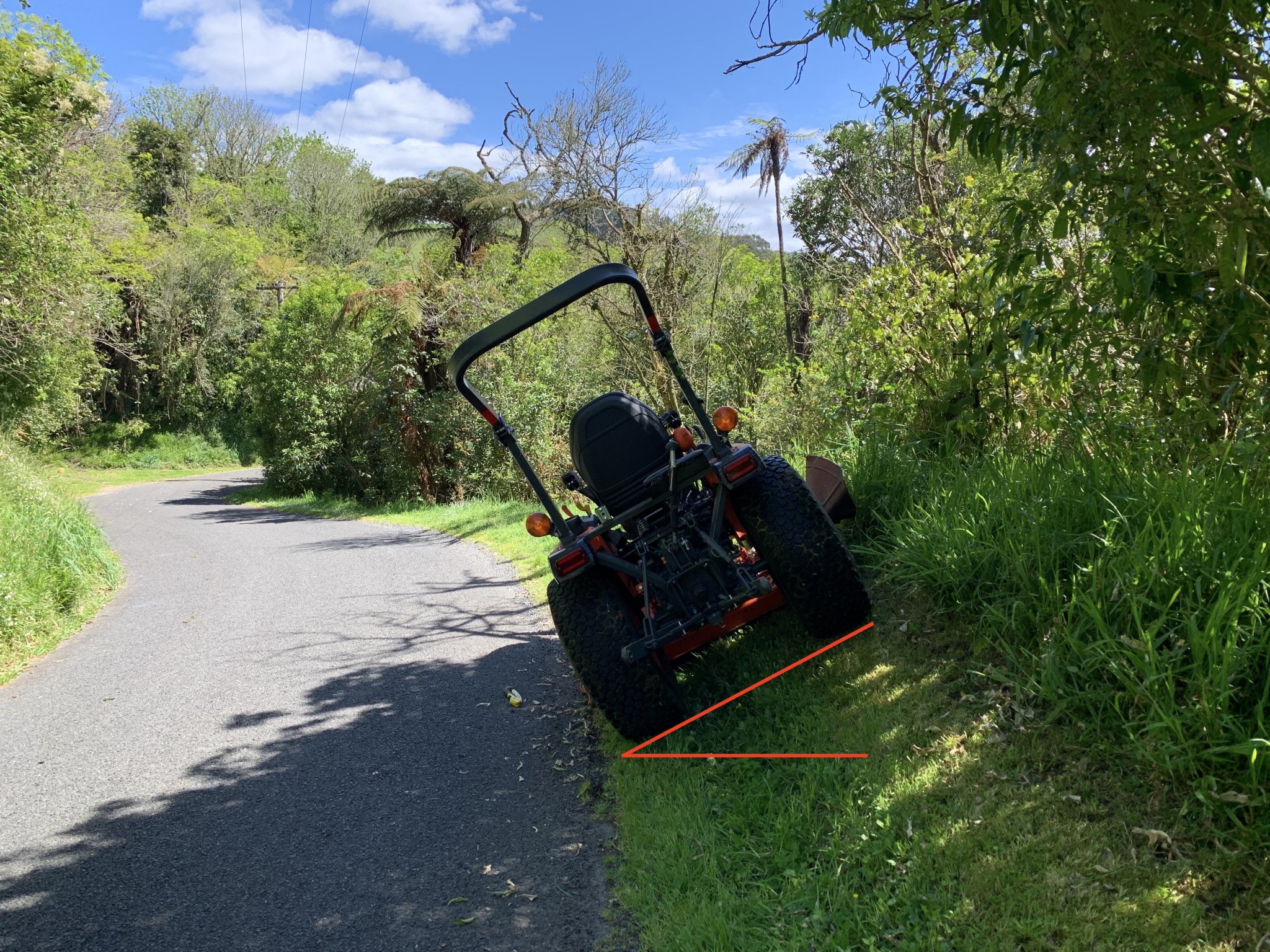

I mowed this again today. And thought I'd stop and measure. Phone claims it's 30 degrees, which matches the seat of the pants feel better. Steep, I wouldn't go much steeper, but the tractor seems stable when I get off and rock it.
