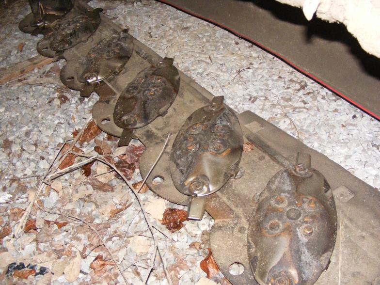

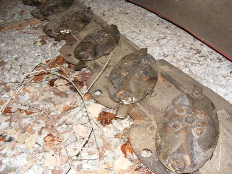

If protection during storage is what you want I suggest Amsoil Heavy Duty Metal Protector. It's as simple as spray on and let dry. Only takes a few minutes after you apply and it ready till you need it the next time.
I took these pics this afternoon of the cutter bar on my disc mower and the inside of my baler (bale chamber) so you can see the results for yourself. They are stored in a shed but it's only closed on 3 sides. I sprayed them down when I got thru baling hay last year. This may not be a factor on your blower but after the MP dries it's like a wax and doesn't attract dust.
It may not be what you're looking for but it works great for my needs.
