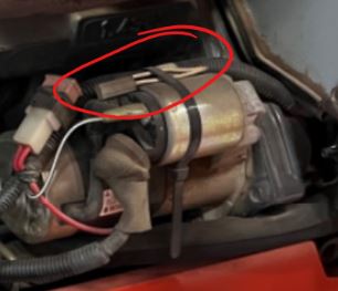

I recently replaced the starter motor on my B2630. Attached is a photo of the old one. There was a wire with a connector on the end attached to one of the terminals on the starter. I thought maybe the original owner had placed it there for something but the replacement motor had the same white wire/connector in the same place. Anyone know what it's for?

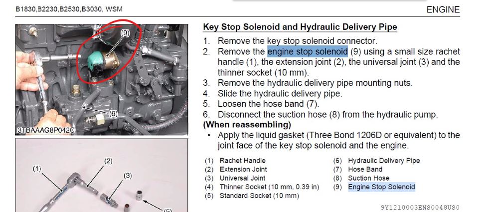

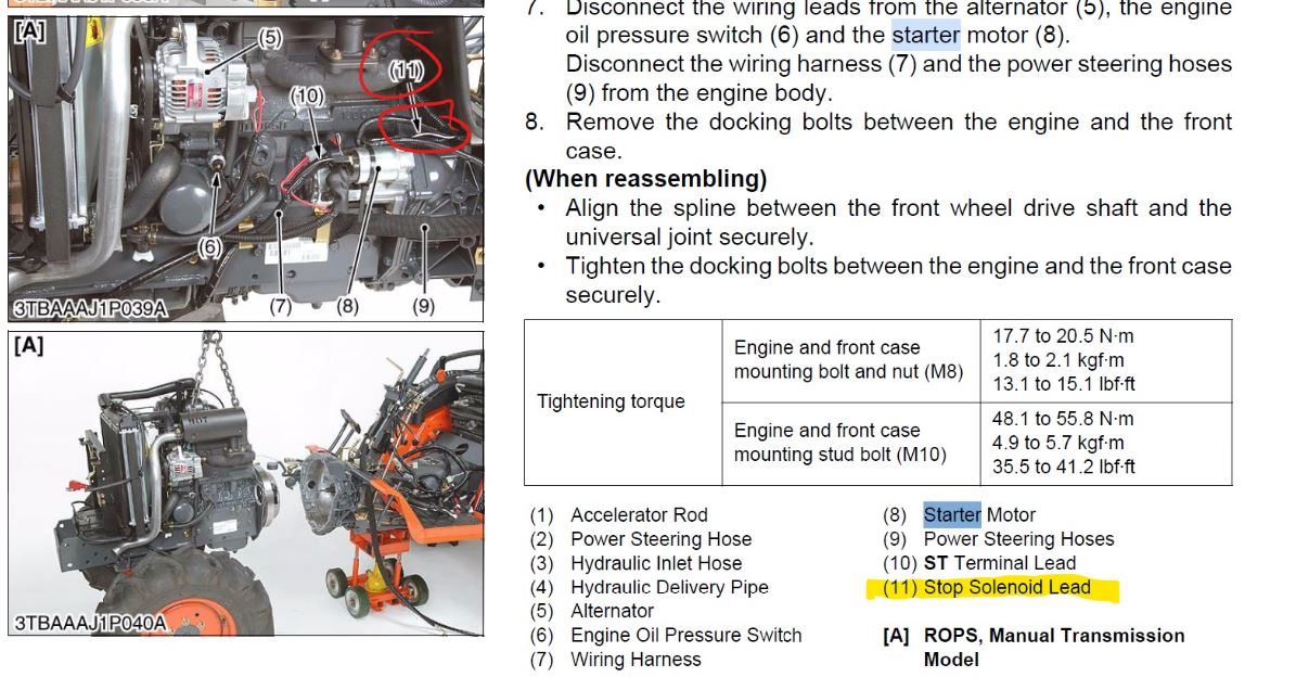

Looking at the WSM for my tractor, the white wire lead is called the "Stop Solenoid Lead".
The image below is from the WSM page 1-S38.
Under "Troubleshooting Engine won't start...
Here's what I found on the "Engine Stop Solenoid"...
YouTube on the Stop Engine Solenoid...Video

The solenoid looks like this...
It's from the video link of an "L" tractor. watch the video, he says you can remove it and start the tractor. Go to 2:45 in the video.

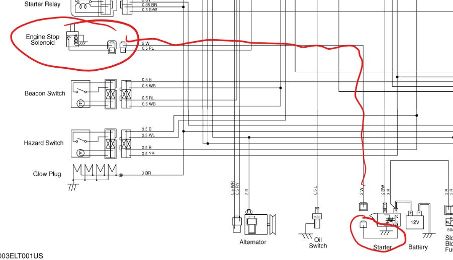

Does it shut off when you turn the key off? If so, I wouldn't be concerned with it. Be aware that Kubota has used several stop solenoid schemes over the years, so yours may not function like someone else's. You'll need the schematic for your specific model to trace it.
whitetiger
Nov 20, 2011
2,604
1,116
Kansas City, KS
That wire is only used on the models with the 3-wire fuel shut-off solenoid. It supplies the power for the PULL circuit. Just tie it up out of the way.
That explains why mine is the way it is.
28,772
5,162
Zip tie the wire to the starter, out of the way, and move on.
You don't need it.
