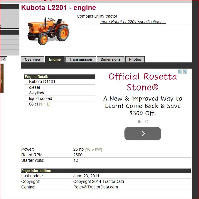

Mike,
The CC's and the cylinder count put together tell the size and type of the engine, the version # comes from the age or a good guess.
First it's a 3 Cylinder that tells me it is a D motor.
Second the CC's 1115 crosses to a 1101 Model # .

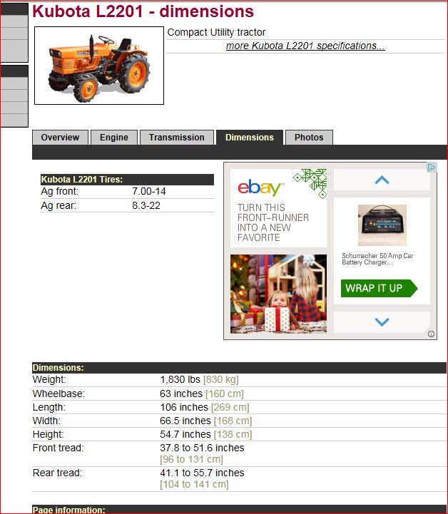

for my opinion you have a l2201 kubota, i see that your hood is longer than my l1501,
and i think that its an l2201 or the half of it, we have a lot of them here in Greece.
as for the transmission is the same as my l1501 and it bolts right in place,
so you may have 2 tractors bolt together, because the 1501 and 1801 and 2201 use the exactly rear end with only different engines, everything is the same in the transmission, steering column, hydraulic pump, etc...
look for example at this photo here,
this part is the same to this 3 models.
so if you re-power your kubota put and some new stickers with the l2201 on it.

Hi Alexisferos - or Daren Todd. If someone can measure the length of the hood on an L1501 we might be able to confirm Alexisferos' theory. It certainly sounds reasonable, particularly if everything back from the engine is the same
39 3/4 inches or 1.009 meters, 100.965 centimeters.
Measured center of hood from where it juts out by the lights to the seam at the end by the dash
